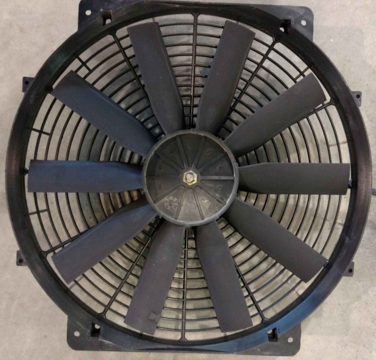

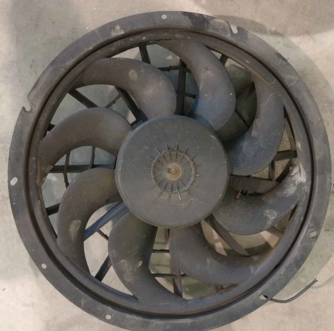

All fans measure approximately 15 1/2”, some pictures for reference,
16” Spal fan 2200 CFM
16” Flex–A–lite fan 2500 CFM
Late Volvo post 97 High 3349/ Low 2695 CFM
