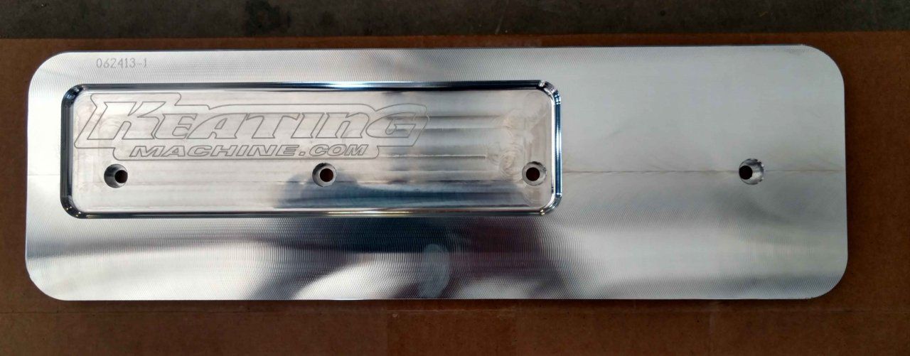

I ordered a Keating tappet cover to hopefully cure my last oil leak, these guys sure do build a nice part.
Front,

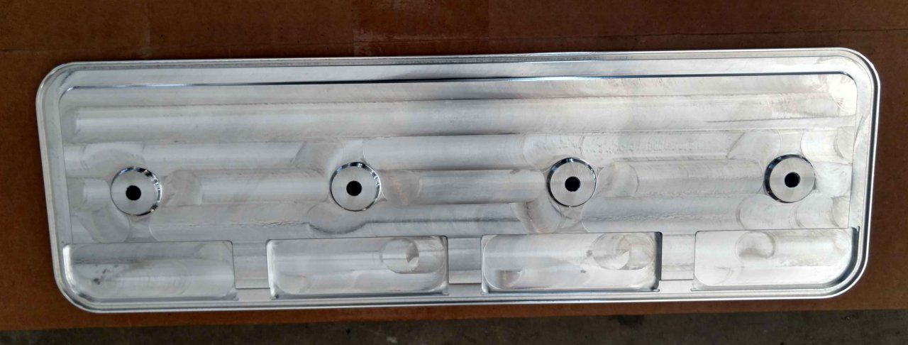

Back,
I’ll get it Cerakoted and try to make some time to get it installed hopefully in the next month or two, I’m buried with real work and I need to remove the P-pump to replace this cover so it’s a job I’m not looking forward to.
Wow, that thing is gorgeous. It looks like it might reduce a little engine noise too. I know in the 6bt engine cycle they started to insulate that piece to help with some of the engine noise so a little more meat on that side cover could help. Probably not tons but perhaps something.
