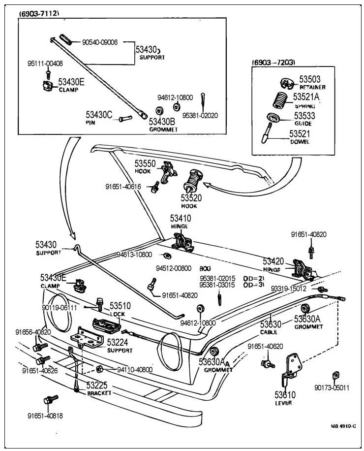

Nothing on the exploded diagram...

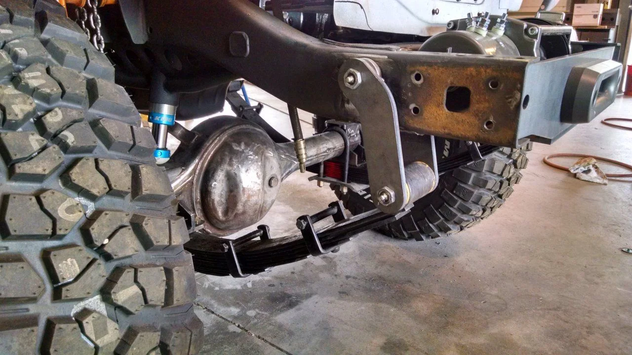

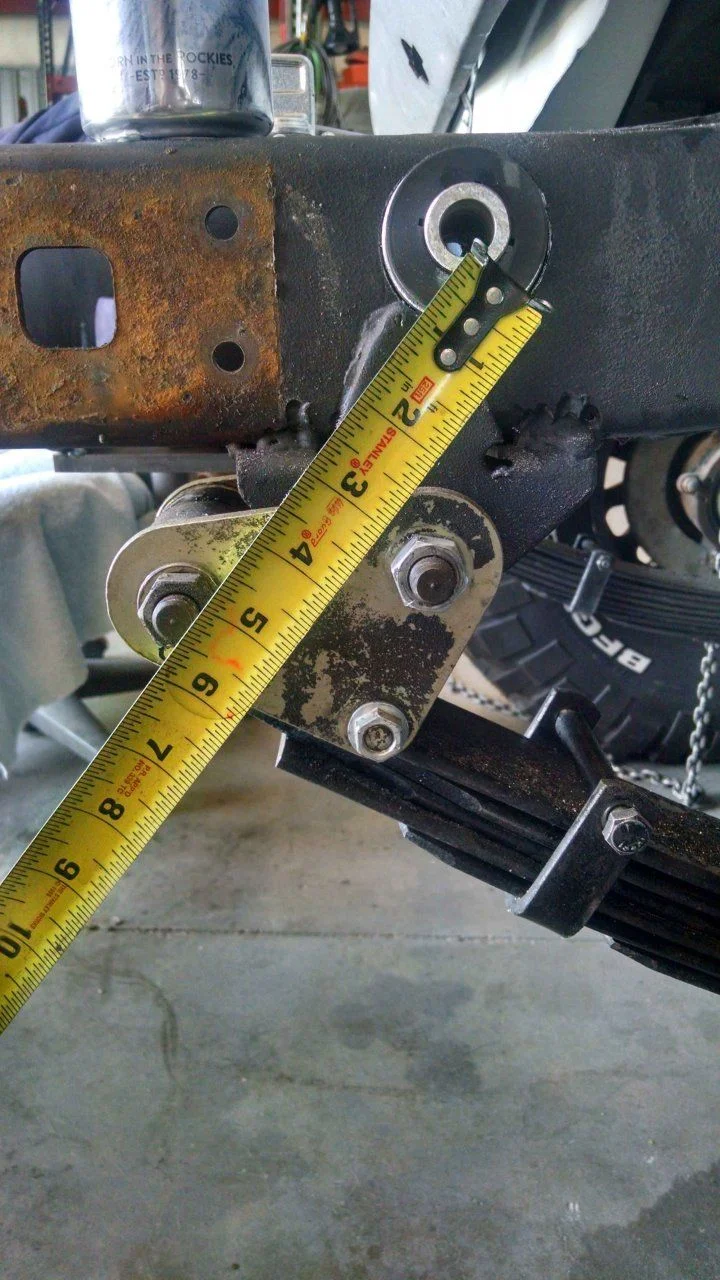

This shows the new pivot location, I’ll make 6” boomerang shackles to clear the cross member that will also raise the front of my springs 1” at the same time. As you can see in the picture I have 3.25” shackles now and I was hoping the 3.75” shackles I have on the rear would cure my inversion issue but no luck, if I go any longer and keep the factory hanger I lose caster on top of having low hanging shackles. My desire to keep the pig with factory looking suspension is giving way to my desire to having working suspension.

This shows the suspension collapsed down to the bump stops and the 3.25” shackle almost inverted and the angle of the new 6” shackle at about a 45° angle.

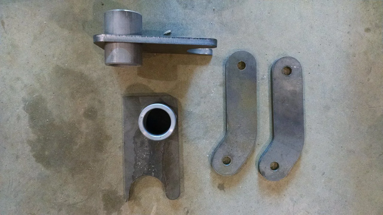

Picture of the internal frame gusset, new bushing tubes and shackles, I needed to make boomerang shackles to clear the factory cross member.
In a perfect world I would have been able to move the bushings back another ½” but reinforcing the cross member after removing that much was going to be a challenge at this point in my build so I settled for a happy medium. I’m -7 degrees at full extension and 43 degrees at full compression. Everything is just tacked in place for now and I’ll clean up the frame and finish welding before I reinstall the front sheet metal.
