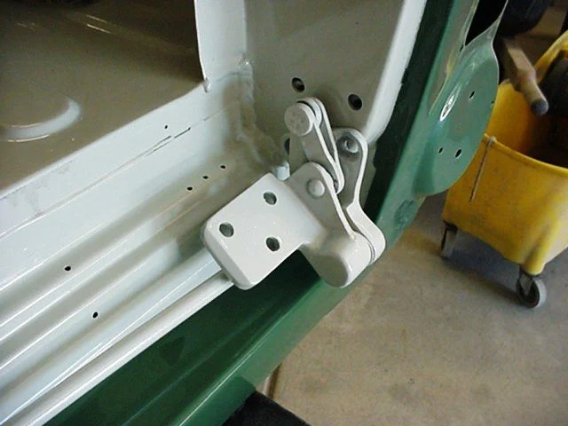

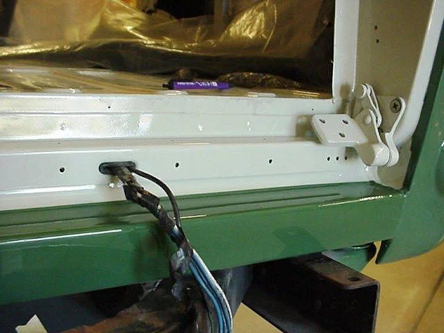

I striped the pig down to the bones today and the tailgate rusted bolts kick my ass, my question is how do you reassemble to torsion bar hinge side when you put it back together? :bang:

Keep the faith bro, I have some pics from the FSM I can load. It is a process which tries the patience... I think I may have a few pics of the reassembly in my POTM thread.

Taking apart the tailgate lift mechanism was a particular PITA. I took picture of just about everything I took apart, but a lot of these are pretty boring. The tailgate lift mechanism has a special place in my heart because it was so frustrating to take apart and put back together.
The only way to do this is by the book. I don't remember if I scanned pages from the FSM on taking this apart. I can look if anyone wants/needs these pages.

You bet man. I forgot that MUD made all my photo attachments little thumbnails. I am fixing them now, but here are the relevant pages... Pay attention when they talk about removing the one bottom screw from the hinge where the torsion rod attaches.
See how in the bottom picture they are levering the torsion bar out, so they can get the block of wood behind it? Once you get the torsion rod blocked away from the body you can begin to affix the hinge to the body and tailgate.

Here are my posts related to getting that torsion assembly back on:

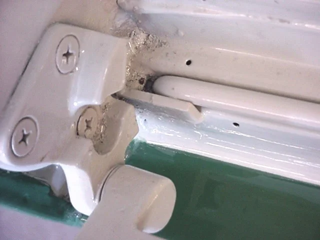

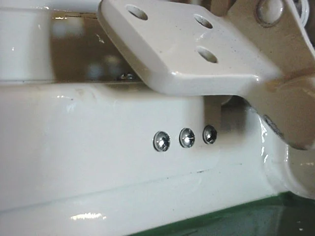

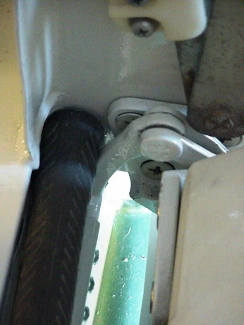

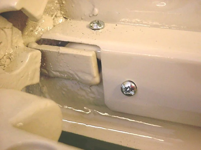

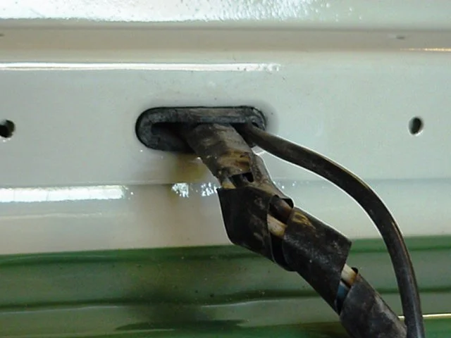

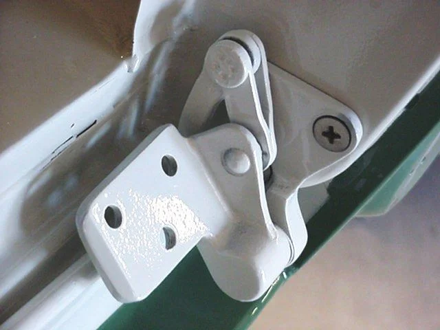

We had some major things left to accomplish. Have you ever thought about painting a line down the side of a vehicle with multiple panels? It would be pretty risky to paint that line while all the panels are off the vehicle. A better way is to put all the panels back on the vehicle, and then start laying out your paint break line. This meant we had to get that tailgate lift mechanism back in. She did not disappoint! She was just as fun going back in as she was coming off. I tried to take some pictures showing how we got it all back together. I think at a certain point the logic failed and dumb luck prevailed.
View attachment 875915 View attachment 875916 View attachment 875917 View attachment 875919 View attachment 875920
A few more shots of simply getting the cover for that torsion rod back on. And then the fun would start when we went to secure the hinges to the tailgate.
Like my replacement gaskets to go between the body and hinges? Glad we found a use for some of those gloves...
View attachment 875923 View attachment 875924 View attachment 875925 View attachment 875927
This is where it gets real when you try to fasten the PS hinge to the tailgate. That torsion rod has a mind to help you lift that tailgate. but you have to have the rod and hinge secured to the body first. Thus the guidance in the FSM to use a block of wood to block the hinge more towards the down position so you an start the fasteners. We used the handle of a shop hammer. I replaced the tailgate fasteners.
View attachment 875928 View attachment 875929 View attachment 875932 View attachment 875933 View attachment 875935
