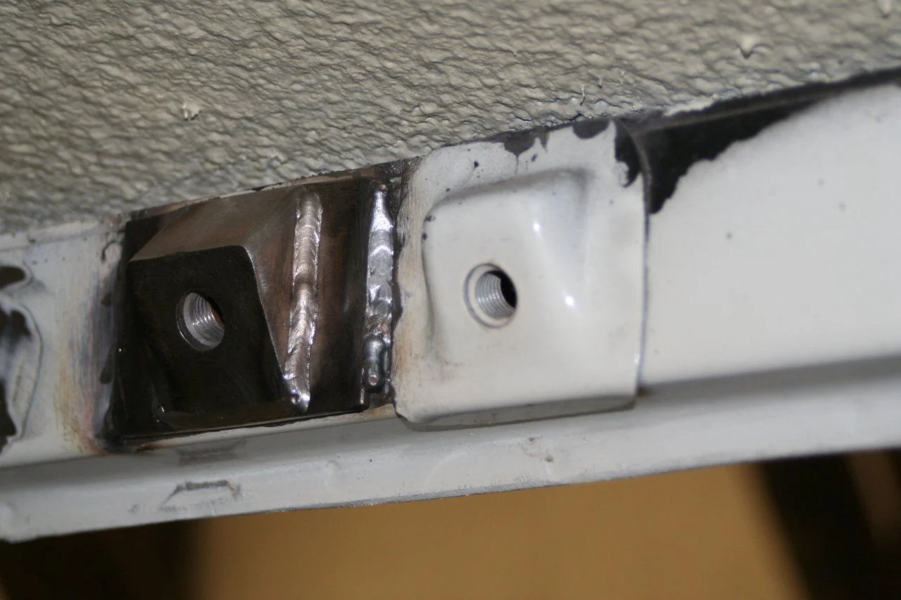

I need to cobble a roof rack together for an upcoming trip and I’m not wanting to mount to the gutters.
Have any you guys come up with something like a minivan roof rack mounting system for the old pig?
I was thinking about an interior structure welded to the top side were the seat belt shoulder mounts went then using structural adhesive to bond some mounts to the underside of the roof with sealed nutserts and bolting the rack from the top much like the modern cars, trucks and vans do it.
Is this a bad idea?

So, it would have two roof supports inside, that the rack would bolt to, using the seatbelt mounts as the anchors. I would be worried about over loading it and getting a water leak. I'm sure it could be done and not leak, it would pain me to drill into a nice roof, though. Are you keeping the headliner?

Yes basically I would have some ¼” plate burned out to make six to eight interior pads that would have legs welded down to the heavy structure where the shoulder harness was bolted, the pads themselves would be bonded to the roof skin with a structural adhesive that would make them a permanent mounting point without inducing cracks to the thin skin from welding. This would all fit between the roof skin and headliner and all the metal I’m looking at inside my pig is way more suitable to hold the weight of a rack then my gutters.
I’ve been studying my wife’s rack on her Volvo minivan and it’s bolted from the top through the roof skin and I like to low profile this system allows you to do.
I agree this could be a terrible idea but at this point I’m not sure why.
It's sounding better, but I'm confused with the 6 to 8 pads. Only 4 seatbelt mounts or do you mean, just welding the pad legs to that general area, similar to what I did.
Yes just welding to the general area.
