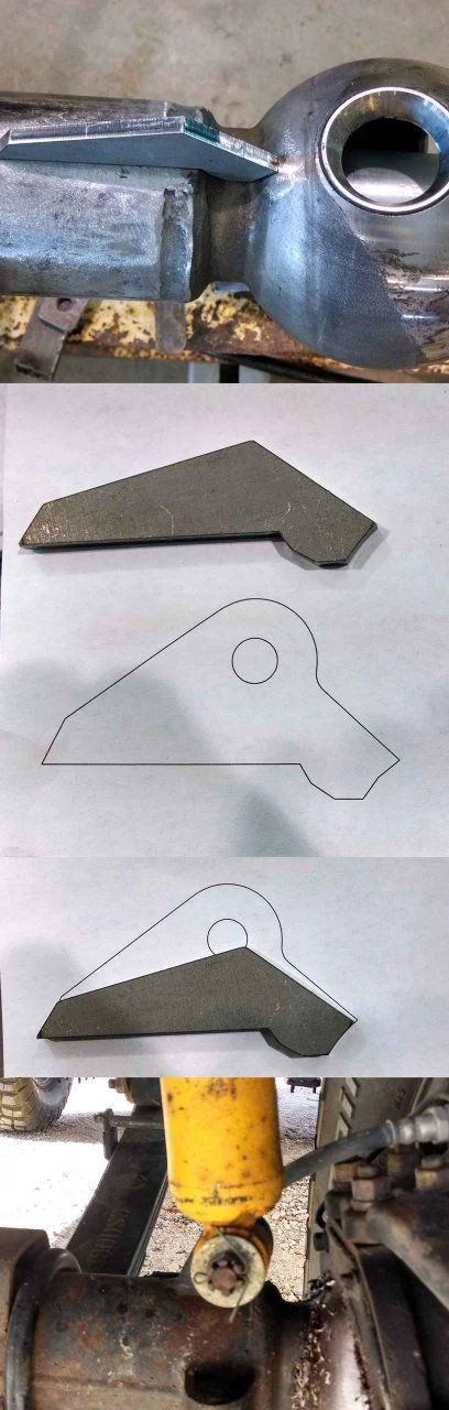

I bought some Ruff Stuff Toyota knuckle gussets and looking at my FJ 55 front end my current shock mounts occupy the same realestate as these new gussets.
I’m thinking of having some gusset/shock mount made and I’m not sure if it’s a good or bad idea, I think there has to be a reason I can’t find anyone currently making these for sale.
Can anyone see a reason these will not work?
I'm guessing you'll make some type of hoop for the upper mount.

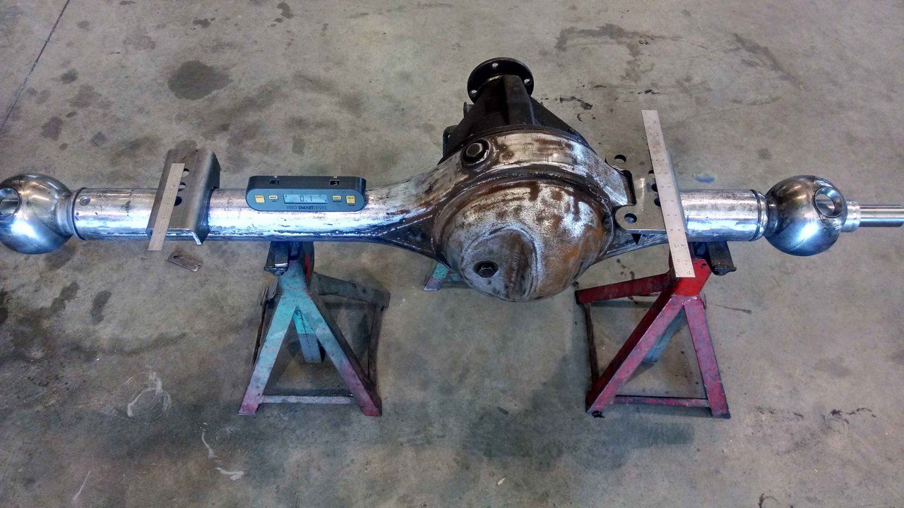

Setting spring perches to the factory width but I added 10° to the pinion angle.

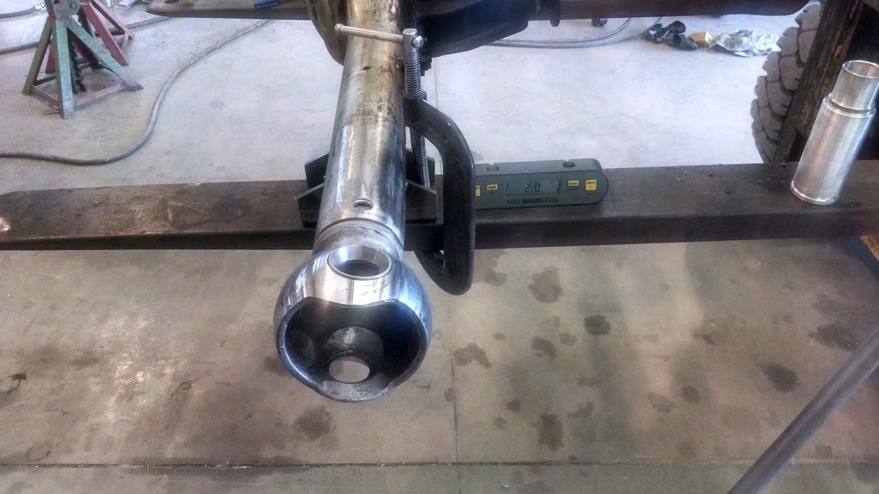

Employed some farm technology and used the tilt on my forklift to set the -2° that mirrors my front springs then set the caster for +4°
I stole my wife’s driveway drag to make a temporary housing straightener, no reason to cut up a good piece of I-beam for a one time use. I used a 10 ton porta-power with a 10,000 PSI gauge so I could monitor how much I was pushing on the housing and with a little heat the long side was easy to straighten. The short side was about 3/16” off before I started to weld the perches and probably ¼” after, it took all 10 tons and a lot of heat to straighten but both side are perfect now or at least within a 1/32”
Picture showing short side before welding.
Booger welded the knuckle gussets/shock mounts now just waiting for the rebuild kits and new steering arms.
The housing definitely warped when it’s welded but the jig helps control it some and preheat then welding short passes helps too, I’m guessing it moved about ¼” plus.
I welded all my root passes then straighten the housing to within a couple 1/32” or close enough that the end housing spuds would slide in with little or no effort, then attached the gussets and put a second pass over my root welds and the housing only moved maybe another 1/32” so now it takes some effort to slide the spuds in. I will straighten again tomorrow and don’t expect it to take much.

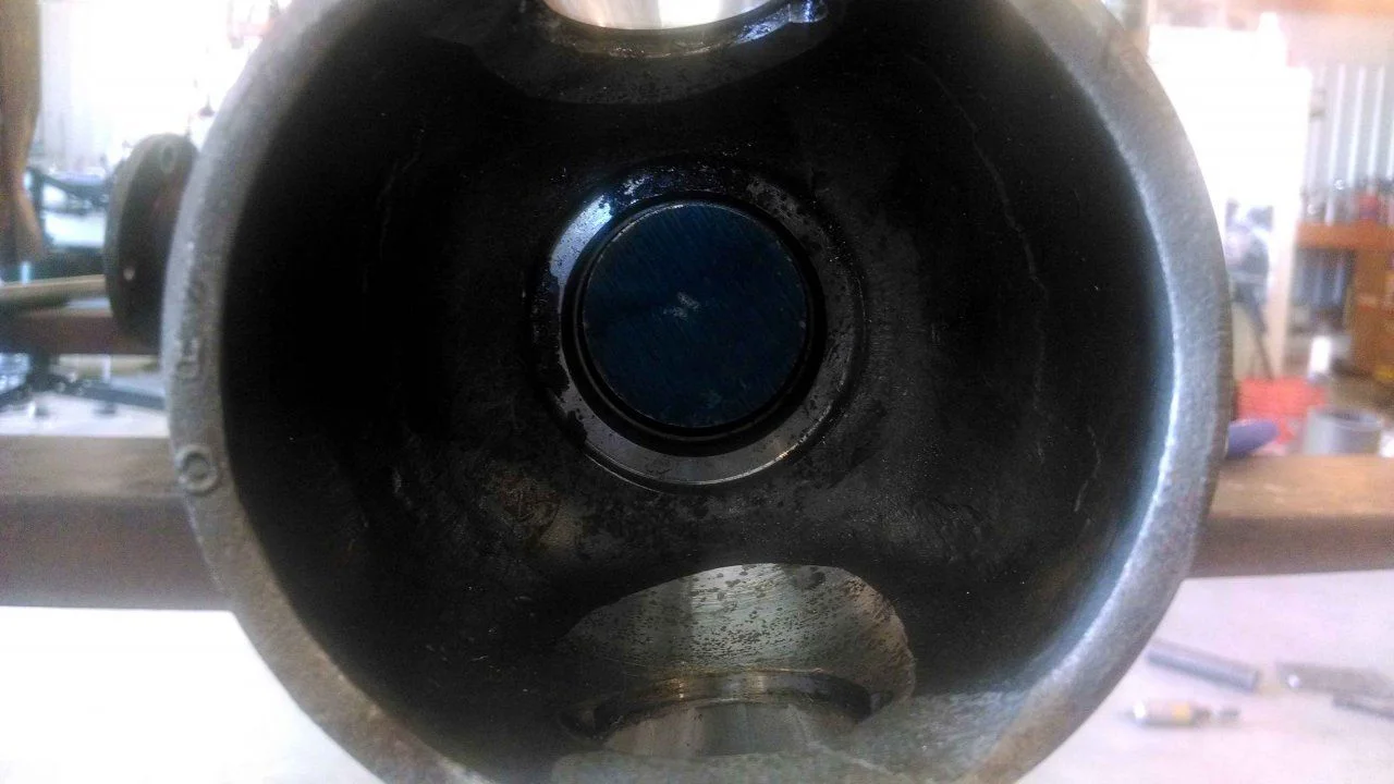

Some 4X4 Labs goodness, one ton tie rod ends and 25mm chromoly pins and bearings for the knuckle pivots same size bearings as the Dana 60 pivot bearings.
