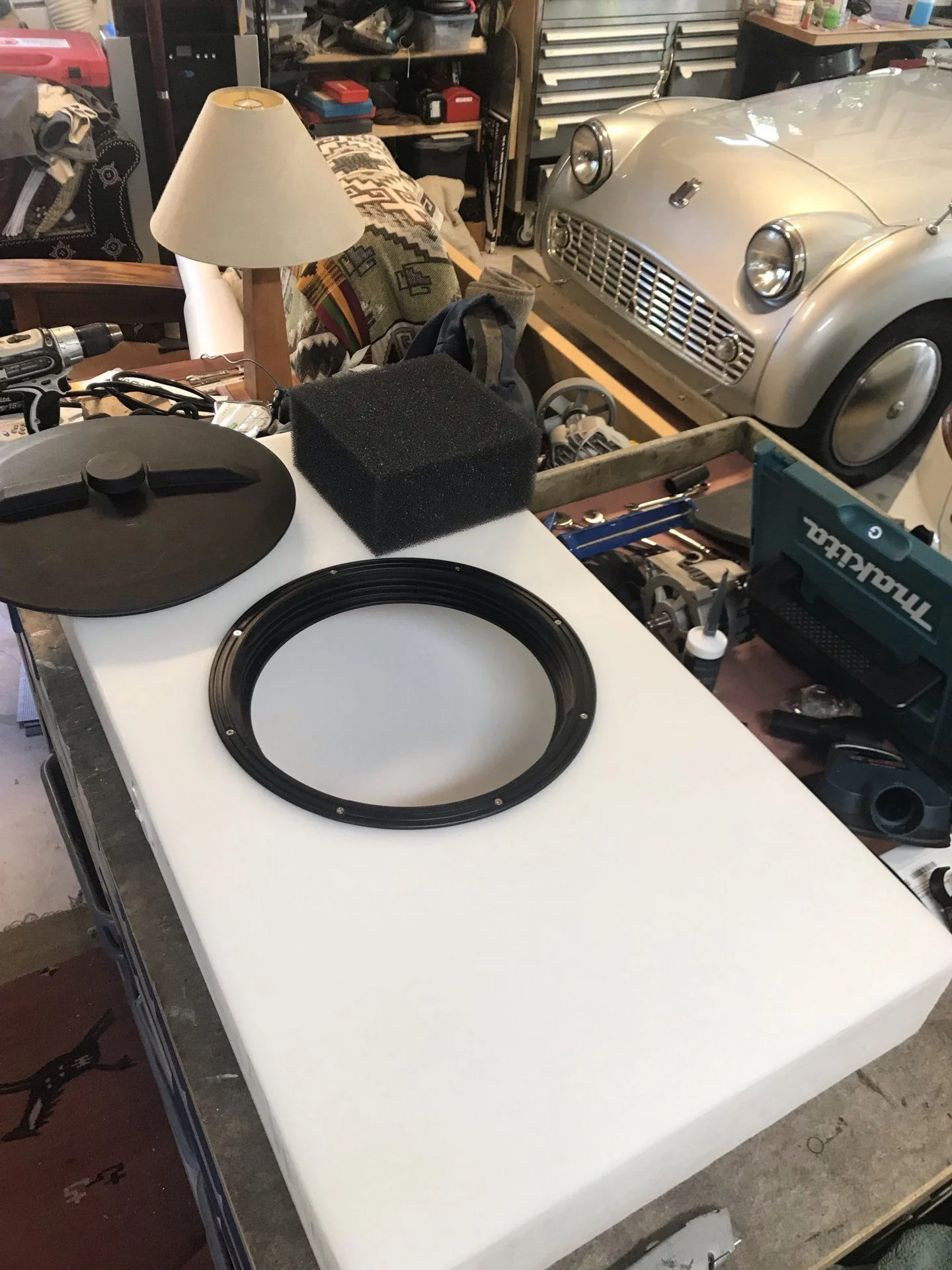

I updated my rooftop water supply from a 9” tall 6 gal tank to a 5” tall 11 gal tank. 12” lid for easier cleaning and anti slosh foam for stability.
Also went with a 4 1/2 gal Fuelpax, only 4” tall
Do you have a link or more info on the water tank and how is slosh foam used
Plastic-mart.com. RV freshwater tanks. Hundreds of sizes. With or without holes.
I get them with no holes. Order the lid I want and bulkhead fitting. I just have a ball valve mounted horizontally on the bottom of the tank with a garden hose fitting. The 12” diameter lid I got for this has a breather that I stuffed with a breathable foam so dust and dirt are minimized. Also the large opening allows the ability to reach in and clean it as necessary and the ability to but in the anti slosh foam.
The slosh foam is a very porous foam and comes in 10”x10”x4” squares and you get enough to fill the tank. I’m going to leave a cube out around the drain hole. As a place where water will migrate too easily. Best deal was at JEGS. Around $4 a cube.
My tank is 36x19.5x4.75. So half full the water has the ability really fly around in there. Not a good formula during quick stops or hard turns on steep trails. Similar type of foam used in racing fuel cells.
Hope that works for you

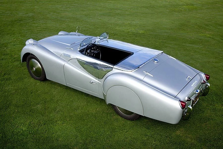

Wait a minute!! What's that BUGEYE????
Not a Sprite.
1958 custom Triumph TR3 I built 18 years ago. I fabricated the aluminum tonneau cover and wheel skirts. Retro fitted JC Whitney large moon hubcaps. Blue printed engine. J&E pistons, Carrillo rods, nitrited harmonically balanced crank, CC head, 10 1/2 to 1 compression, Quaife LSD, Custom 5 speed transmission ( tall 5th gear), Koni shocks front, custom built lever shocks rear, ceramic disc brakes front, ceramic drum brake rear. Mercedes Metallic Silver with 7 coats of clear.
Don’t know top speed cause the needle stops moving just past 120, don’t know what red line is cause needle stops just passed 6k. It loves cruising at 100, tap the go fast pedal and yahoo!!! It tracks like it’s on rail. 30, 60, 100, can’t tell the difference.
It’s been in 3 tv commercials, the last one was a Mercedes commercial out on Willow Springs Raceway.
I’ve put over 35k mile on her chasing the twisty turnies and straight arrow flats and she’s still hot.
Have given a few Porsche’s and Ferrari’s a wake up call

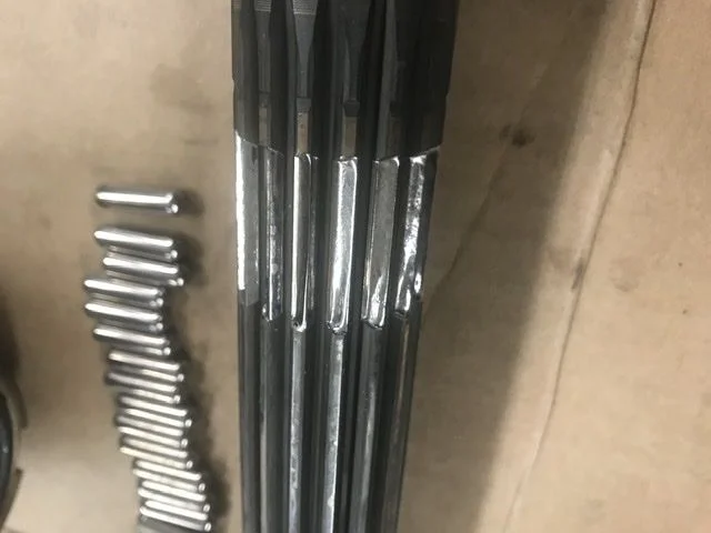

On the way back, shifting to second gear became a problem. Finally got a chance to tear into the gear box. Main shaft splines almost vaporized and bearings rattling like a baby rattle.
Don’t think it would have survived another trip. Back together now and hope to get a break from work soon.
