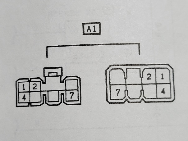

Can anyone help me with what this blue connector goes to? I'm thinking it was the cruise control control.
It attaches right by the clutch bypass switch on the upper left hand side of the dash by the cluster
I'm finding two connectors that look like that, but it's not labeled blue. Note that the connectors labeled A1 below appear to be the same.
The first is labeled Auto Antenna. Five wires ...

The second has to do with the radio and horn (A1).
5= G-W
The third is also the horn (A1).
5= G-O on the male side
5= G-W on the female side
The fourth is headlights (A1).
6= R-W
The fifth is Emission Control (A1).
1= B-Y
2= Y
4= L-R
7= Y-W (male end) Y (female end)
Pics of the connectors. Left is female, right is male.
That plug on the left looks identical. Could likely be emissions controls as I don't remember unplugging this one from the donor rig when I pulled the harness to install into my tdi rig. The emissions stuff was likely ditched many many years ago.
