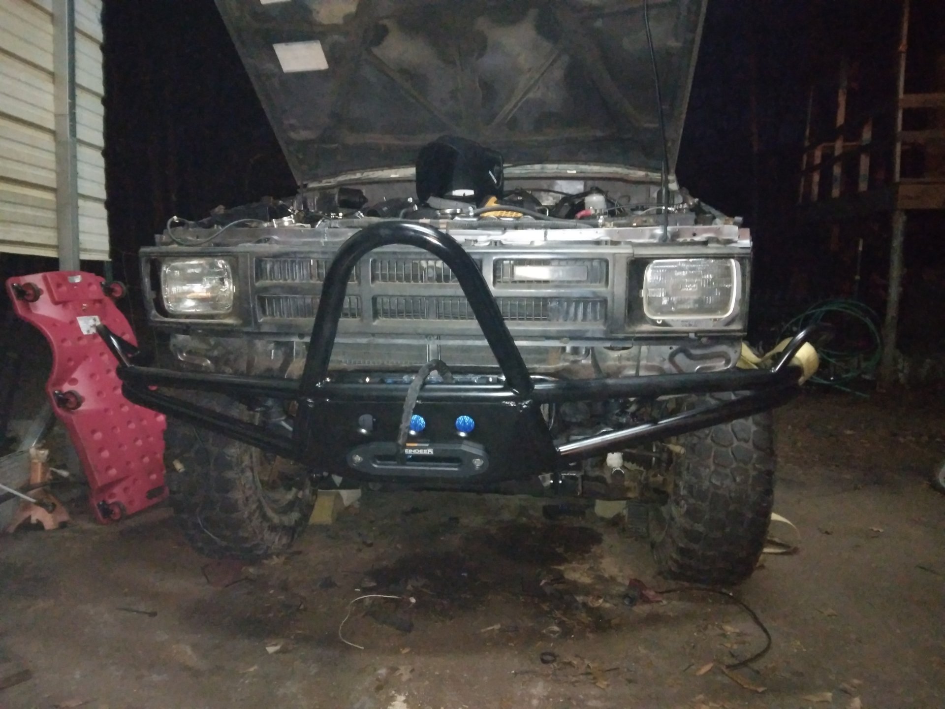

Crap...where do I put the intercooler? Do I trailblaze and mount it in the space of the brush bar...or go full blown import and cut out the grill to fit it?
Not an intercooler but you get the idea.

So ratchet strap my intercooler to the outside of my grill?
All joking aside I see where you're going here and I don't dislike the idea.

I'll look closer into a hood scop and top mount intercooler. If I can fit it on the drivers side of the hood it could work. I can't center the intercooler because it would block the oil fill. Due to clearance issues of block height the only place I could fit the intercooler over the motor is toward the fire wall. I don't mind removing the intercooler for oil changes. On a daily driver I don't want to block the oil dipstick or oil fill. On a trail toy this would be no issue.
I do have some open space between the Power steering reservoir and master cylinder.
I cannot bring myself to cut a hole in the hood...but I also need an intercooler . I was looking at skid plates and they run north or 200 plus shipping. I have this old bed frame and some 1/4 or so inch diamond plate aluminum. I've made my own skid plate and will mount an aluminum MR2 intercooler behind it. I'll still need to drill holes for air to pass, will do that after the IC has arrive.
A 90% on road truck won't need assistant with keeping the iat down. If I ever find myself doing more trail riding I have plenty of room to mount small a 12 pulling fan. My vcds reads real time intake temps at the intake so I can make adjustments as necessary once she hits the road...eventually.
