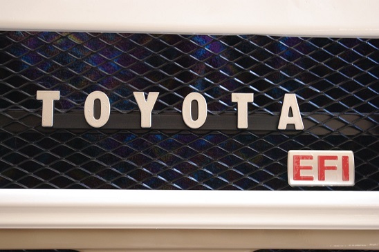

Hope I didn't upset any of the yota purists with my tdi emblem.
I certainly approve. Same idea I had when I installed the 2FE into my FJ40.

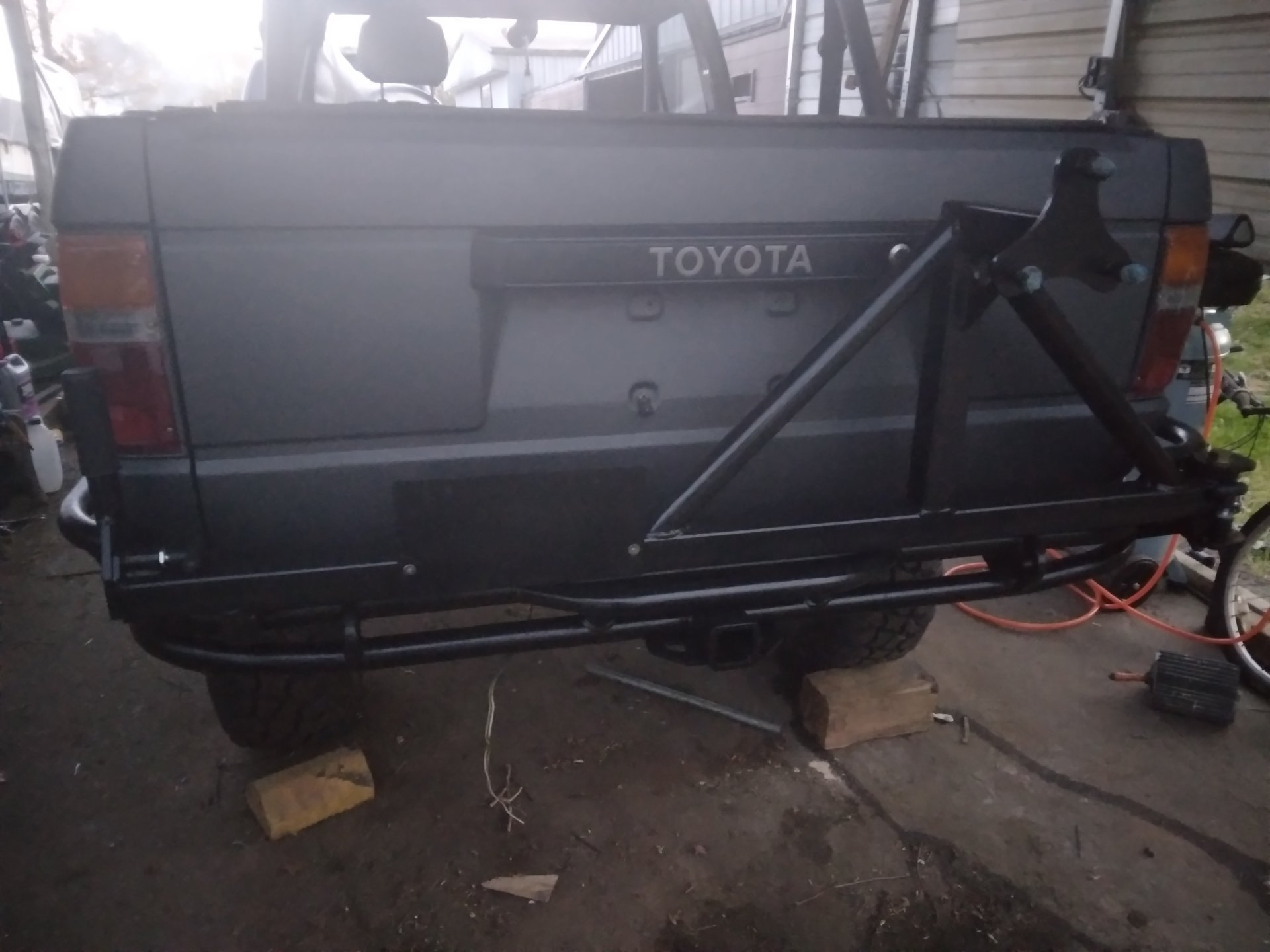

The 4xinnovations swing out tire carrier bumper installed. At
I primed the bumpers then applied cheap rustoleum roll on bed liner. Cheap, single stage, protective and easy to recoat. I did the front with regular prime and back with self etching (both rattle cans).
The regular primer seemed to bond better. Maybe I just messed with the rear bumper more?
Either way, now I need matching full sized spare. Hope to get sliders mounted this weekend.
