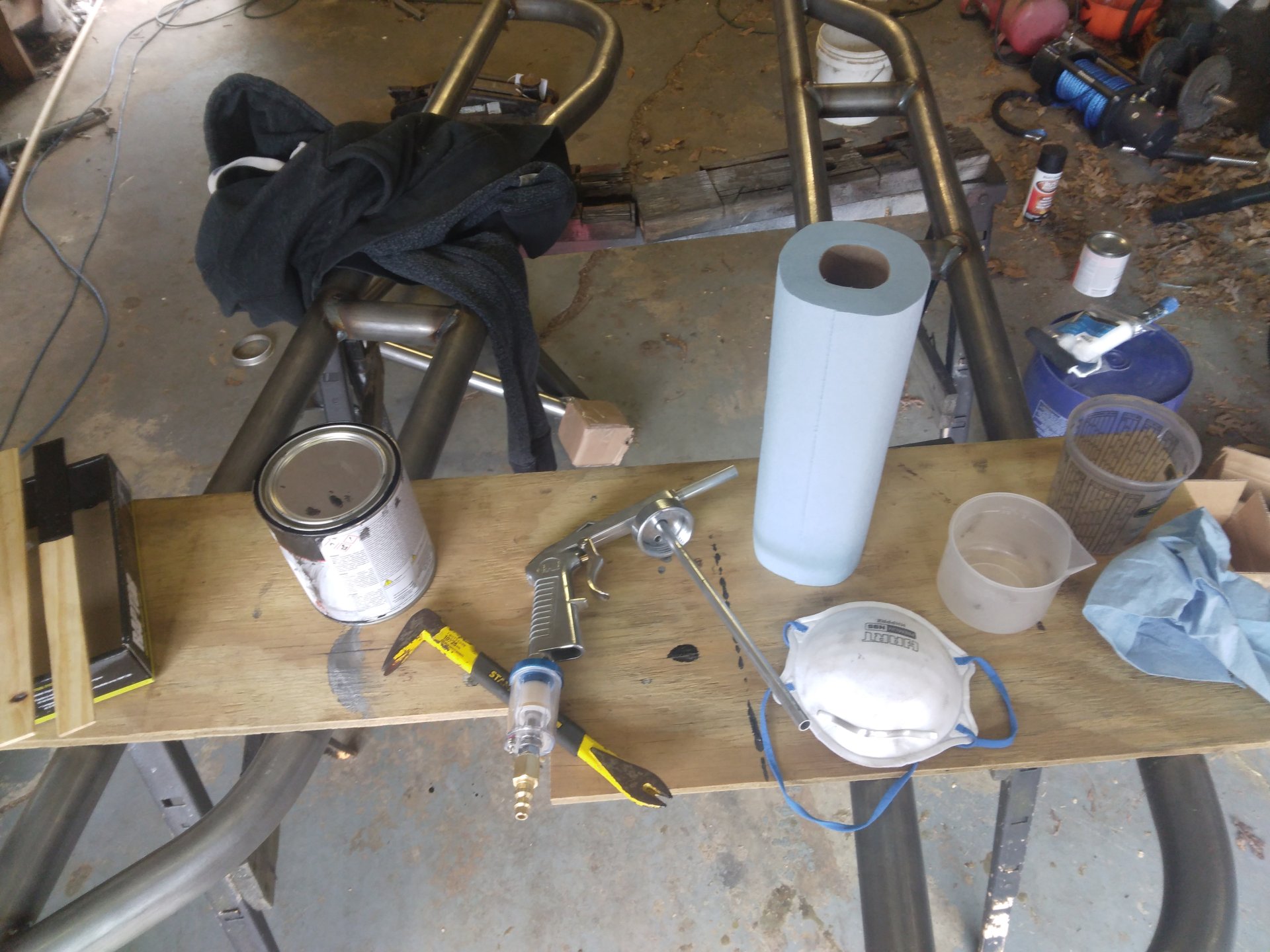

I just ordered the u Pol raptor liner to spray the body with. Will be thinning 15 or so % and spraying @45 psi, 1.4 tip in a cheap hvlp gun. Will likely go a little lower pressure around funders and rocker panels for more texture.

Not perfect but this will be coated with u-Pol raptor liner. It's a little thicker than base/clear coat so it will hide imperfections better.
