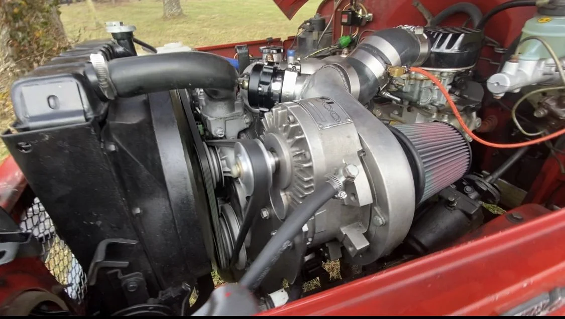

Hey everyone! My name is Eli an I’m a 16 year old that makes YouTube videos. My latest project was fabricating this Paxton novi 1000 supercharger to my dads FJ40. I made the bracket and did all of the tuning, probably gave this 2F motor 80 more horsepower at 5 PSI of boost. Anyways I just got done with editing the first part of the series, go check it out on YouTube with this link. I’d really appreciate it!

Thanks man! Really appreciate it, I would run an inter cooler if it were a turbo. Just running off a belt this thing blows the same temperature air that it would normal suck without the blower. After running for an hour or so I can hold my hand on the housing of the supercharger. As you’ll see in the next video I am running a trans cooler that the oil for the novi 1000 runs through. I’d be surprised if the oil got to 100 degrees in the supercharger. Definitely a great question, this was just my thoughts when doing this. Now for melting the pistons we will see what happens, the engine still runs very cool even going highway speeds. If it does I’ll pull the motor and rebuild it. Thanks again!

Wow! Had no idea about that, I burned up the internet and could only find serpentine style pulleys. That’s why I had one made, my friends shop is right down the road, makes 3000+ ft torque pulling engines. Made this pulley in under 30 minutes, quite impressive.
Props on an awesome project, but this isn't correct. Any form of air compressor heats the air. At 5 lbs of boost, probably not enough to be an issue, but she's not breathing outside air temp.

Oh okay! Yeah definitely has to make some more air resistance causing heat. I’ve ran it with the bonnet off and felt the air coming out after running it for a while and it’s still quite cool. As you said 5 psi isn’t enough to really justify an inter cooler.
It will only make a lot of heat at full noise. As long as you run decent fuel and not stupid timing you should be fine at low boost. Do you know your AFR?
When it becomes a bigger issue is at higher boost, I am responsible for tuning a ford barra at 18 psi which badly needs more intercooler. She will make about 40 less rwhp on a second back to back run than the first with a fan over the cooler for 5 minutes, and the only difference I can see is IAT. I suspect it's pulling timing too, but case in point, if you're feeding your engine hot air you are leaving something on the table. The question is, if it's worth the ROI to intercool at 5 psi - I say no.
