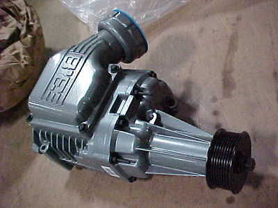

Pics of an M90 from a Ford Thunderbird. I don't see any differences except the snout. If someone needs a replacement SC for the early kit, it might be possible to swap your original snout on to one of these.

The adapter mounting points on that look to be correct for the early adapter.
Well, if someone gets desperate it looks like there's readily available rebuilt units for $600-$800.
