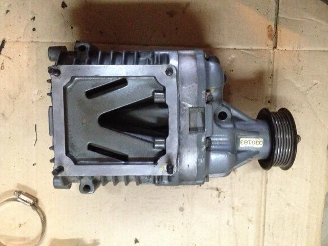

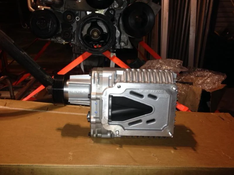

from what I've read the smallest pulley on a M90 is 2.7" unless you want to machine the nose. It almost looks like that machining has been done already to the MP90.
Any chance we can get a measurement of the nose to see if indeed smaller pulleys can now be used before machining is required?
Well, if someone gets desperate it looks like there's readily available rebuilt units for $600-$800.
Whoa, you can buy a refurbed TRD supercharger for less than $1000? :eek:
Just a "replacement" blower.
They're not TRD, they're Ford. However, they are both Eaton M90's. Eaton makes superchargers for OEM applications. They often have minor tweaks to their basic design to suit an individual manufacturer's purpose. However, the Ford Thunderbird Eaton M90 and the TRD Eaton M90 have cases that appear to be identical. There may be some minor differences I can't see in pictures. For instance, I suspect the holes are probabably tapped with SAE threads instead of Metric.
The snouts are definitely different, so even if the cases are identical, you'd still have to reuse your OEM snout. This is basically just an option if for some reason your case or rotors become destroyed.
Also, as Dan pointed out, it's just the blower. To SC your rig you'd need the plenum and throttle body adapter which are both specialty castings.
And a crank pulley, fan spacer, brake booster pipe, idler/tensioner assembly, cross over pipe, intake elbow, hoses and so-on.
