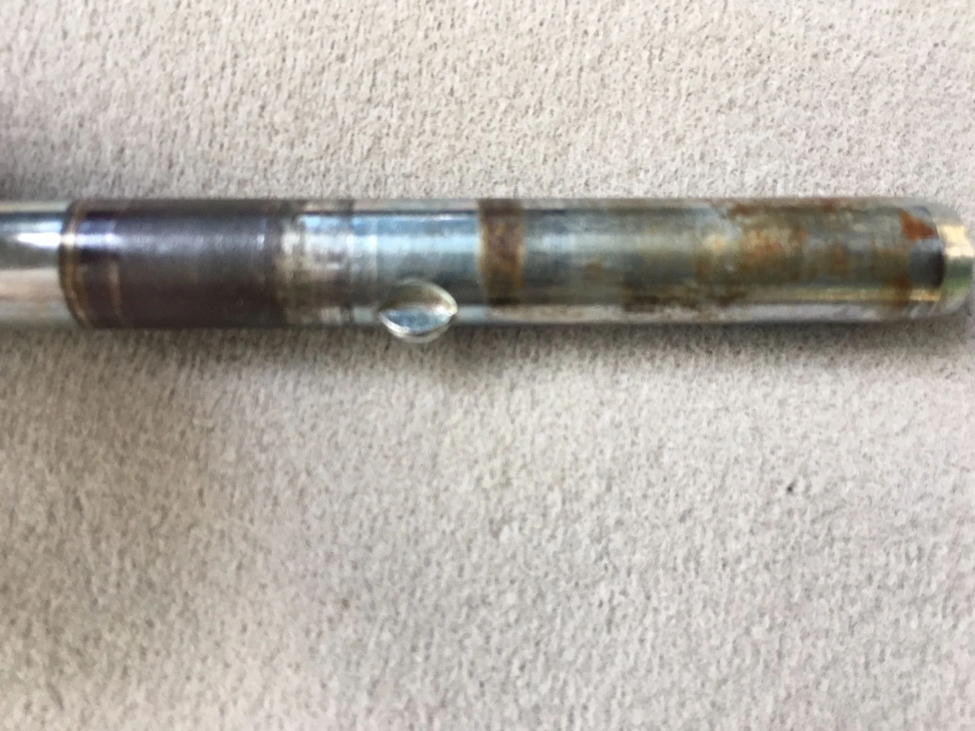

I'll add one more PRO TIP: the shaft of the visor arm has a keyed bump stop stamped into it, it must be rotated to the right spot in order for it to slide out of the internal mechanism. Didn't know that and kinda ham fisted forced one of my old visors apart, glad I didn't do that to one of the new visors. Pic:

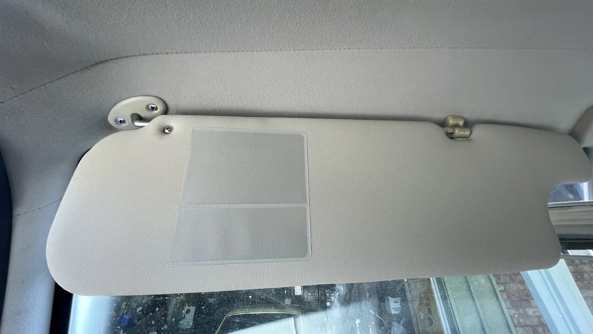

Cleaned up the old visor arms, applied some of the grease that was on the new arms...which will get on the visor material where it slides in. Needs clean up. Screwed everything together, adjusted the tension screw and Bam!...new OEM visors!
As mentioned before, the color is spot on to the headliner and would match even better if your headliner is actually clean. The only difference is the new visors are a textured vinyl and our headliners are that soft cloth.

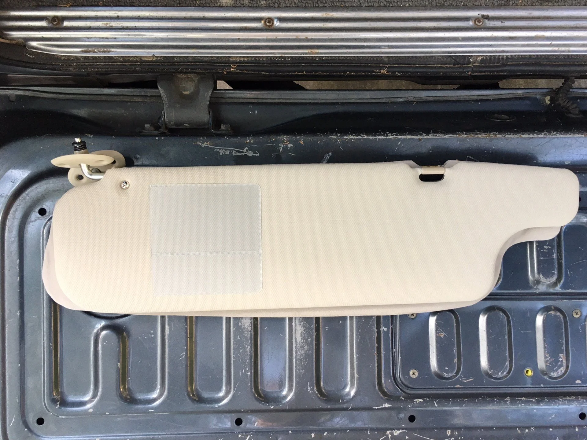

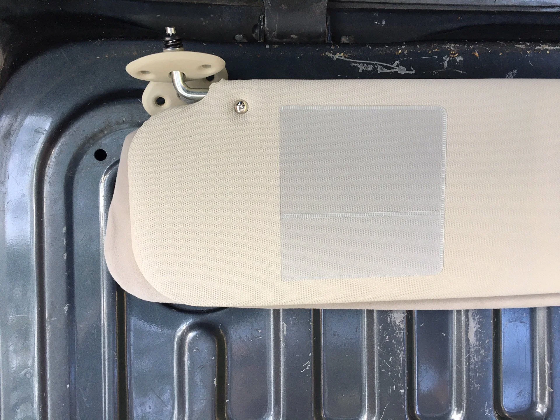

Couple comparison shots showing slight differences in size/shape of old v new. The only thing that bugs me a little is the new visors are shorter on the outside edge and don't completely cover the glass in the upper corner. That's the one thing I have always LOVED about the old Cruiser visors. None of my modern car visors cover completely, and the damn late day sun always seems to sit riiiiiiight in that upper corner. Oh well.

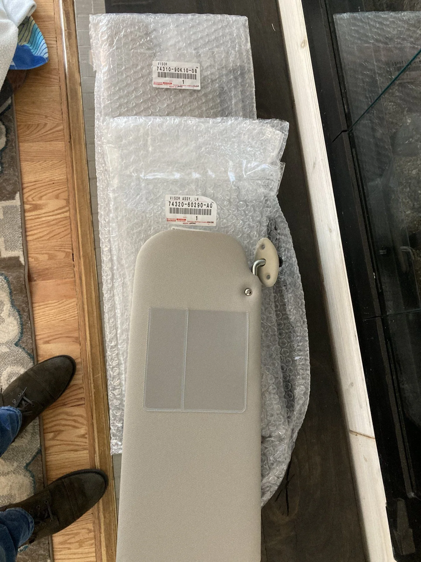

And for my final trick !! I will answer the question, "Where did you get these?"
I ordered them from PartSouq.com (not a typo). They are based in the United Arab Emirates. I was a little nervous at first, but they were easy to deal with, priced right (for me), and were original Toyota parts as advertised.
Part Numbers:
- 74310-90K10-08
- 74320-60290-A0
Total cost was out $106.71, included FedEx shipping to Memphis, TN. Arrived in 3 days and had tracking the whole way.

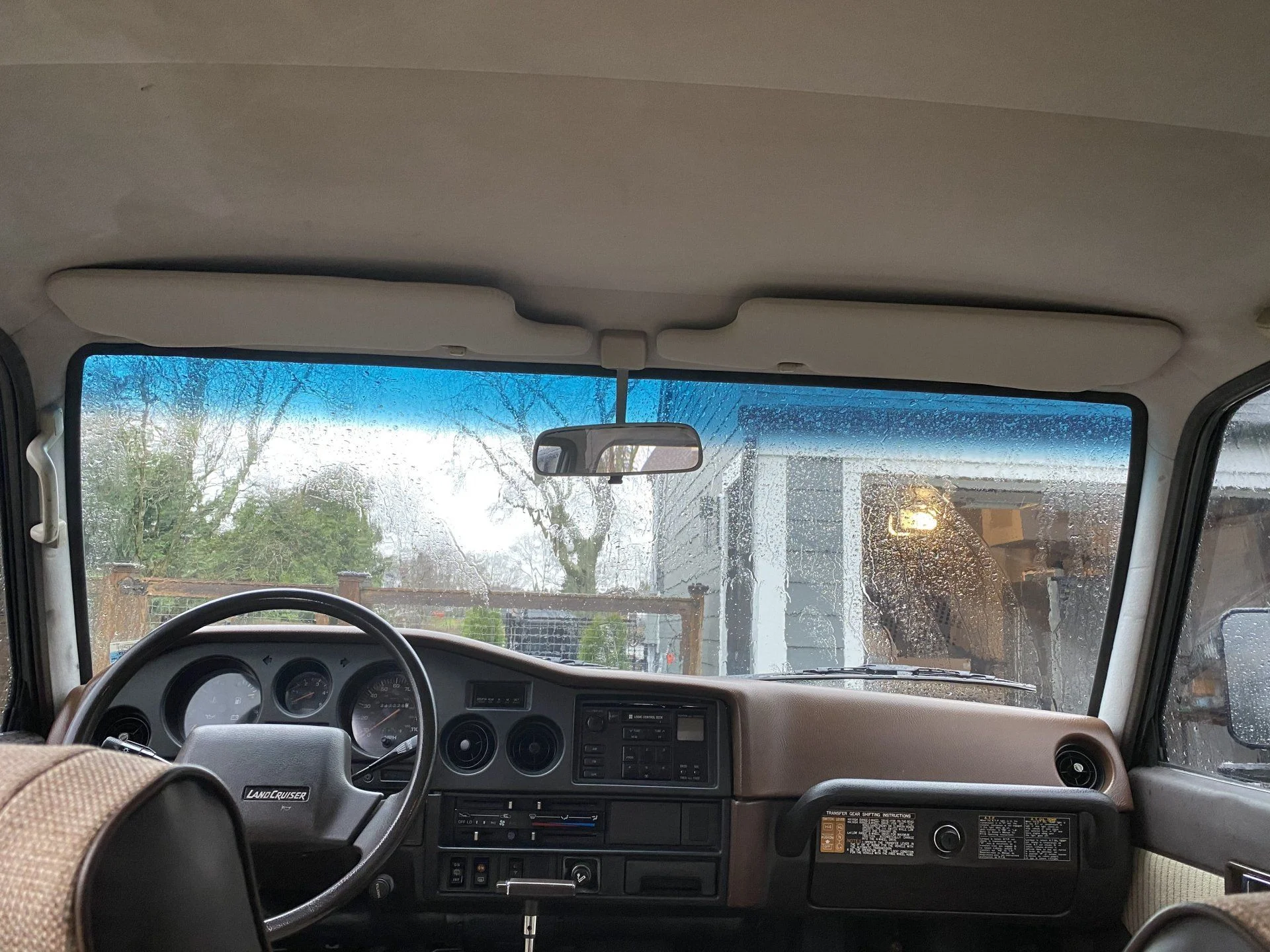

Thanks to all the tips in this thread! Just installed the 70 series visors in my ‘88 FJ62. Used the original arms, took maybe 10 minutes for the swap. Such a good match and upgrade to my original sagging visors. Thanks again!

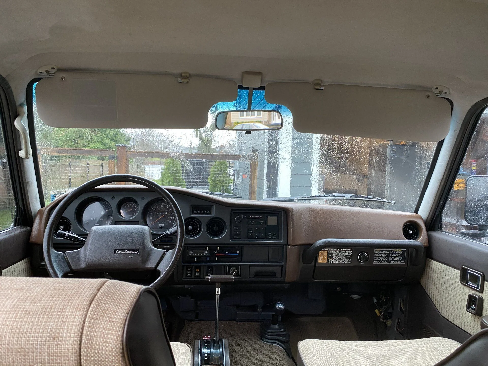

View attachment 2516132View attachment 2516133
Dang man, interior is looking great! Fresh carpet, and Cruiser Corps covers, I see! Very well done.
Thanks! It's been my lockdown activity. Truck was delivered to me first week of March, have been chipping away at it while "working from home"! Hat tip to @dnp for the carpet! Also put in @OTRAMM 's exhaust and rebuilt tranny from Cruiser Brothers. Let's just say my wallet is a bit lighter these days!
