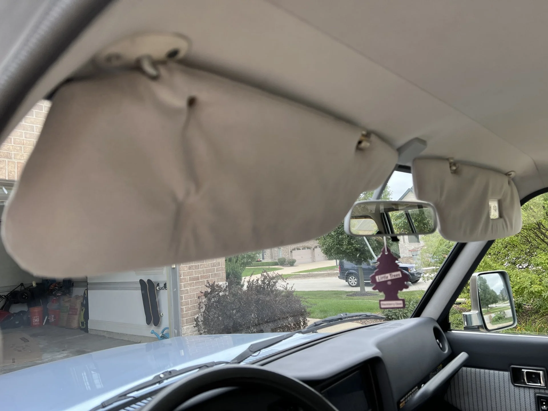

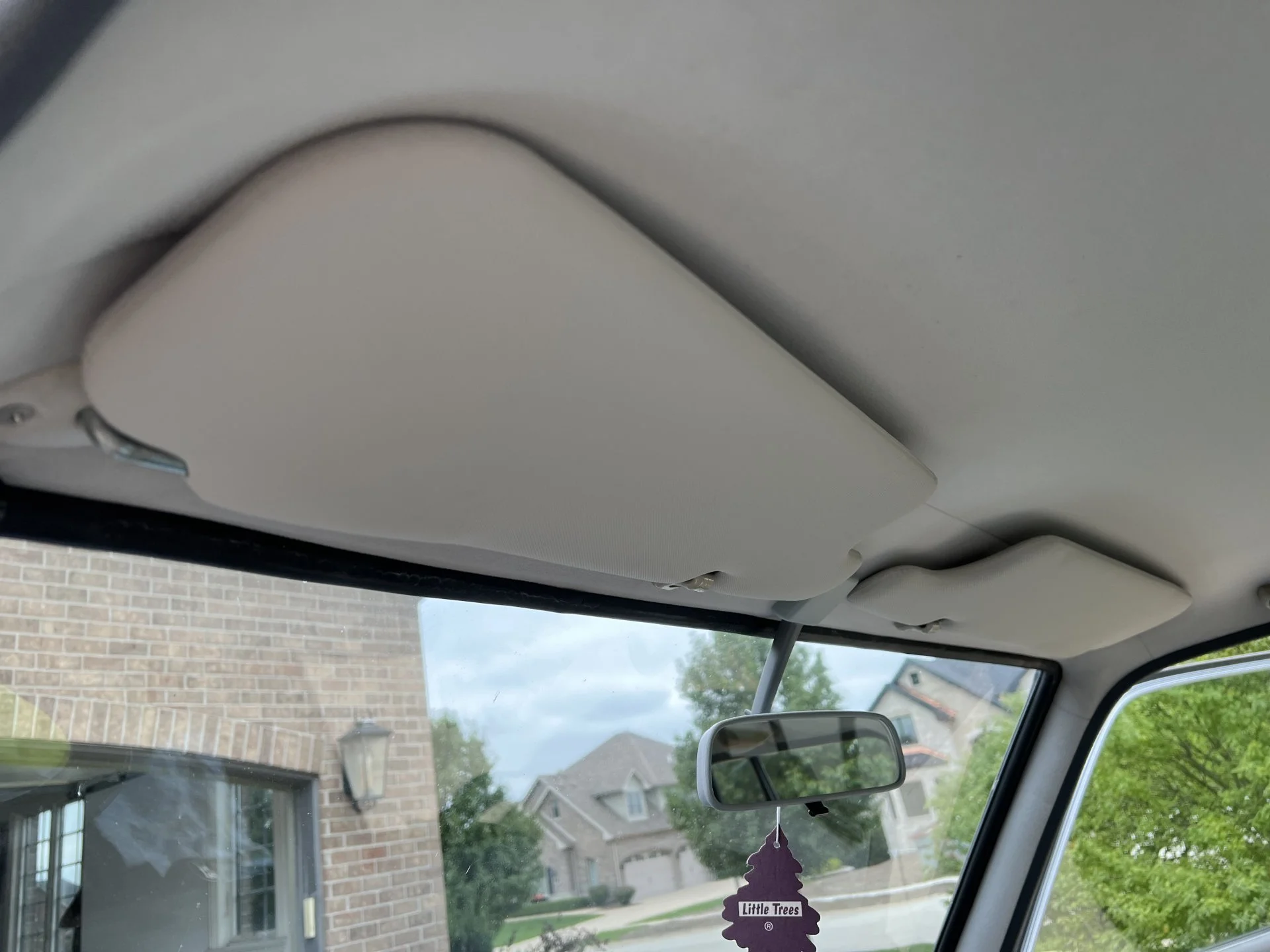

So my order got lost in transit for a bit so took a lot longer than it should have to get them but I was kept up to date anytime I asked. Not their fault or anything and they made it all right - just needed to be patient. Regardless I'd order again no issues.
As for the upgrade, it is a huge improvement.

Wow looks great! What P/Ns are these? Mine look like the first ones

Those new ones look MUCH better. Mine, too, look like your originals. Look more like cheap hotel pillows vs a nice sunvisor.
Also - are there mirrors on the other sides of those?

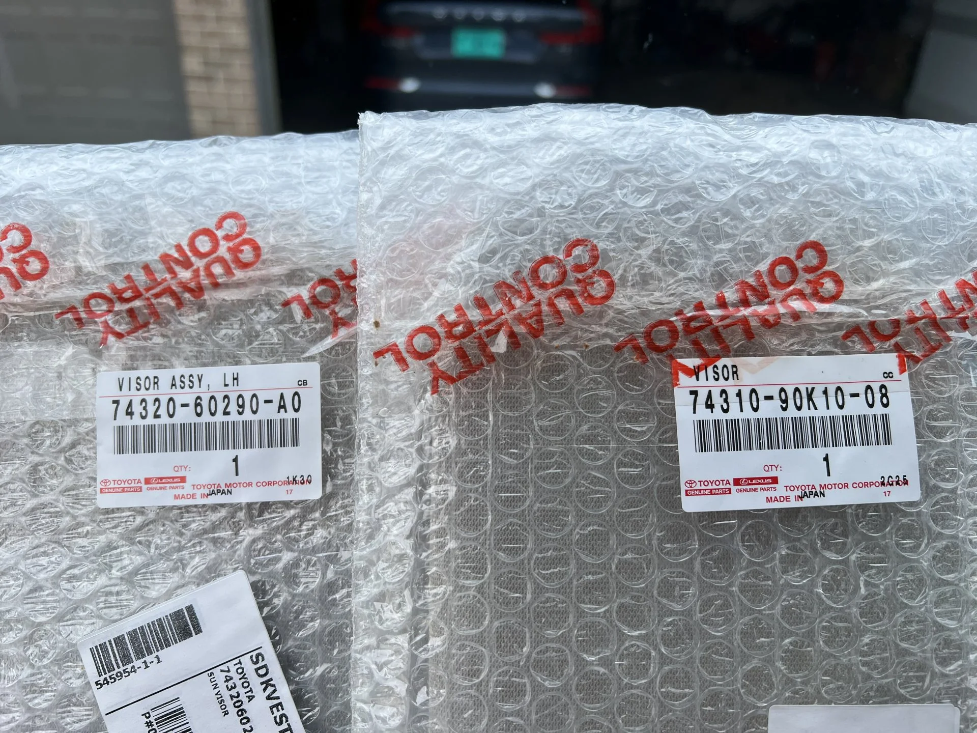

I ordered from partsouq, but amayama likely has the same parts. Both sides are still available in light gray from a 70 series. I’ve done the swap on 2 different 62’s. Do a quick search and you will find a post from me with part numbers.

So, here's a write up I did several years ago for another 62 I owned: Sun Visors - https://forum.ih8mud.com/threads/sun-visors.862485/post-11649786
I did the exact thing to my current truck. Same part numbers and everything.
Wondering if anyone has tried 74310-90K11-08? If I'm reading this right, it looks like a substitute for the RH visor in post #56 (74310-90K10-08) but let's you keep the vanity mirror:
