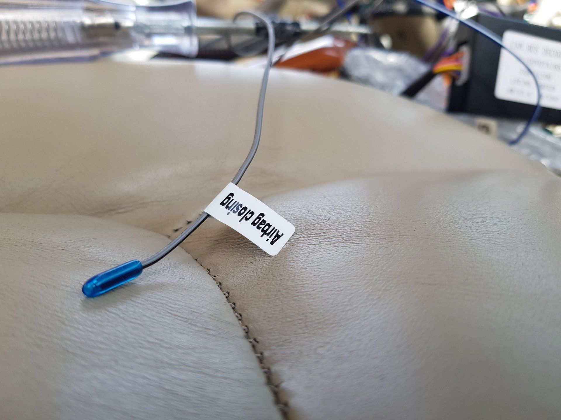

Did the airbag light on when you install the unit ??
Because mine is ON and if u make the rear camera work plz tell us

See this post for the airbag light solution.

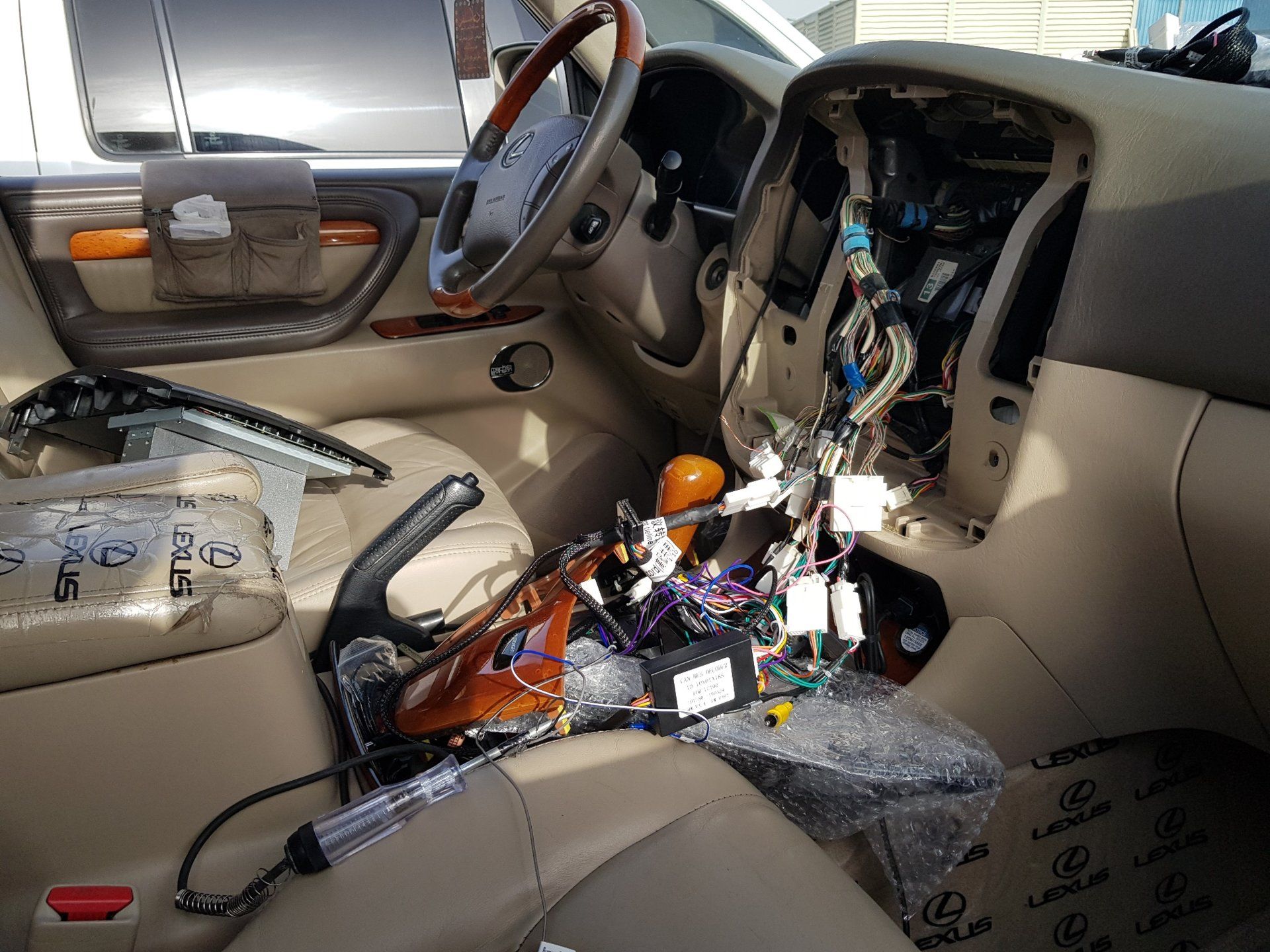

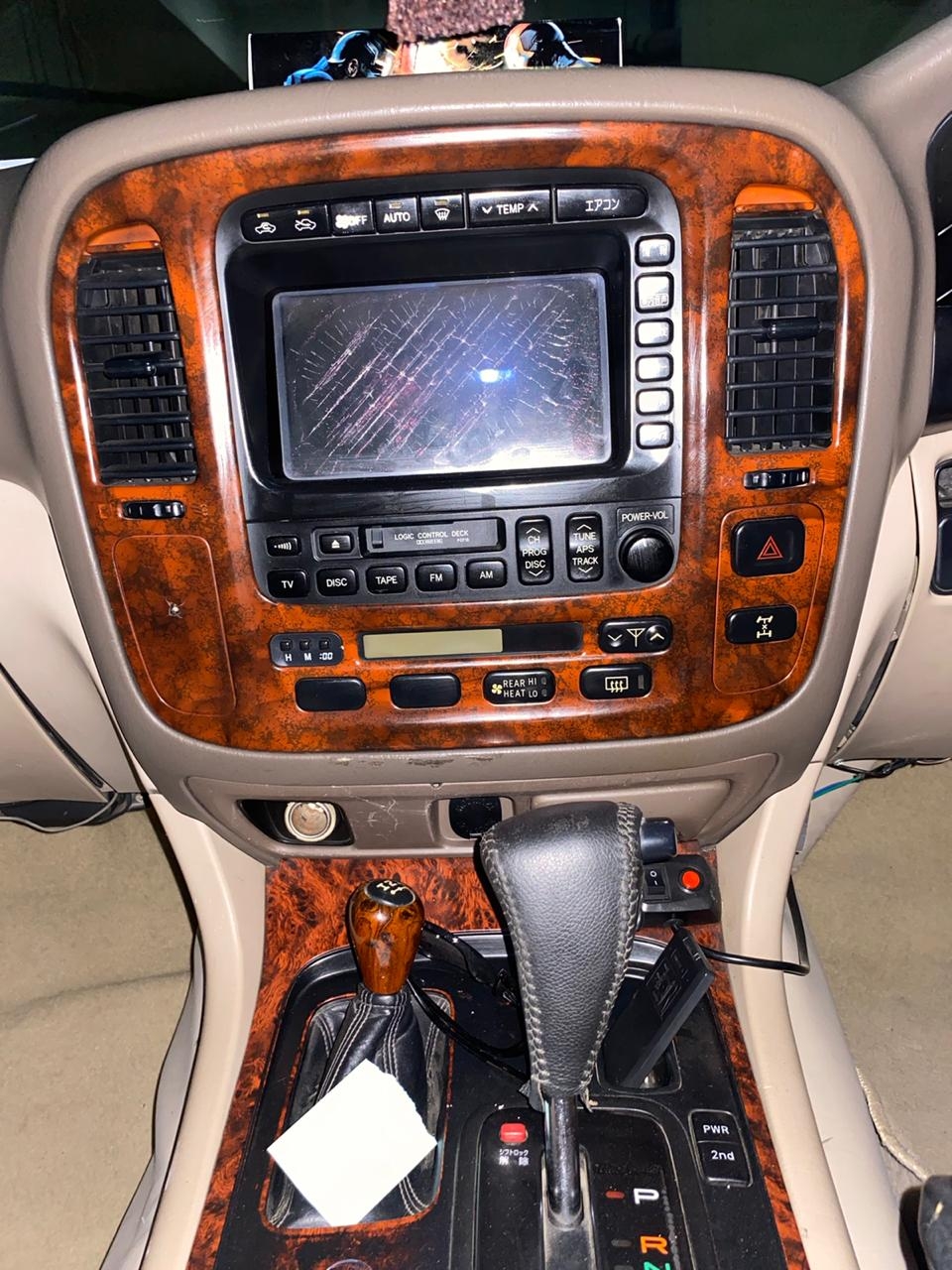

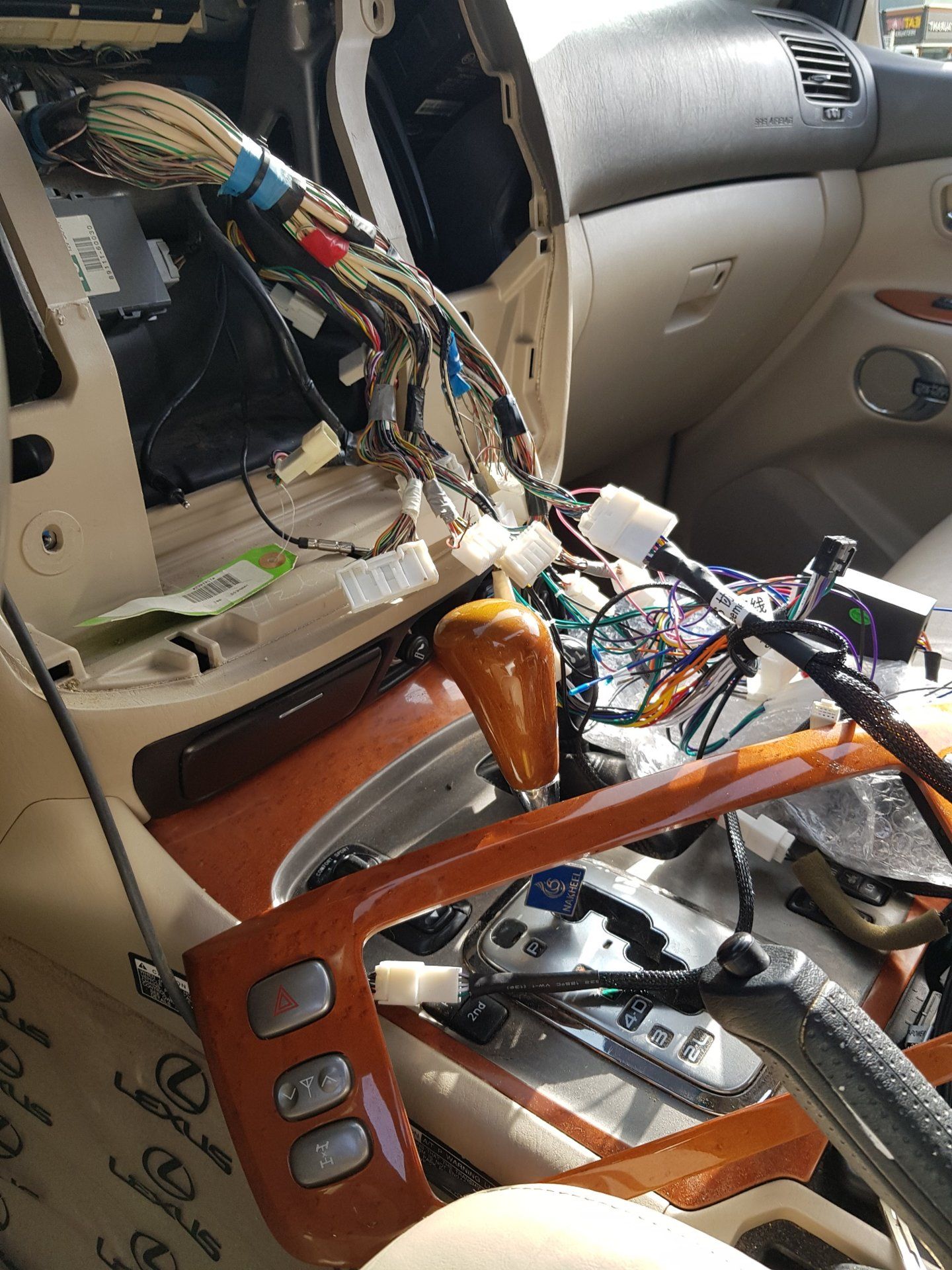

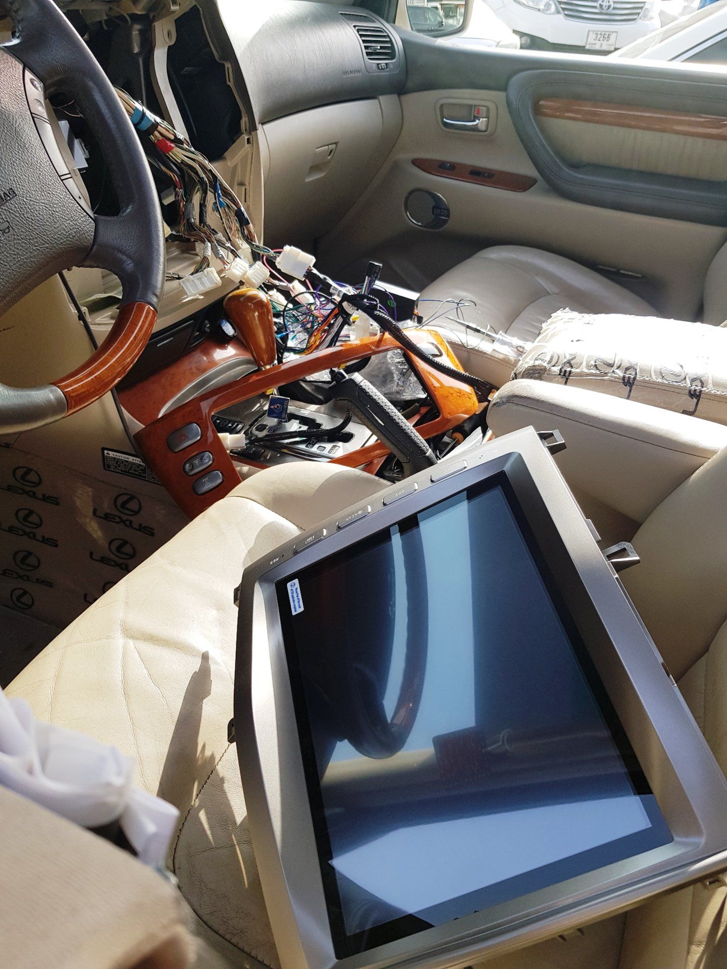

So it all started when I saw THIS THREAD... I was all excited and started researching the possibilities and options. I originally wanted to install the smaller headunit where you replace only the MFD and includes "transplanting" some logic board. I dropped the idea when I came across the tesla style head unit. After many weeks of research and checking with local audio installers in Dubai, I pulled the trigger.
Had the unit installed early this week.
Short video posted by the installer on his Instagram page:
Video.

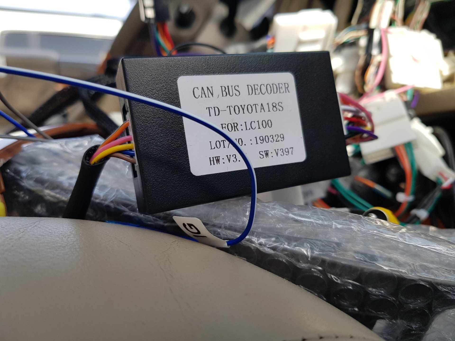

During installation:
Canbus:
Not sure what this wire does... it was not connected,
