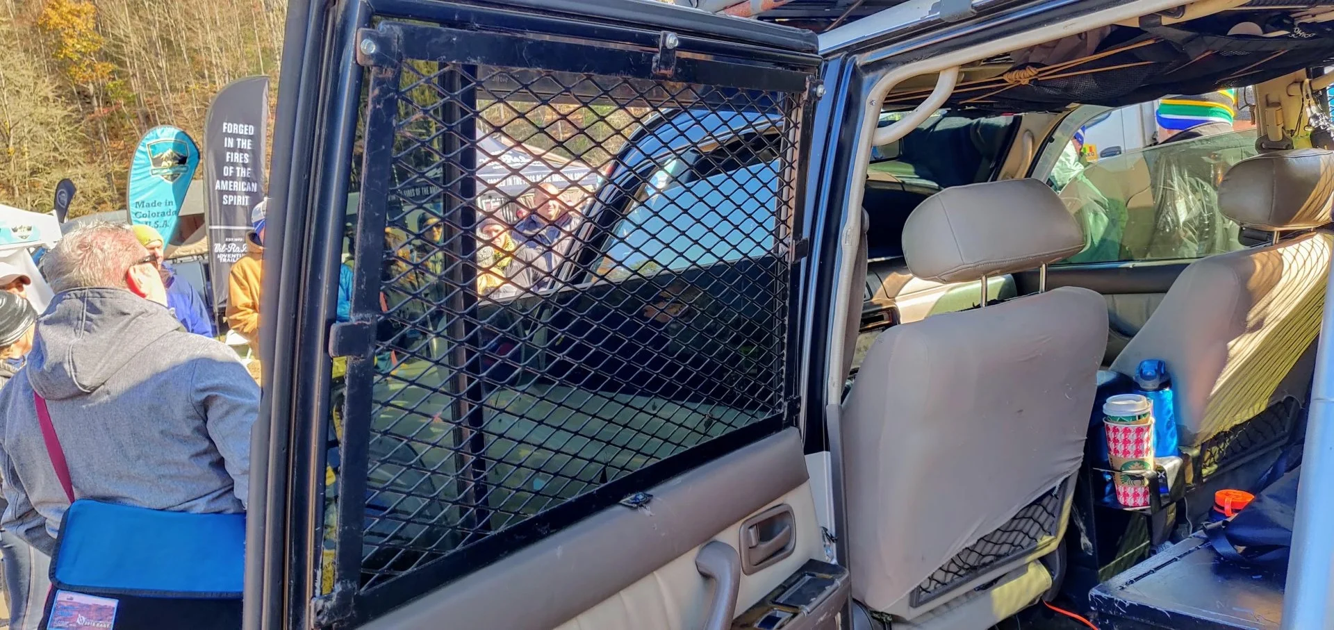

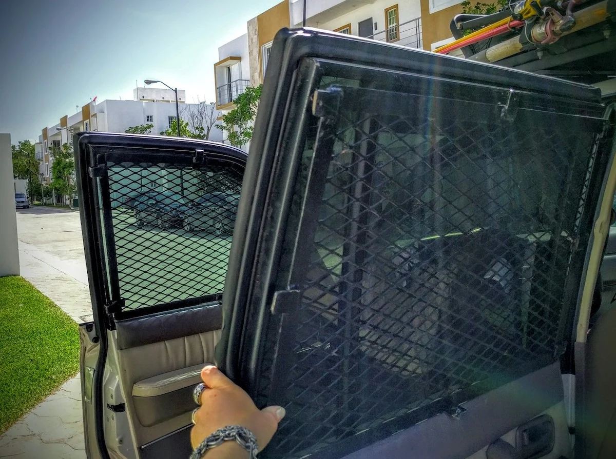

I met a couple at Overland Expo East who did extensive travel through Mexico. I noticed they had some security mods done to their truck, and we discussed them.
They indicated that (in Mexico) thieves commonly punch out the door lock, and open the doors with pliers. Or they just smash the windows.
This couple installed expanded steel mesh behind their rear windows, and a literal rod which prevented access to the door locks / handles. The front windows had 3M knockoff clear film which prevented the windows from shattering.
Their work was somewhat crude, but I think both could be implemented more elegantly if someone was very serious about security.

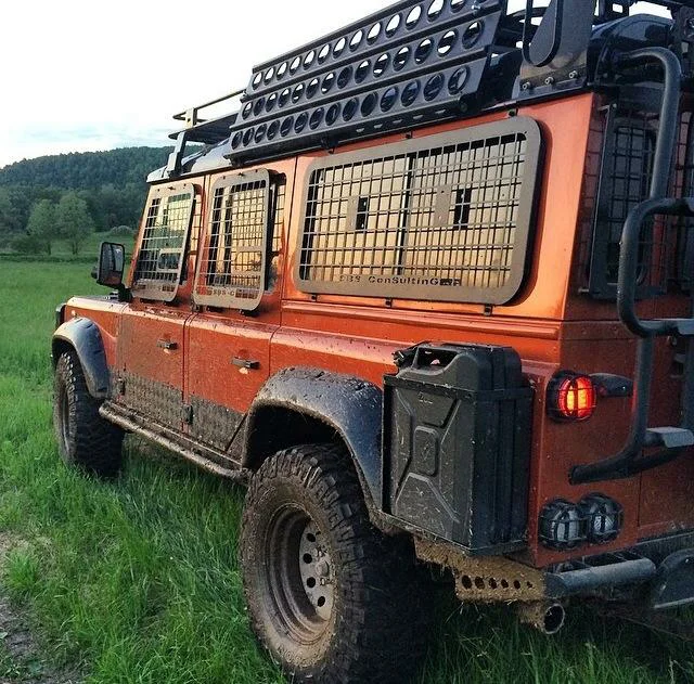

Another shot:
Found this last night when perusing YT...thought some of the suggestions were good ad lib options if needed, without spending a ton of cash.
Couple days ago i was thinking to install kind of protection on all the windows and here we are…but in that case all the windows need to be protected even windshield:)
