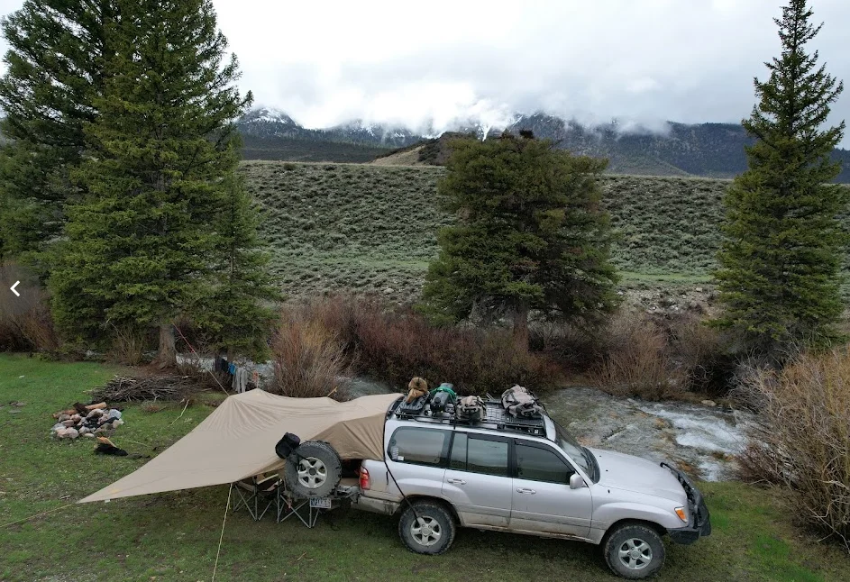

I went with 80/20 and kept the stock side rails:
It works well for my needs. I had a RTT bolted to it in the past and now use it for a 270 awning and solar.

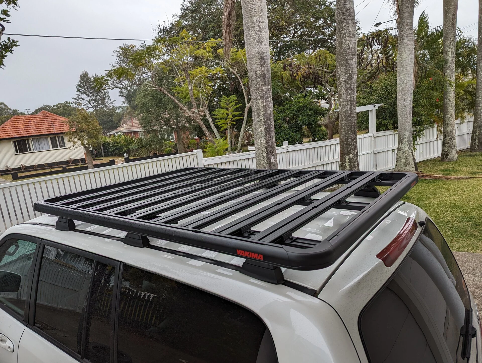

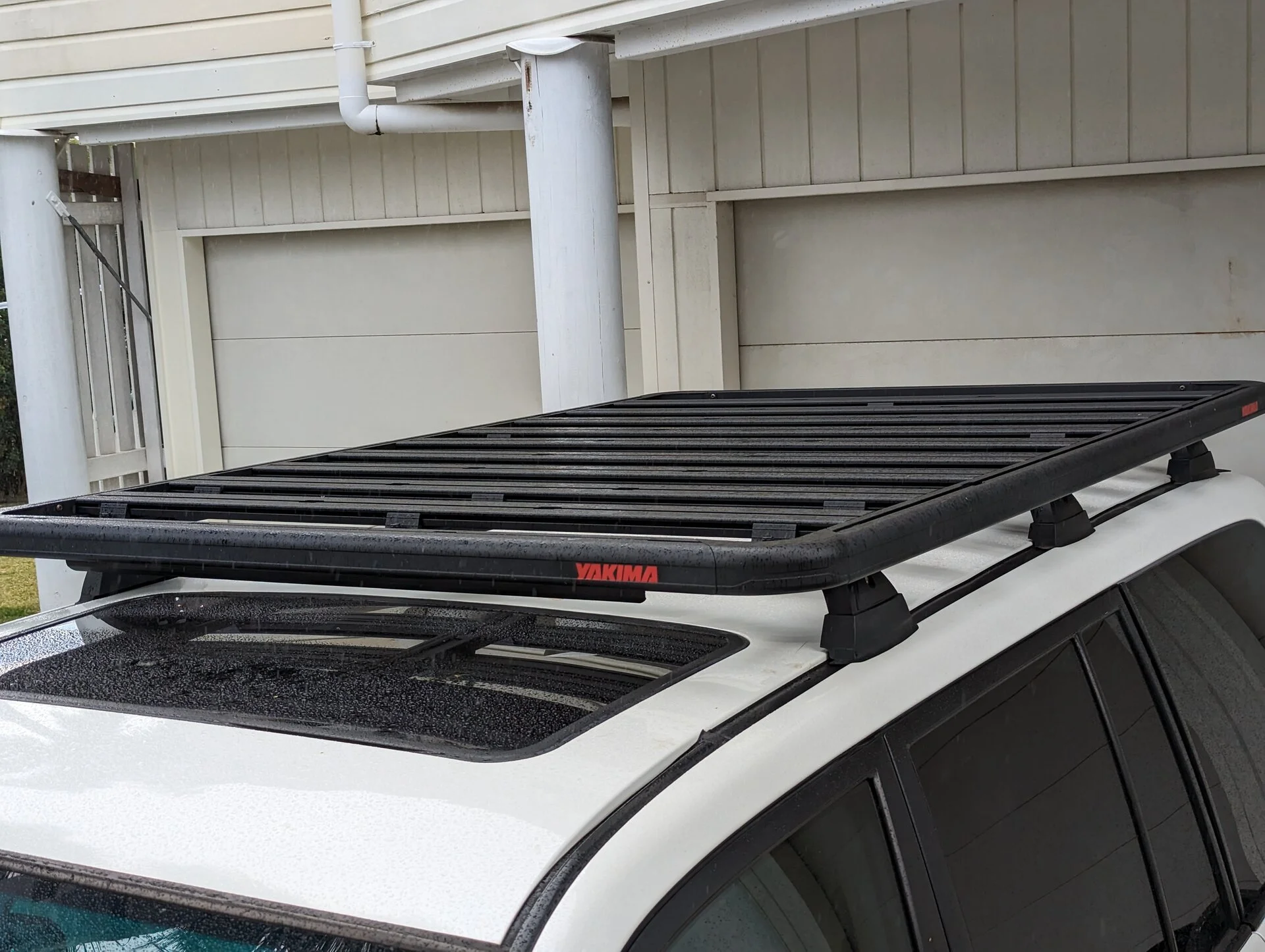

Yakima is a real rack system :). And the full size platform N (1,930mm x 1,380mm) with 6 legs is 33.7kgs. If you have a sunroof, consider a platform L, which is only 1,390mm long and is set back far enough to be outside the sunroof's area.

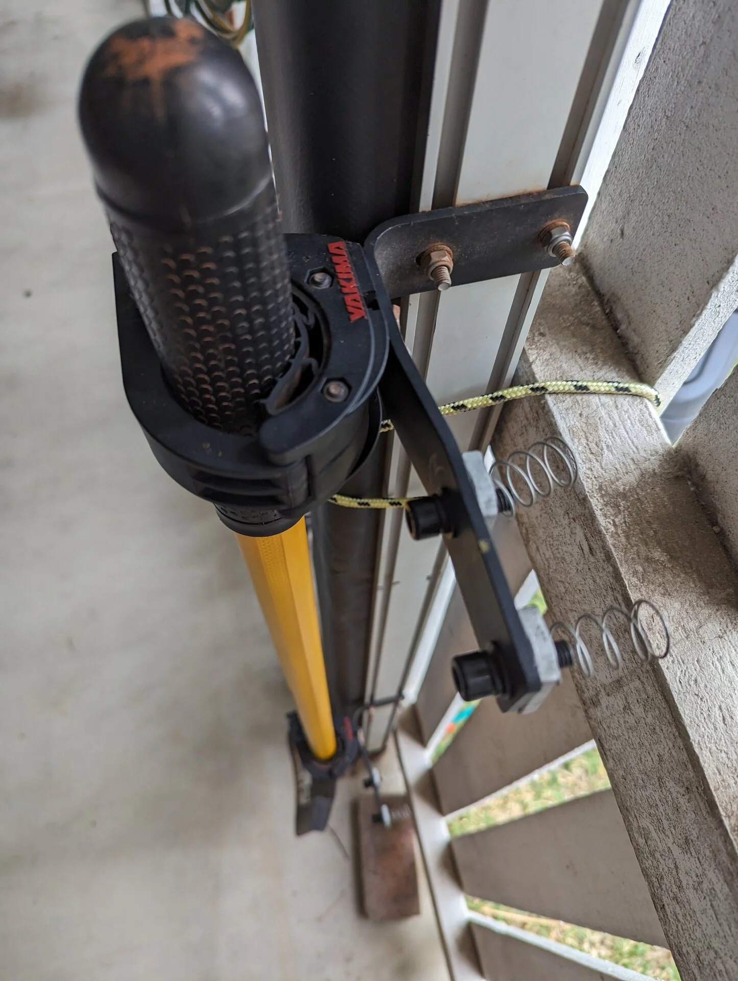

It takes me 5 minutes to attach or remove the awning with 4 x hex screws, and the Yakima AceO'Spades are bolted onto the awning brackets.
