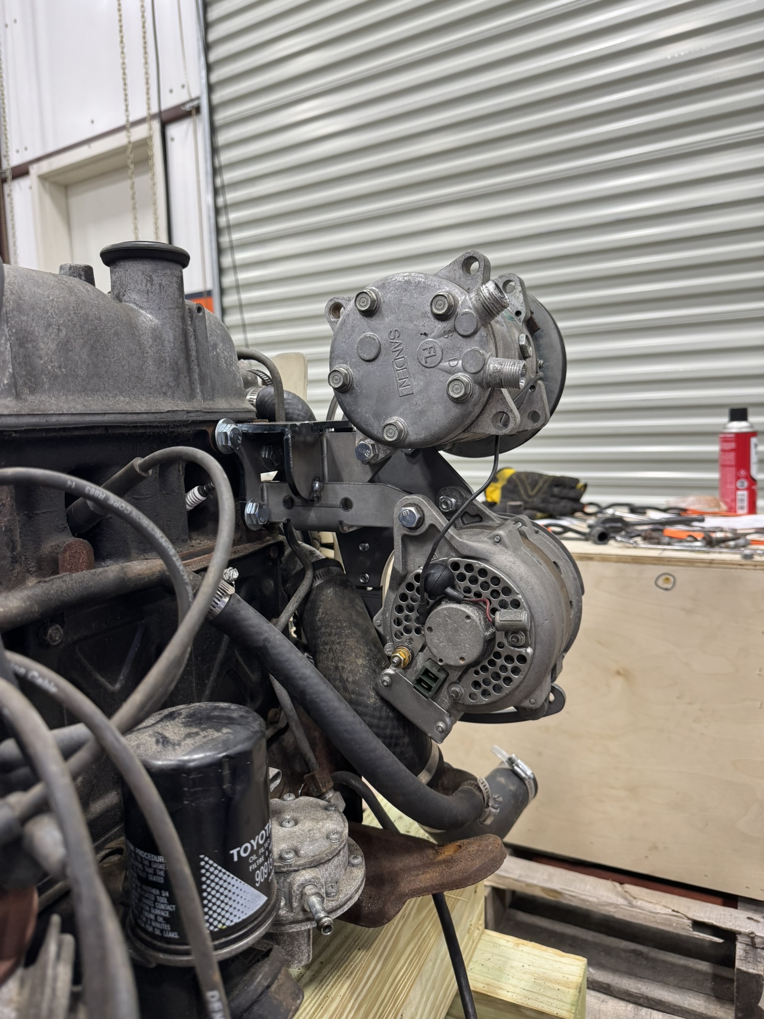

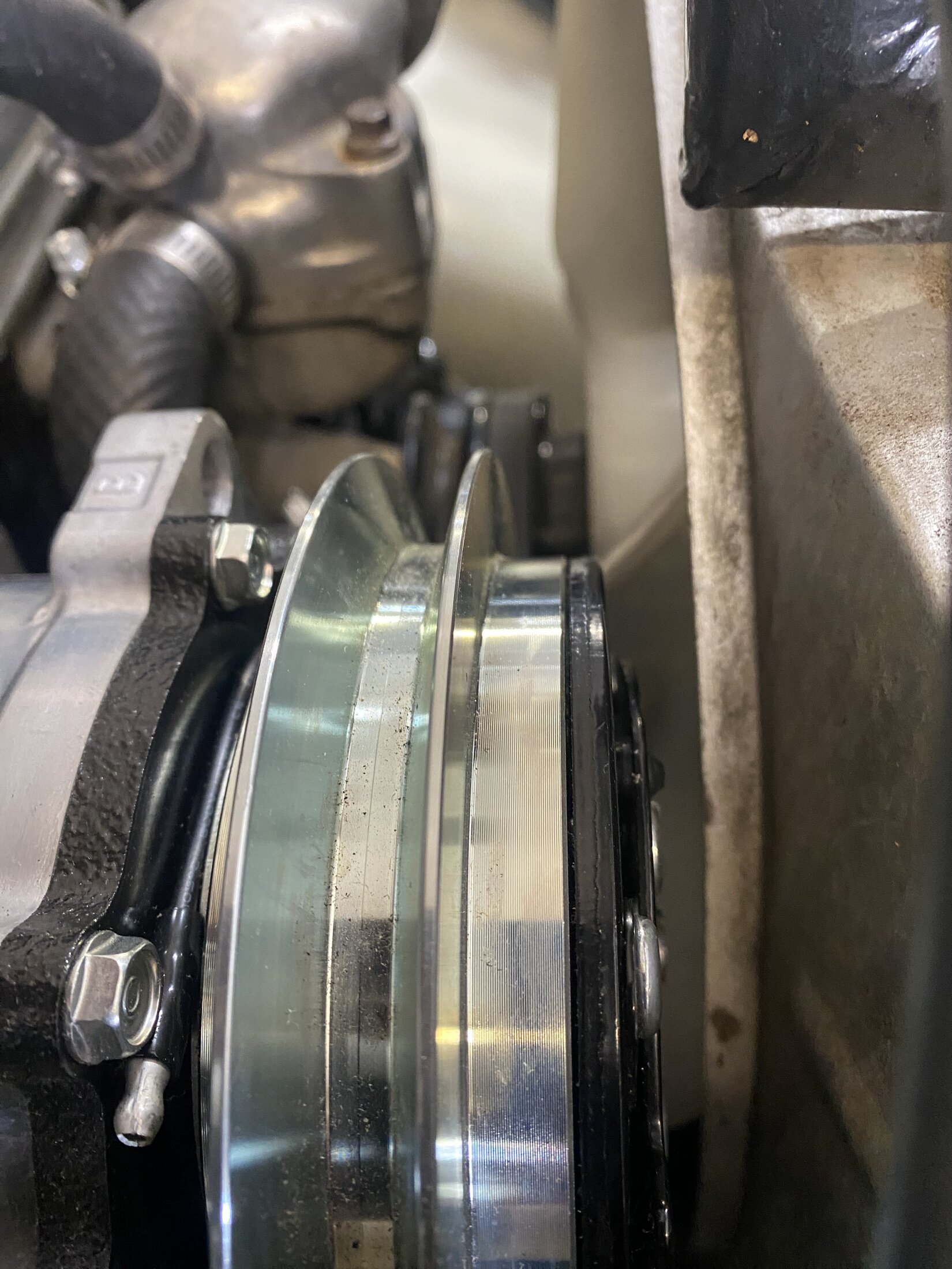

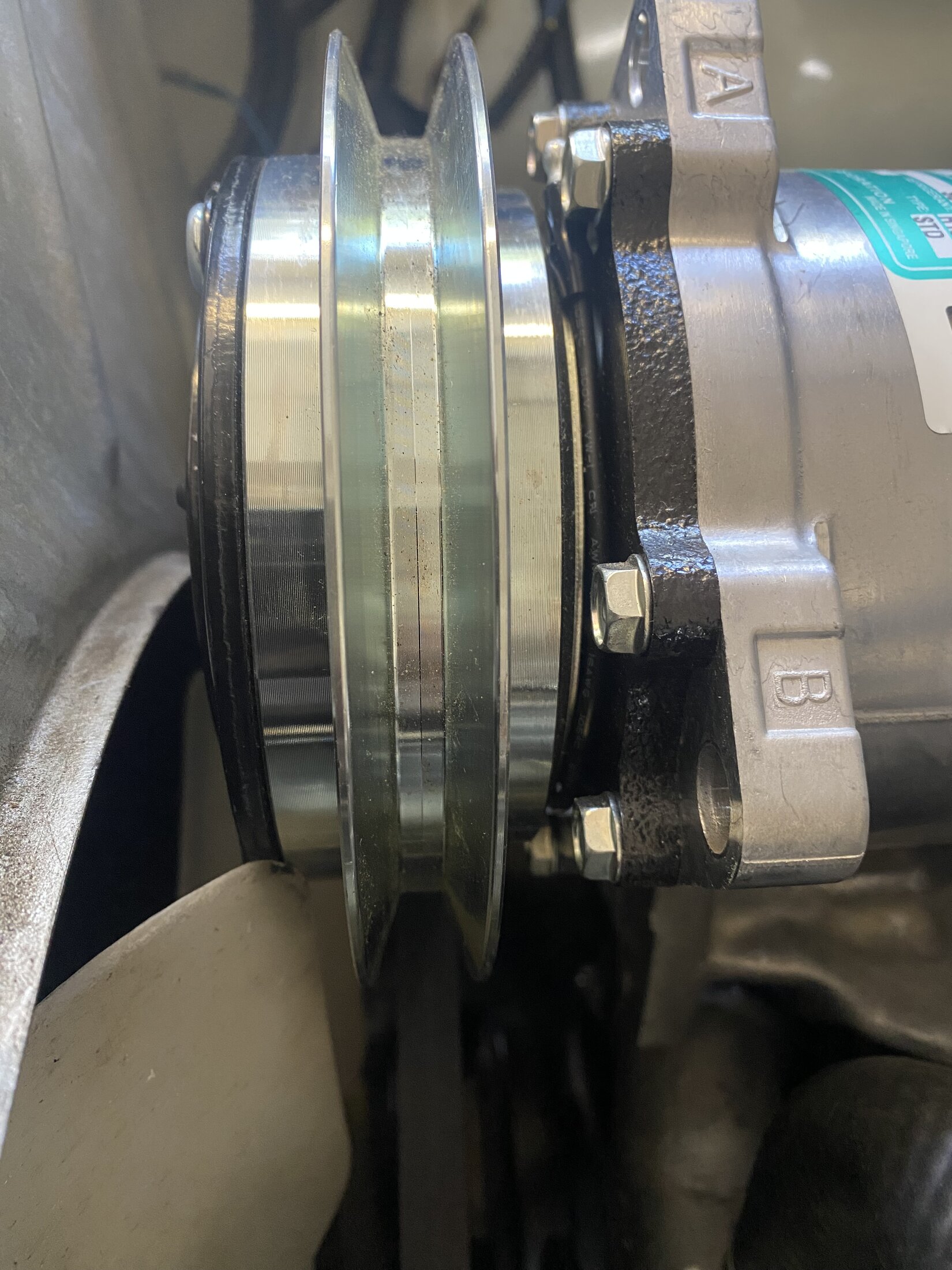

The compressor was the only one with a large V grove pulley, that was at a reasonable price, ( might be others) Iam not sure. I’ve been told 90 degree angle it’s ok, I need to verify.

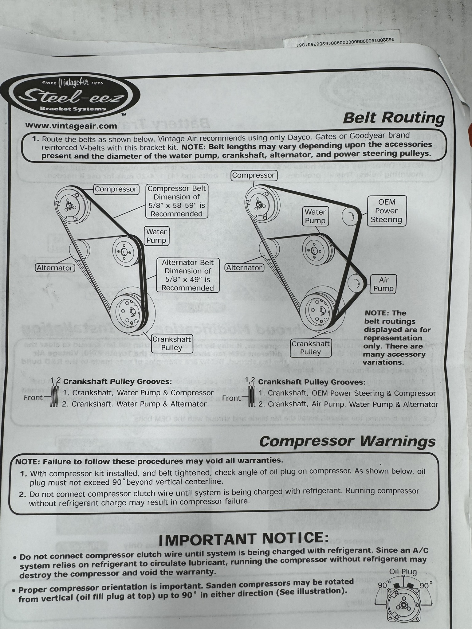

According to the Sanden Compressor information on the Vintage Air site, you can go up to 90 degrees from vertical but no further. Looks like you are okay but hard to verify from the photo.

Edit: This bracket looks totally homemade but I'm no expert:
That's an early VA bracket.

Those VA brackets come in two flavors, OEM alternator or GM alternator. Not sure which one that is. Just FYI.

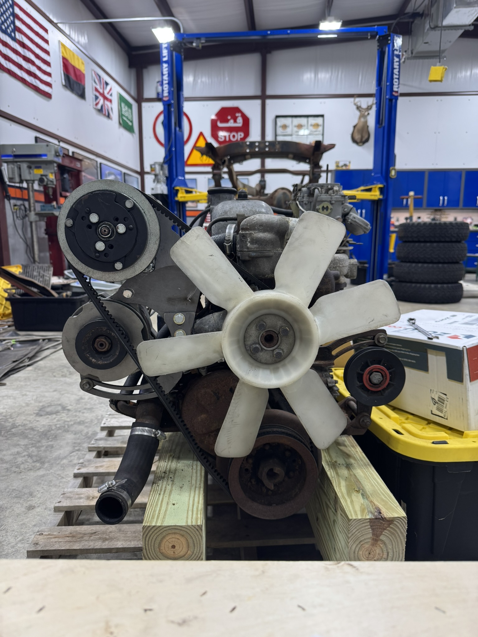

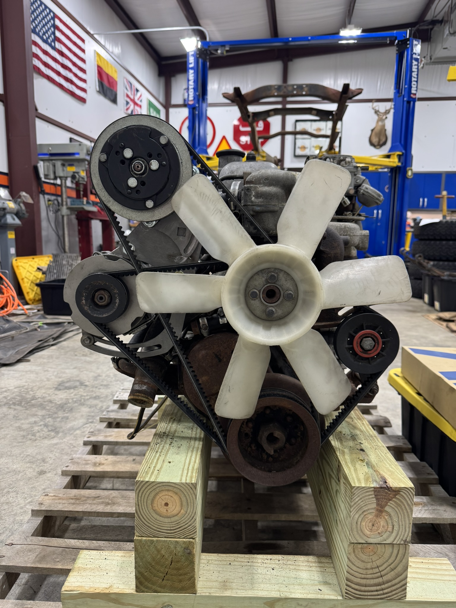

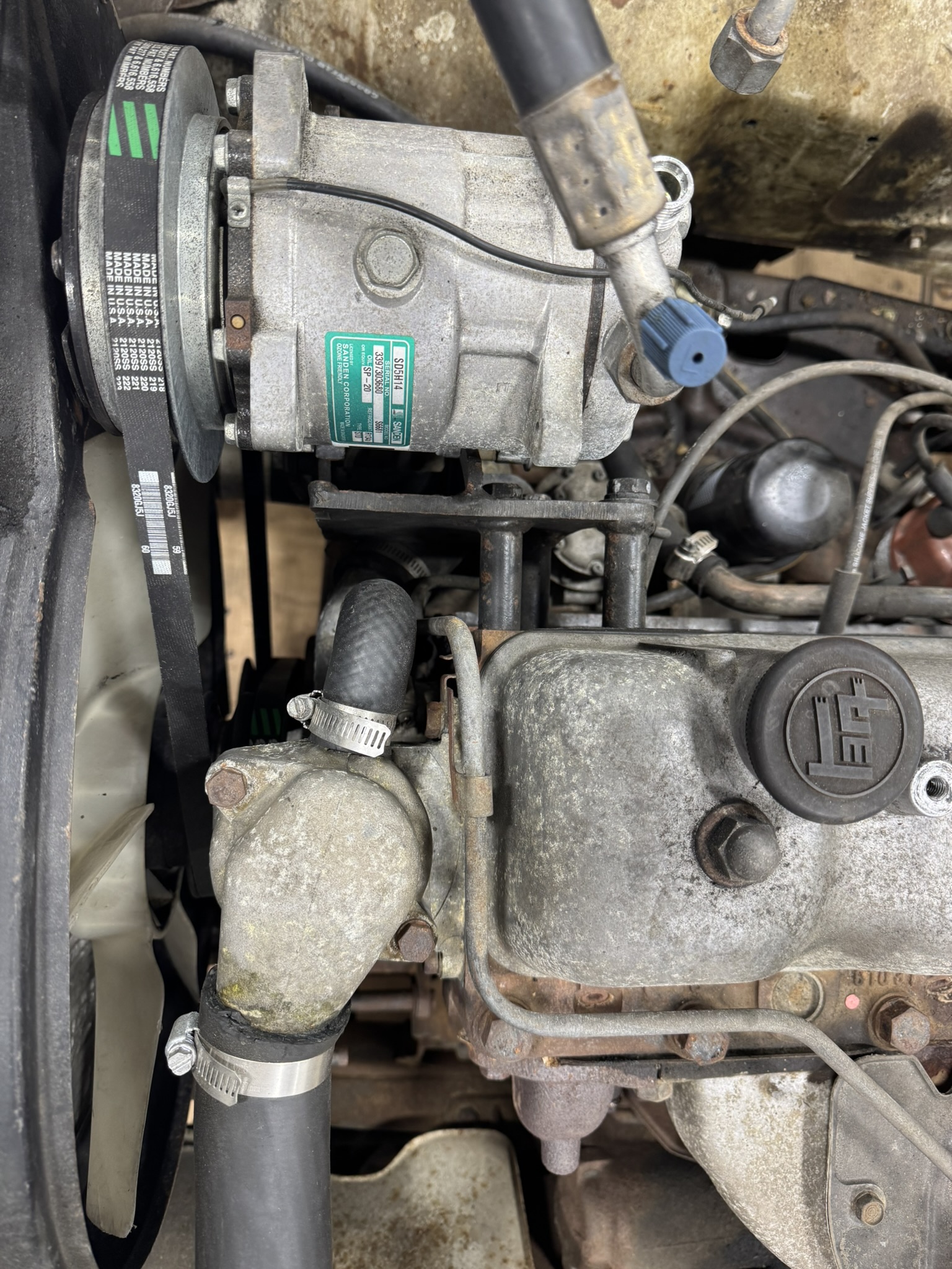

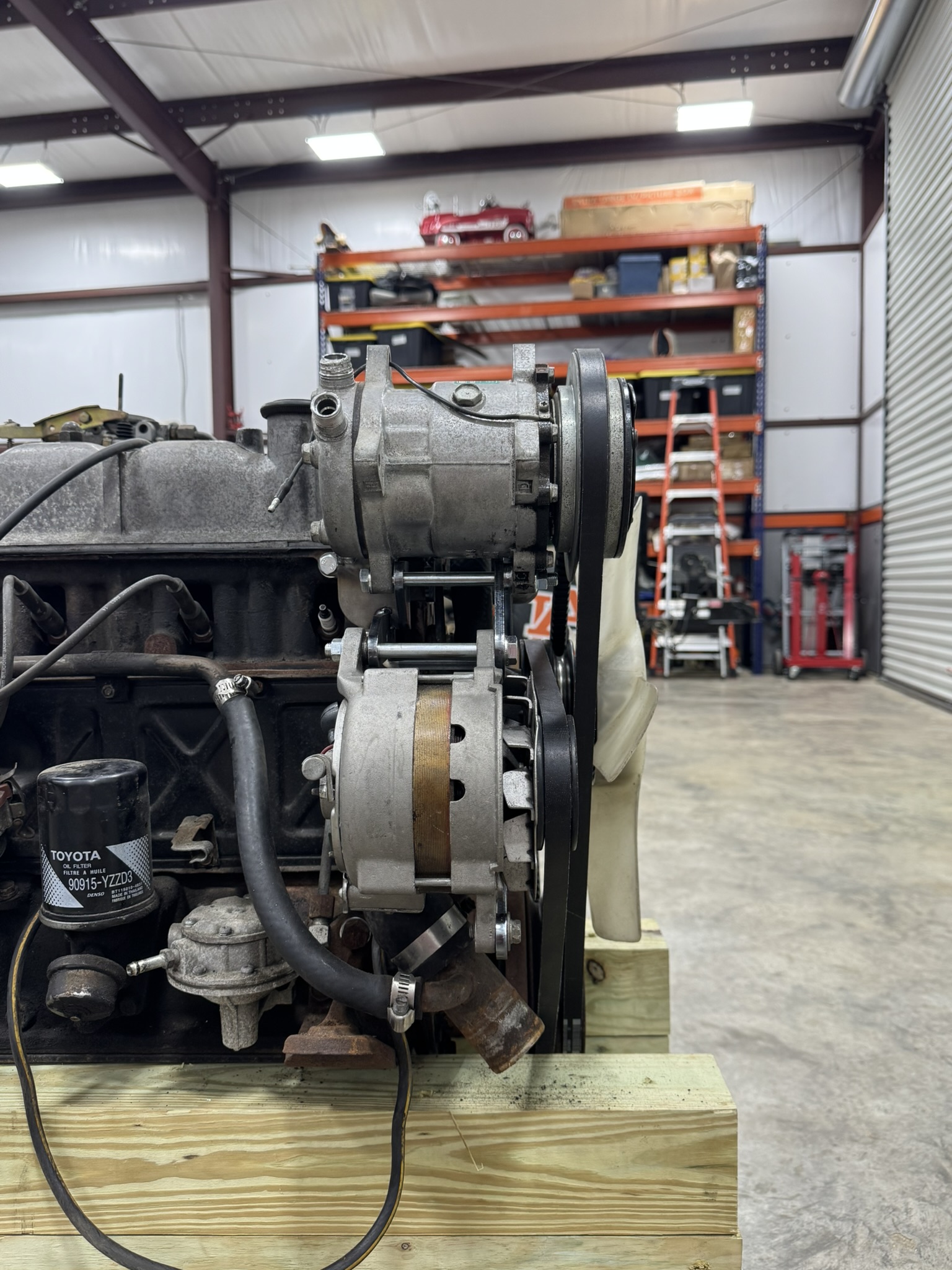

Decided to order the Vintage Air bracket that I linked above. Installed it this morning and I am much happier with the fit, look, and belt configuration. The earlier version VA bracket (according to @samc2447) is a veritable beast of a bracket compared to the new one (see side by side photo). It goes all the way down to the top bolt of the front engine mount.
One big upside to me is the new bracket allows the alternator and A/C compressor to run on separate belts. With the previous bracket they were running on the same belt and I was getting slippage on the alternator pulley. I think most of that issue had more to do with the belt only seeing a small part of the pulley than the fact that they were on the same belt but, regardless, now the belt will wrap around about 2/3 of the alternator pulley.
The A/C compressor belt will run around the crankshaft pulley, the water pump and the compressor, just as shown on the VA suggested diagram. The alternator belt will run around the crankshaft pulley, an idler pulley (where VA shows the Air Pump), the water pump, and the alternator. I could potentially eliminate the idler pulley and run a shorter belt but it looks like I need to run the alternator all the way out on the adjustment to avoid the main bottom radiator hose. Running the idler pulley allows me to change belts and tension without messing with that hose.

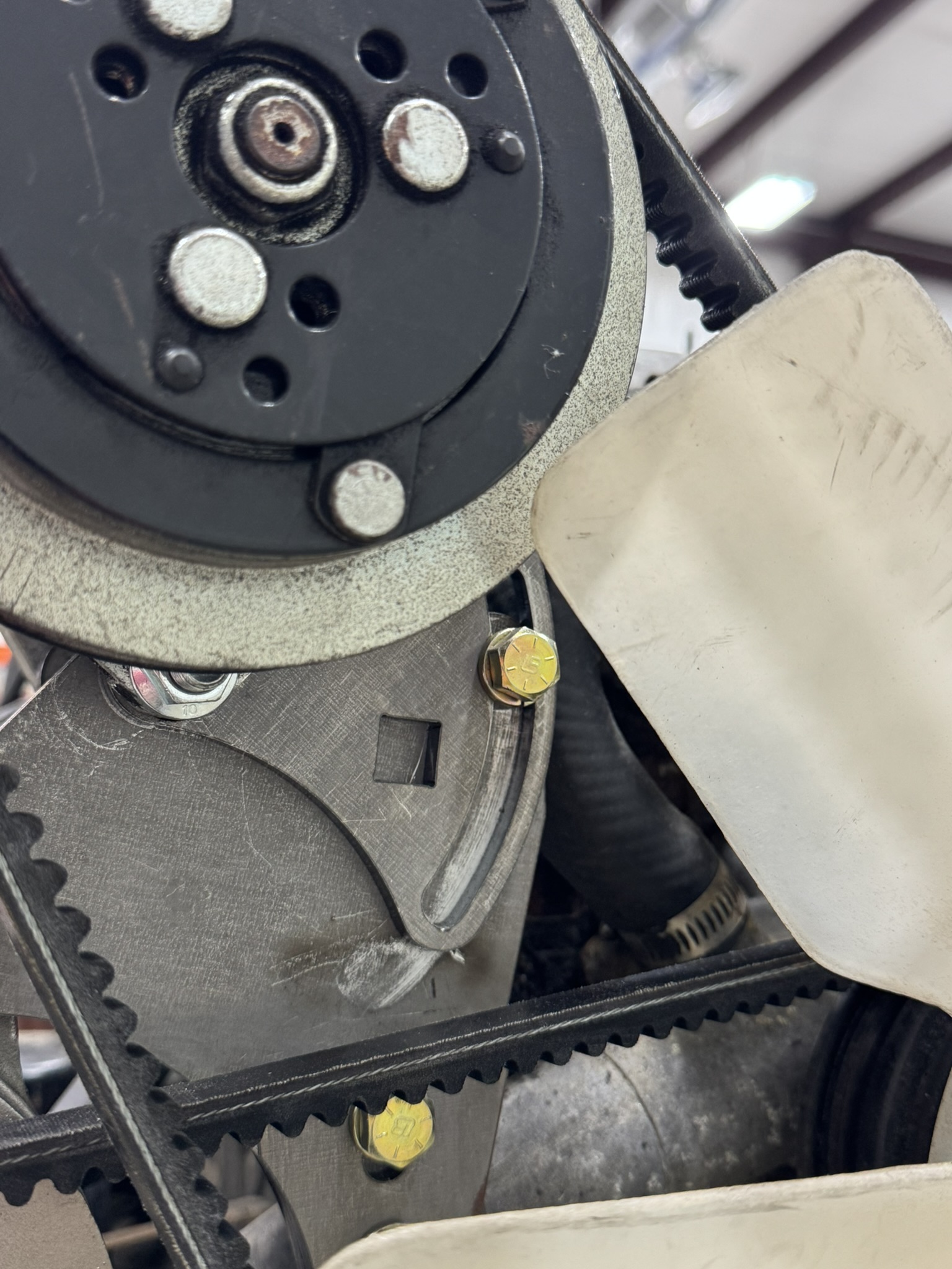

One minor concern is the A/C pulley is not in exact alignment with the crankshaft and water pump pulleys. That's probably down to manufacturing tolerances of the bracket and it can probably be tweaked slightly to shift the backside of the compressor over a tad. Not sure it will cause any issue as is though. That's also not the correct length belt and I was just pushing in on it with my foot to take the photo. I doubt the correct belt, properly tensioned will help with the alignment but there is probably some wiggle room in the bolts/bracket holes.
All in all I'm pretty pleased with the bracket. Needs to be painted or powder coated black but that's pretty easy to take care of. Pretty sure it's cut out of stainless so rust won't be an issue regardless.

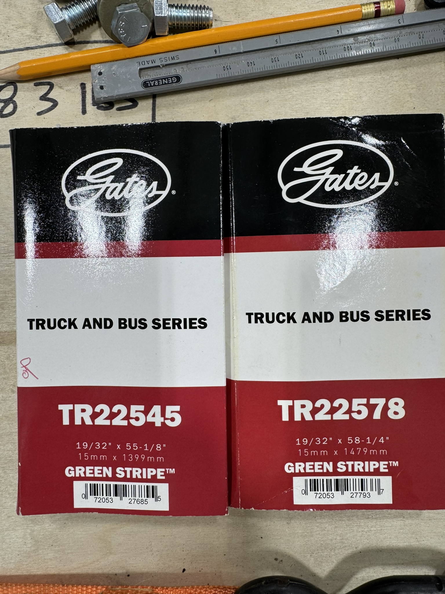

I looked up a '77 FJ55 alternator belt and cross referenced that to Gates. It showed a belt with a 15A section, 15mm top width, and 40 degree angle. I then measured the outside diameter of both using a 59" belt (with that same specification) that I had previously used but was now too long with the new bracket. I ordered the two belts below with the longer one for the A/C compressor. The alternator is perfect but I need something just a bit longer for the compressor. I have just enough clearance for the original 6 blade fan but I want to chance to the OEM "with cooling option" 8 blade fan. Unfortunately it's 3/4" diameter larger so I need to gain another 3/8". There's plenty of adjustment left in the A/C. Just need to find a belt between 58 1/4" and 59". Gates doesn't show one with that same cross section but maybe someone else makes one.
The VA bracket leaves a lot to be desired, and the SAE hardware drives me insane. Fitting the belts is normally never as easy as the ones they list. Those get you in the right range, but download the Gates catalog which has all their belt sizes listed. It's been a while but the green stripes are typically available in the sizes you need.

I've been through the Gates catalogue. The TR22588 59 3/8" fits "just right" with the compressor adjustment swung all the way out but unfortunately with very little tension. When you look at their catalogue, the exact OD of the TR22578 58 1/4" is 58.31 and the OD of the 59 3/8" is 59.48. Thinking something around 59" OD exactly would give enough clearance and enough tension.

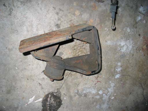

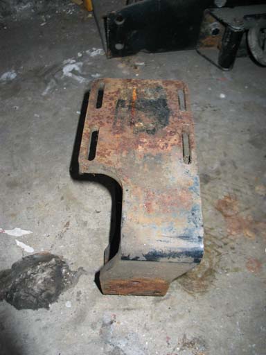

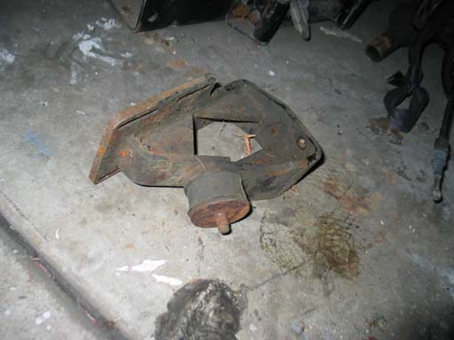

here you go...
this is the mount from 7/'70 to about 4/'75... takes the place of the righthand cast motor mount.... the slotted grooves are what the stock compressor mounts to and adjusts belt tension with. the stock early compressor is *like* a slightly smaller version of the york found on the aftermarket fj55 ac setups...

I have the same on RHD fj56 and rare compressor with 2 inline stroke with pistons. I thought it handmade mount - thank you . As I see compressor mount horizontally. Will try to install it.
