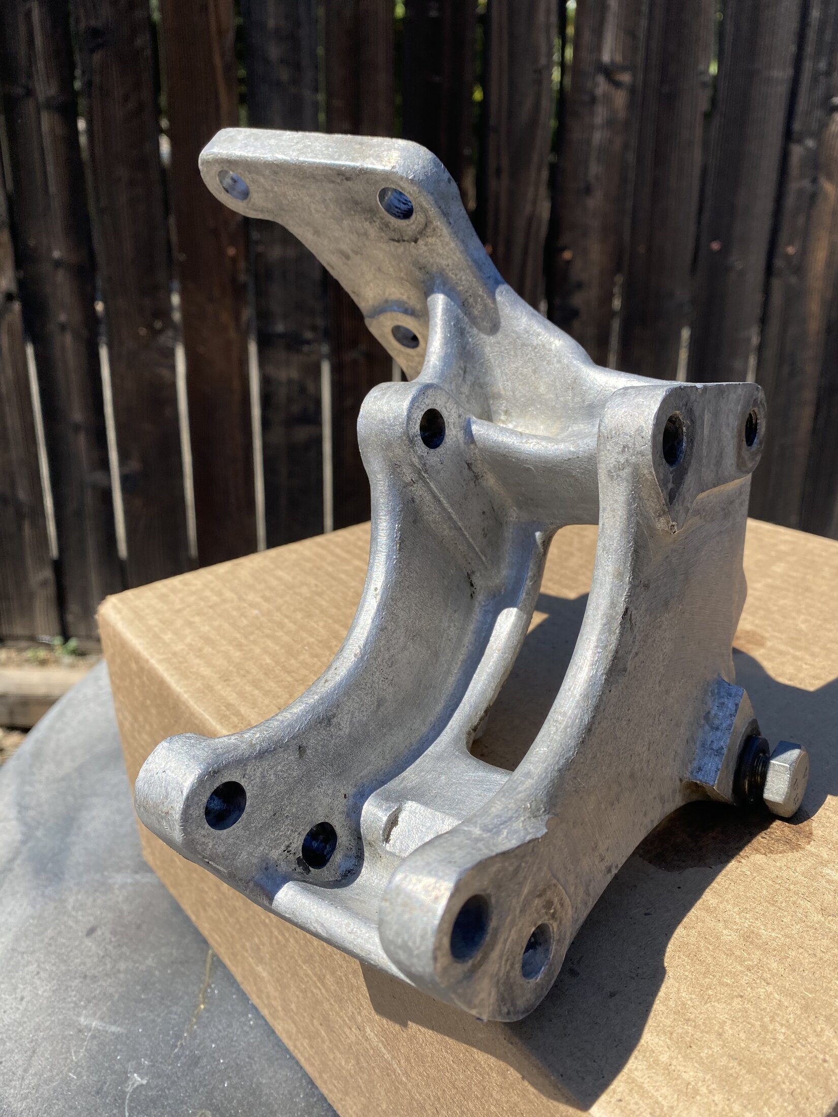

Thanks Brett. Based on our conversations I am more than likely sticking to what I have. The only real issue I have with my current compressor set up are aesthetics. I did find this mount that doesn't look quite so home brew but not exactly sure how it would work.

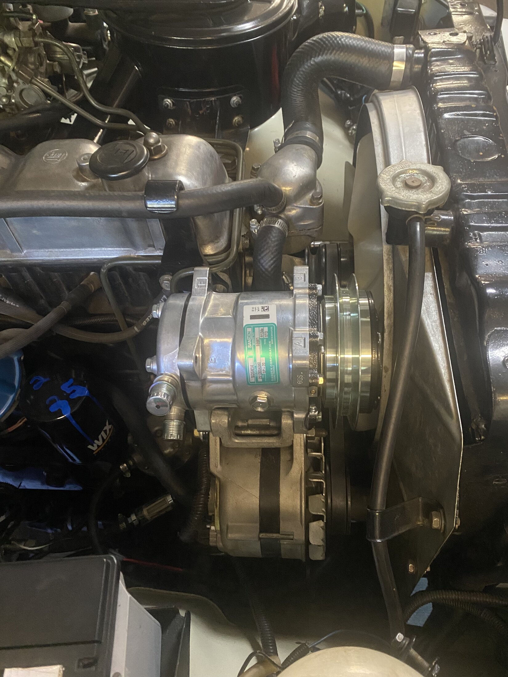

This is my setup that Iam doing now on a 2F, only issue so far is the fan hits the pump just an about 1/4 inch going to put a spacer in the fan or change the fan, I thought about the FJ60 setup but did not want to change the harmonic pulley,

Looks nice. For those of us that don't have our brackets memorized.........what is it?
Also, when you say "...the fan hits the pump.."; are you talking about the AC compressor? I assume you aren't talking about the water pump.
Yes the AC pump it hits just a little bit on the back side end of the fan, I may trim the back side of the fan on the edge. Also not sure of maker of bracket, But I do have a different bracket that vintage air sales never used see pic

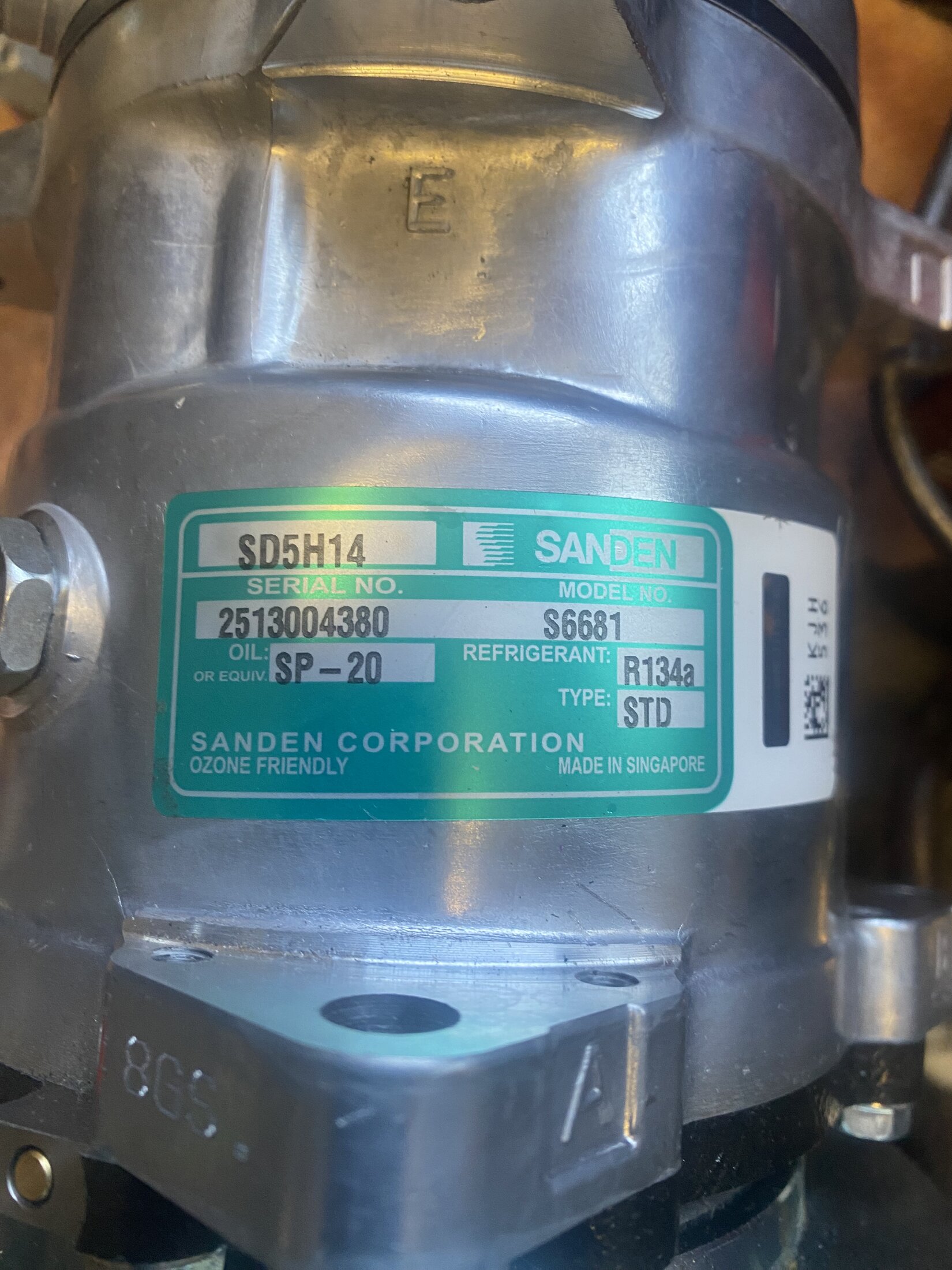

Another question please. I have the exact same Sanden compressor on my 2F. Unfortunately whoever installed it for the PO over torqued one of the hose fittings and I basically destroyed the female fitting (compressor side) removing the hose. I assume I will need a new compressor. Not the end of the world but I do want to make sure I make the optimal choice.
So with that preamble, how did you select this compressor?
FWIW, yours is rotated 90 degrees from mine. Mine is mounted with the hose fittings on the top. I like your orientation better.

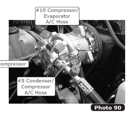

Your compressor was mounted wrong it should be rotated like the one above. Here's the photo from the VA install instructions. Probably why they struggled with the #10 hose and stripped it.
2 options to fix it. New compressor, they aren't that expensive. Replace the rear part of the case. If you go that route, lmk I may have an old one I can send you.

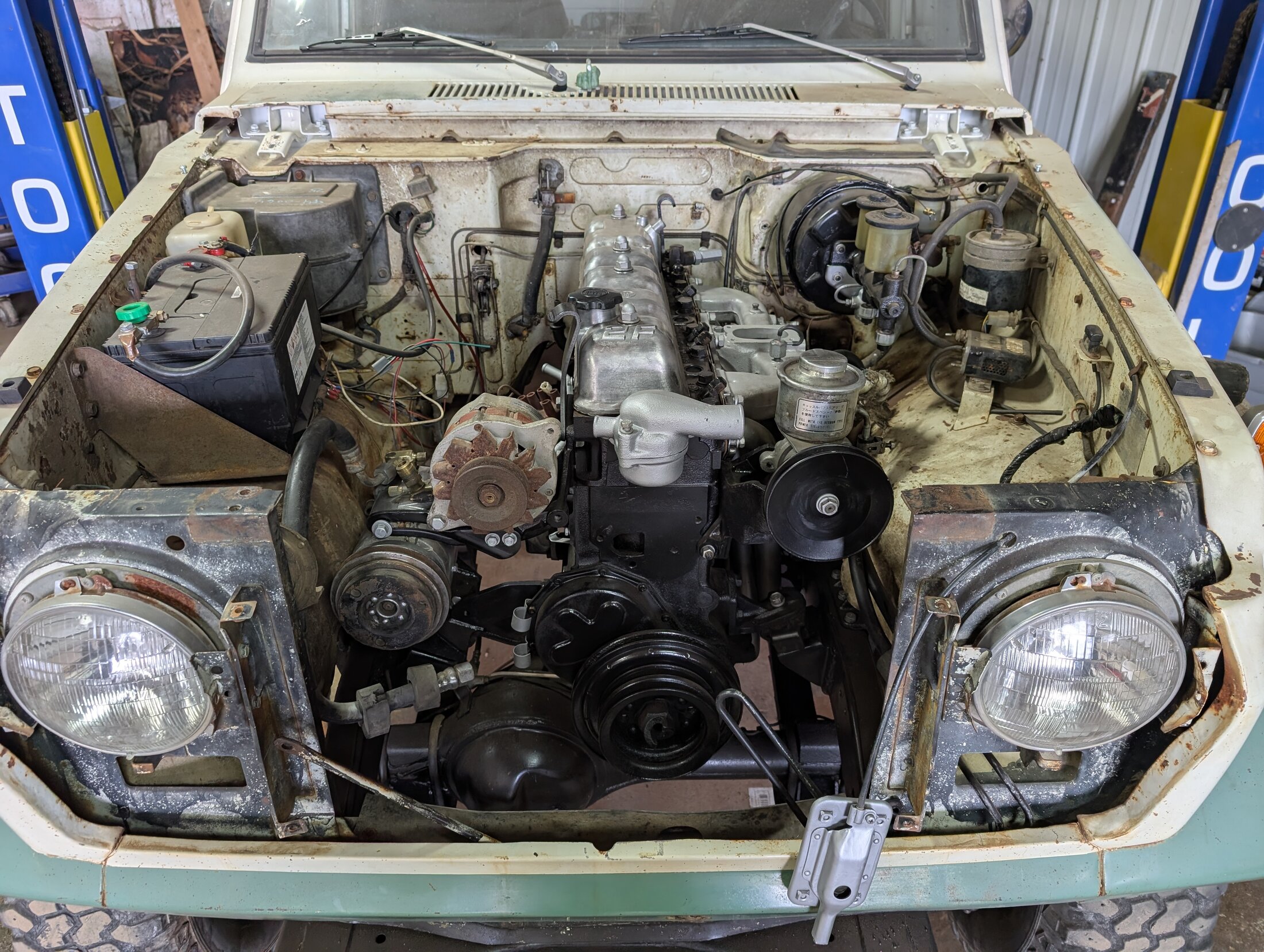

My major issue with the existing compressor and bracket is that it just didn't look like they belonged on the engine or at minimum were just thrown on there as an after thought (which they were). Rotating the compressor will help somewhat as it will move the hoses from their awkward position right up against the hood. The bracket is still clearly homebrew though. Would be great to find a better solution.
I agree the VA bracket leaves a lot to be desired. The issue is that early 2F blocks don't have all the mounting provisions like the later ones. If' you're getting Cam to rebuild it, get him to use a late 2F block and you could use the 60 brackets and go with a stock 60 style setup. You would need a later 3 groove harmonic balancer too.

Edit: This bracket looks totally homemade but I'm no expert:
