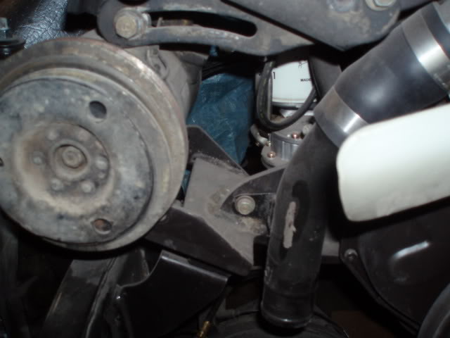

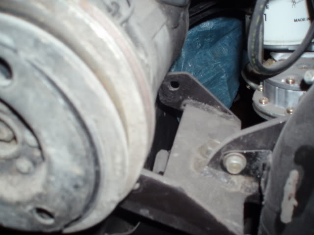

This help its a 10/78 '
......Dusty
wow that is nothing like I thought it would be. Is that bracket the same as what would be on a 60 series?
I'll have to check with my Toyoya Guy and see if that bracket is still avalable.
Anyone have these brackets they want to unload?
you dont need one of those brackets. that one pictured is for FJ55 with A.C only, from mid 75 till the end of 78. the compressor that fits it is obsolete, and I doubt you will find a another compressor to fit it...
I would use the Fj60 motor mount, and an FJ60 compressor... it will be easier.
the early(7/'70-mid 75) compressor bracket will be easier to mount another compressor to, since its got a flat plate mounted to it above where the motormount isolator bolts to it... I made a flat plate to hold a sanden 508 on my OEM A\C install...

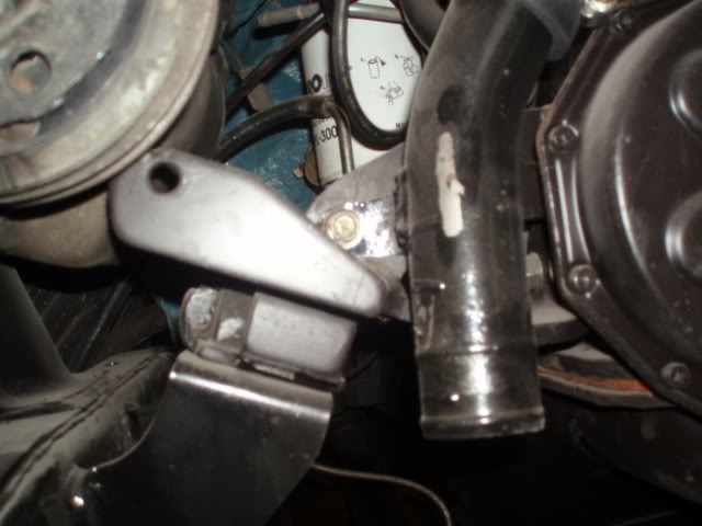

Have any pics of that there mount?
here you go...
this is the mount from 7/'70 to about 4/'75... takes the place of the righthand cast motor mount.... the slotted grooves are what the stock compressor mounts to and adjusts belt tension with. the stock early compressor is *like* a slightly smaller version of the york found on the aftermarket fj55 ac setups...
