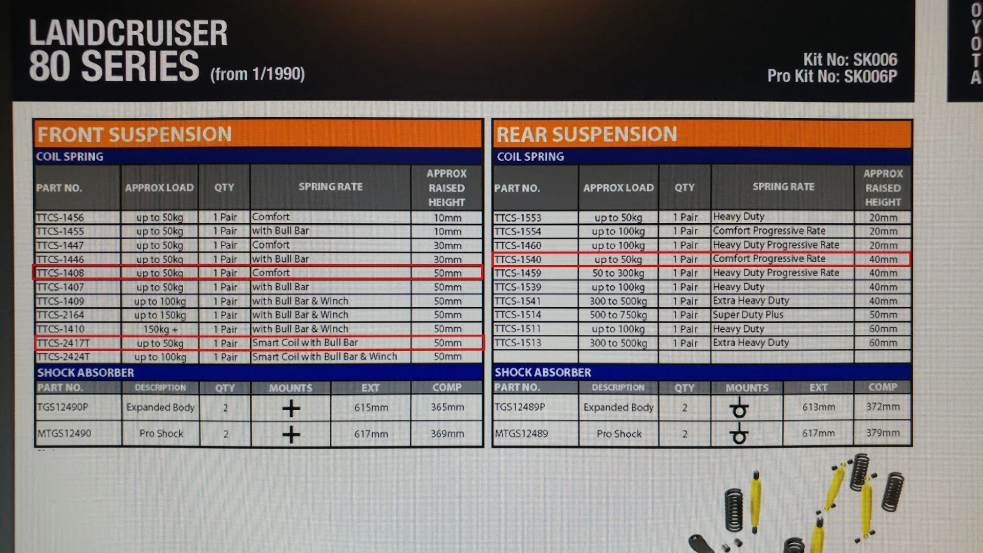

Not sure if the attached file will show properly, but TT offers a 50mm lift in several versions, all designed to provide 50mm of lift with the load as shown, so for you, you want the lowest weight to make sure you stay close to the advertised number. less load on a higher rate spring will give you more lift than advertised. Also less load on a high rate spring will ride like garbage because the spring never really gets to it's sweet spot.
