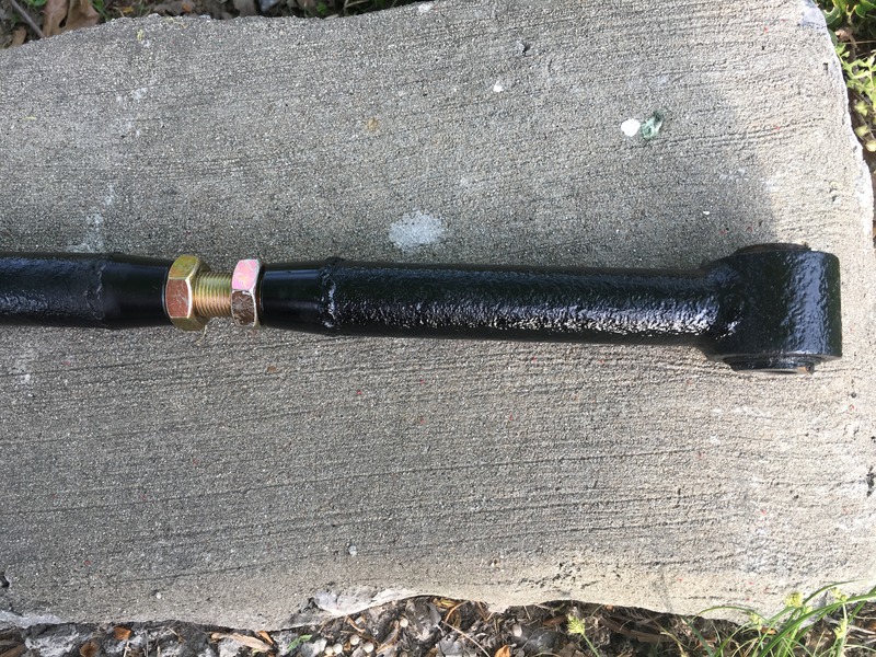

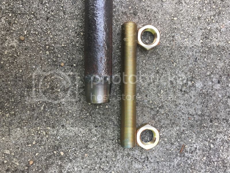

I made an adjustable rear panhard bar today for my LX. When I bought it, there was an OME lift (springs/shocks), but the stock panhard bars are still on there. I found an old thread here on Mud where a guy bought parts of McMaster-Carr and made his stock bar adjustable. If anyone would like a write-up or the parts I used feel free to ask.
Cut the bar in half and welded on some threaded adapters and ran a 6" piece of 3/4 bolt with nuts. Pretty easy and total cost was $40 vs. ~$225 for an aftermarket adjustable panhard. Now I just need to figure out how to do the front bar (solid link, not hollow like rear).
