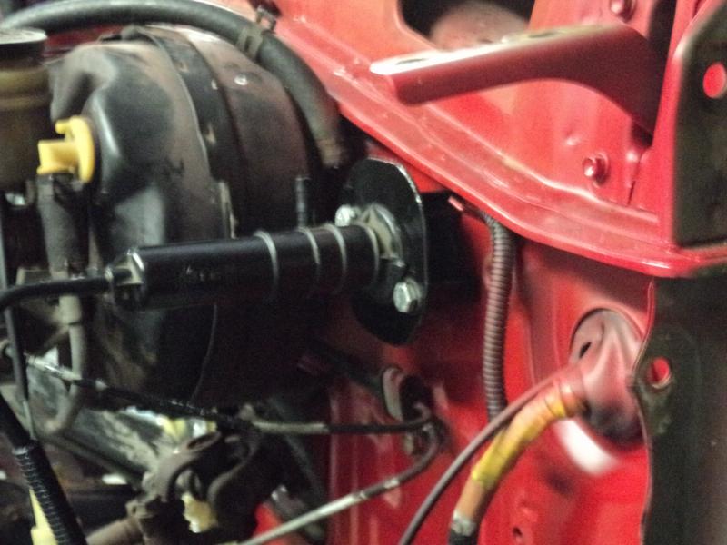

Ive got the hydraulic slave/master from the dodge I got the trans out of, it works well in my 80, was a single piece, but I had to build a bracket to mount it to the firewall as the master is kind of a twist in fitting, if this helps.

Its just the clutch/hydraulic/slave out of a 97ish dodge truck. Comes as one piece, but doesnt have the mount to attach it to the firewall, you have to cut that out or build one like I did. There's some pics of it in a thread (cody's white 80 rebuild) in the 80 series section.

I "used" Cody's setup and just made a bracket for the dodge master and slave. The bigeest hurdle is figuring the throw of the pedal and making your bracket set off the firewall the right amount to get decent pedal travel. I couldn't find an easier way to make a new line so I just didn't fool with the existing one. Turns out it has some pretty accurate bends in it that fit the fj firewall ok.
I ended up mounting the resevoir for the master on the plate that covers the wiper motor stuff just above the master.

Stevo, my clutch hydraulic system was purchased from Scott @ TN Diesel Conversions. AFAIK, it's a superduty master with a stock Dodge NV slave, with a custom line. I'll try to take a couple of pictures later today.
the hydraulic hose has kind of a quick connect style end, it pushes in to the housings(s) has a rubber ring, and is held in by a pin that slides through the master or slave. The hose has a groove or notch in it and the pin sits in the notch to keep the hose from coming out.

I think for the pedal travel, I will try and match the length of the rod to the stock configuration to see if that nets me enough travel. If not I will adjust it accordingly.
Thanks Johnny, pictures are always good. Thats pretty much how my setup will be except my master is out of a E-350.
