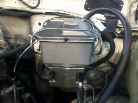

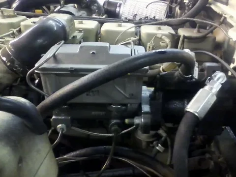

After work I popped by advanced auto again, and this time grabbed a MC from a 1 ton chevrolet van. 1 1/4" bore, with normal SAE fittings.
Got it installed and bench bled and immediately noticed a difference in pedal feel.
I turned on the motor to get the hydroboost helping out and soon found I had a leaky fitting which I tightened up.
Tomorrow I have a buddy coming over to help me bleed all the air out of the brakes and the hydroboost system. Should be able to drive it tomorrow.:D
New Master:
