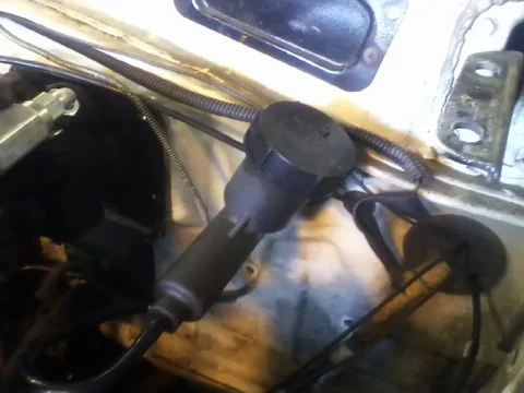

Well here are some updates and whatnot, I never posted how I managed to get the clutch to work so here is the info.

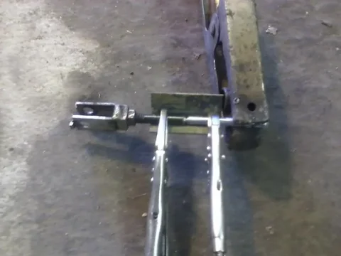

I installed the new clutch master from a 2000 ford truck, conveniently it bolted right in place of the stock toyota master cylinder. All i needed to do was pull the top stud off of the ford master and drill it out. Once that was done it bolted right in the stock locations, I was even able to reuse the stock nut off of the toyota master because the ford master had metric threaded studs on it. Its not exactly straight up and down, but it still does moves fluid the way its supposed to so I don't care too much.
I also cut and welded the stock toyota pushrod to the one for the ford so I guess it isn't exactly a drop in thing.

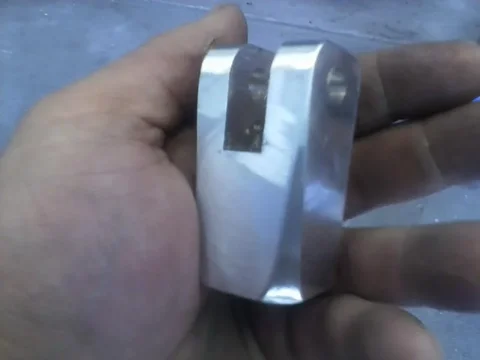

After doing this though I realized that I did not get enough adjustment out of the stock pushrod fitting so I took a trip to the machine shop I used to work at and machined a new end piece out of some scrap 7075 aircraft grade aluminum.
I sure do miss making chips, but its nice that they still let me use the shop when I need to.

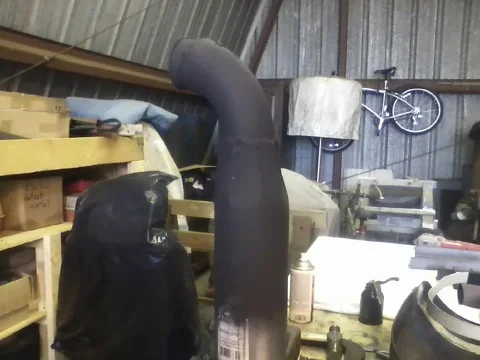

Also tonight I decided to spend a little time in the shop after work.
I welded up the downpipe for my exhaust. I just need to pick up some 4" exhaust pipe and I can convert it from 2.5" ID at the turbo to 4" right after it turns down. Then dump it right out under the passenger door.

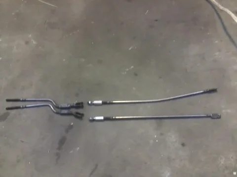

And since the welder was getting along pretty nice with me tonight I decided to do the linkages for the transfer case. They turned out pretty good. I had picked up some 1/2" round stock from mcmaster a while back and some 1/2" - 20 threaded rod. I made tabs for the linkages to attach to the transfer case and I have heims on the bottoms of the shifters so I just needed to measure them out and weld on some threaded rod stock.
Here is what I came up with.
Tomorrow after work I will get some paint on them along with the shifter for the transmission and get them fully installed as well as the covers for them.
Stevo, that looks to be the same clutch MC I used. Instead of drilling out the MC to slide over the stud ( probably a better idea than what I did ) I cut / pounded out the stud so that I could use two bolts like was intended for that MC.
Does your slave have a bleeder screw on it? My slave does not and therefore I can't come up with a good bleeding method. What did you do?
What did you mean that you couldn't get enough adjustment out of the stock clevis? What was your symptom and how did that custom clevis fix it?
My master / slave were given to me assembled and somewhat bench bled.
The slave I got with the transmission has a bleed screw. Sorry I couldn't help with that.
And the slave needed more pedal travel so even maxed out that MC clevis didn't allow for it.

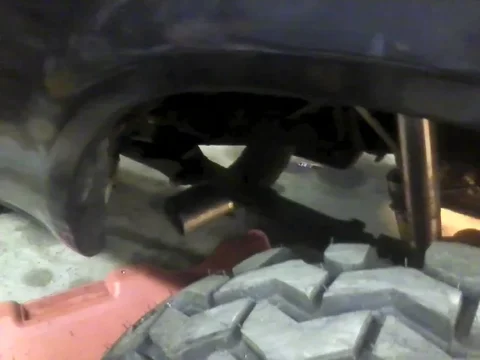

I spent some more time in the shop and made up an exhaust system for the truck.

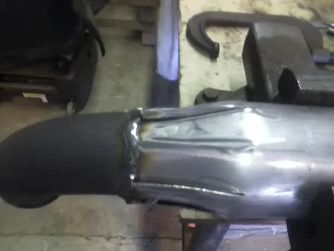

I didn't want to spend a bunch of money on it so I went to a local exhaust shop and bought some 4" pipe and a 90 degree elbow. I was looking to find a adapter to go from 2.5" ID to 4" ID but I could only find them for way too much money so I made my own.
Here is the adapter I made:
Painted up:
Elbow welded on:
I bought some exhaust heat wrap and managed to use up 50' on my 3' downpipe. Should keep the temps down.
Here it is installed:
The picture is pretty junky, but it shoots out right under the rear hanger for the front leaf packs, its fairly well protected and shouldn't get smashed up.

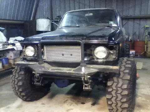

I got all of the lugs on it and started testing out what she has, I hit 28 pounds of boost, and I still haven't maxed out the pump and dialed it in.
Here are some more nice shots of her:

28lbs of boost!
Jebus.
You should paint the intercooler (I think thats what I'm seeing) black.
