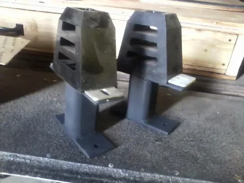

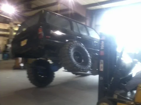

Bumpstops are installed to prevent the shocks from bottoming out, I did some flex testing too.
