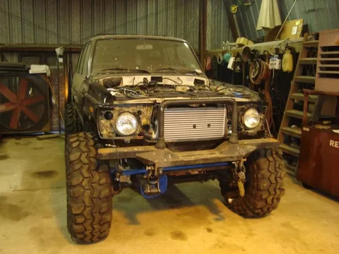

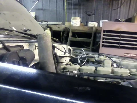

My buddy sent me some better pics of the truck, I figured I might as will post them to give myself some motivation.
Engine bay:
Exterior:

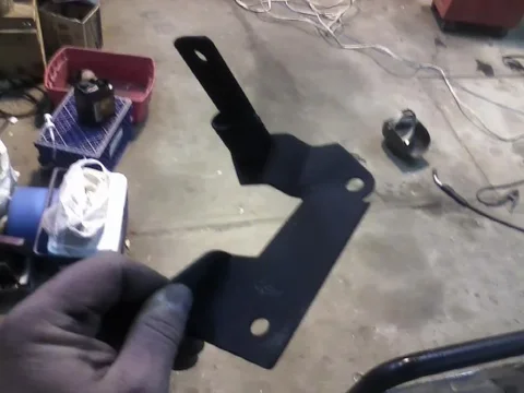

Here is a pic of the throttle linkage bracket I fabbed up.
