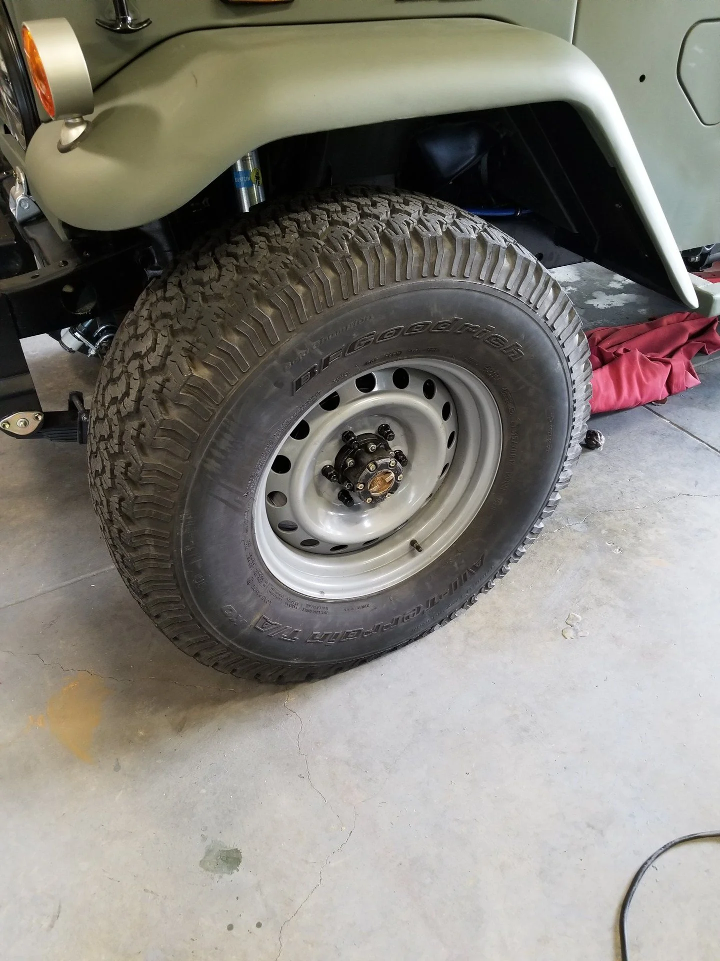

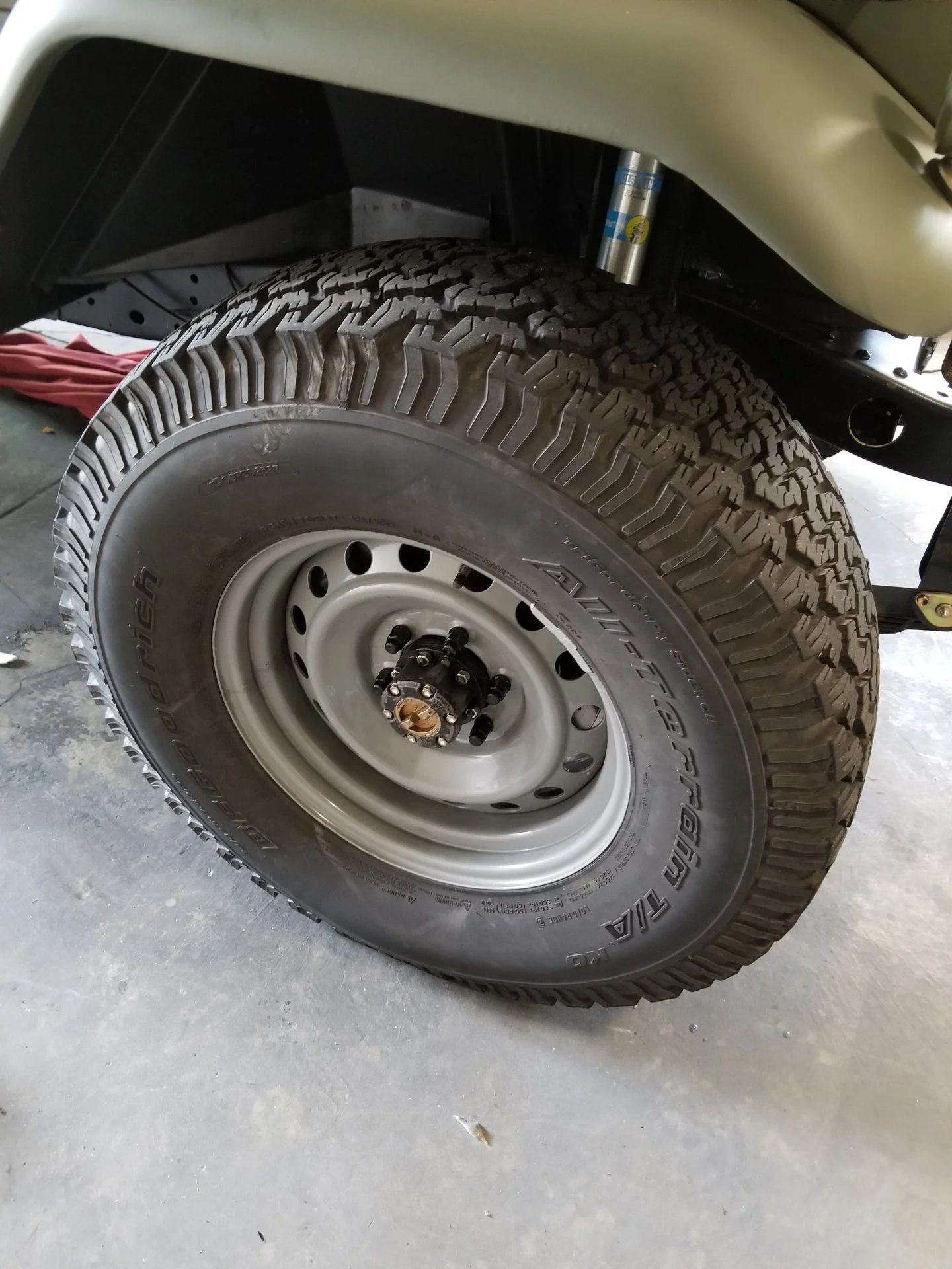

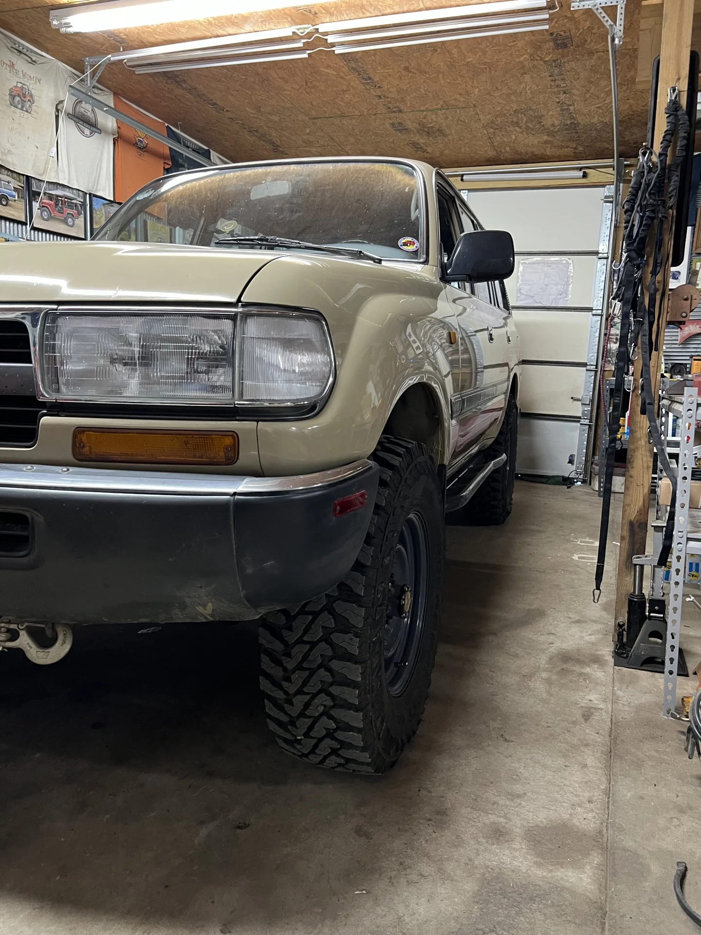

Thanks. Yeah, my understanding is that some people run spacers when using the 17" FJ Cruiser steel wheel on the 80 in order to push the wheels outboard a bit. I did not want to run spacers, and so, before I pulled the trigger, I verified with a few folks on the forum that the wheel would work as is, without spacers, which for me it does. One might run into some rubbing if running a wide tire, but there's plenty of room for 255s.

For what it’s worth, I’m running the same wheels with a 285 tire, with no rubbing issues. I also run without spacers.
I am
running the exact same setup, stock suspension height with no interference issues.
Yep. I have stock replacement OME springs with a 1” spacer in the front and airbags in the rear for fully loaded trips

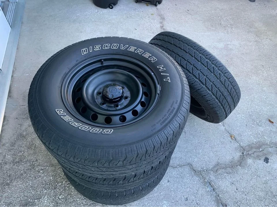

I have a set of 4 FJ Cruiser steel wheels and BFG 315 tires. The wheels are 6x 5.5 and roughly 4.7" backspacing. They are powder coated grey. Should fit Tacoma's, FJ cruiser, original FJs as well with a small spacer. Tires have good life left, but no idea on the actual mileage.
Mud Price $1050, located in San Rafael, California

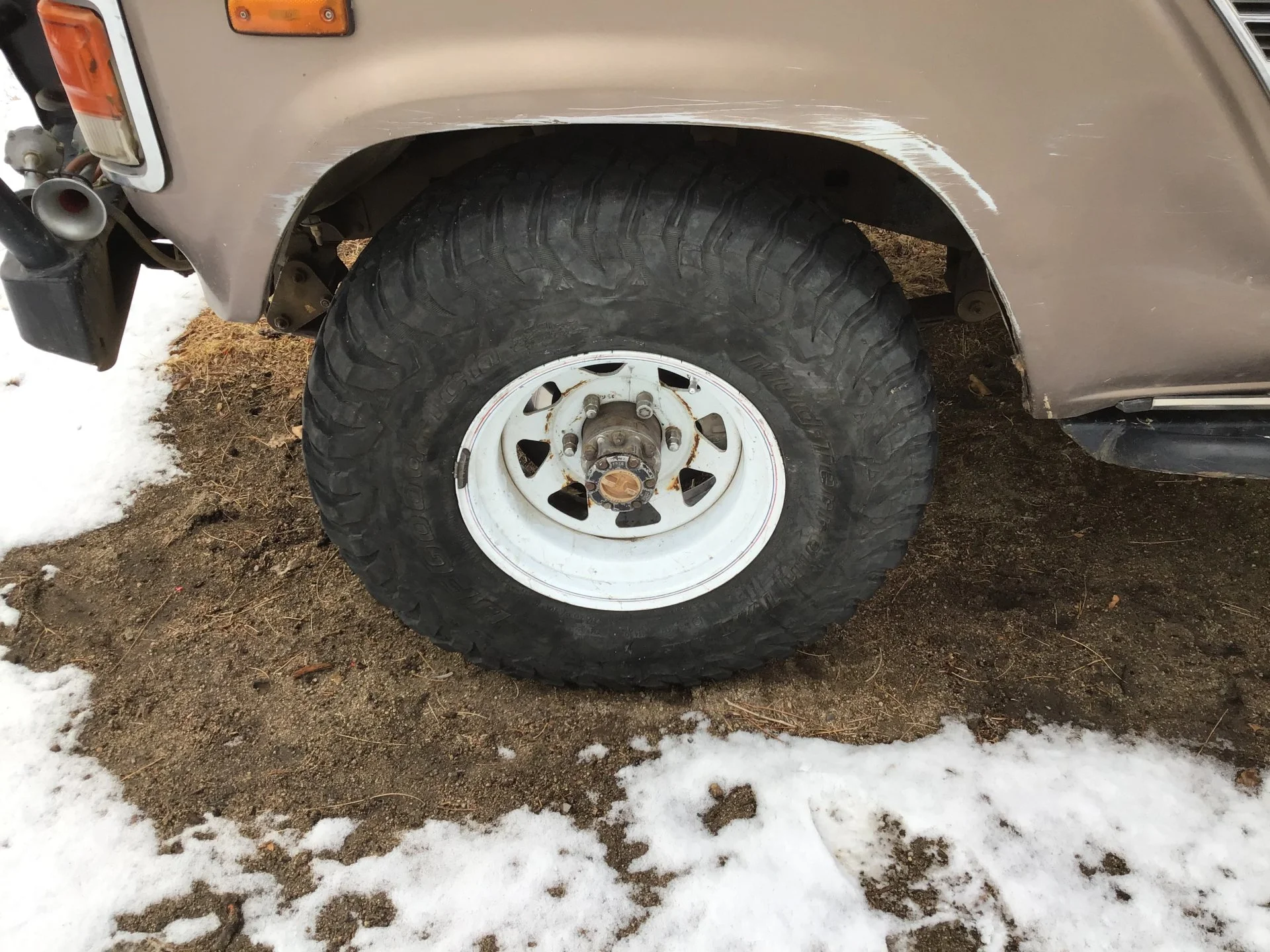

@4runner2FJ60 or anyone that might know, will the wheels you have referenced & have on your 55, fit on a stock FJ60 w/o using spacers?
I‘ve been running 33x10.5x15 for years but that size is becoming obsolete & harder to find. Thinking of moving up to 16 or 17’s.

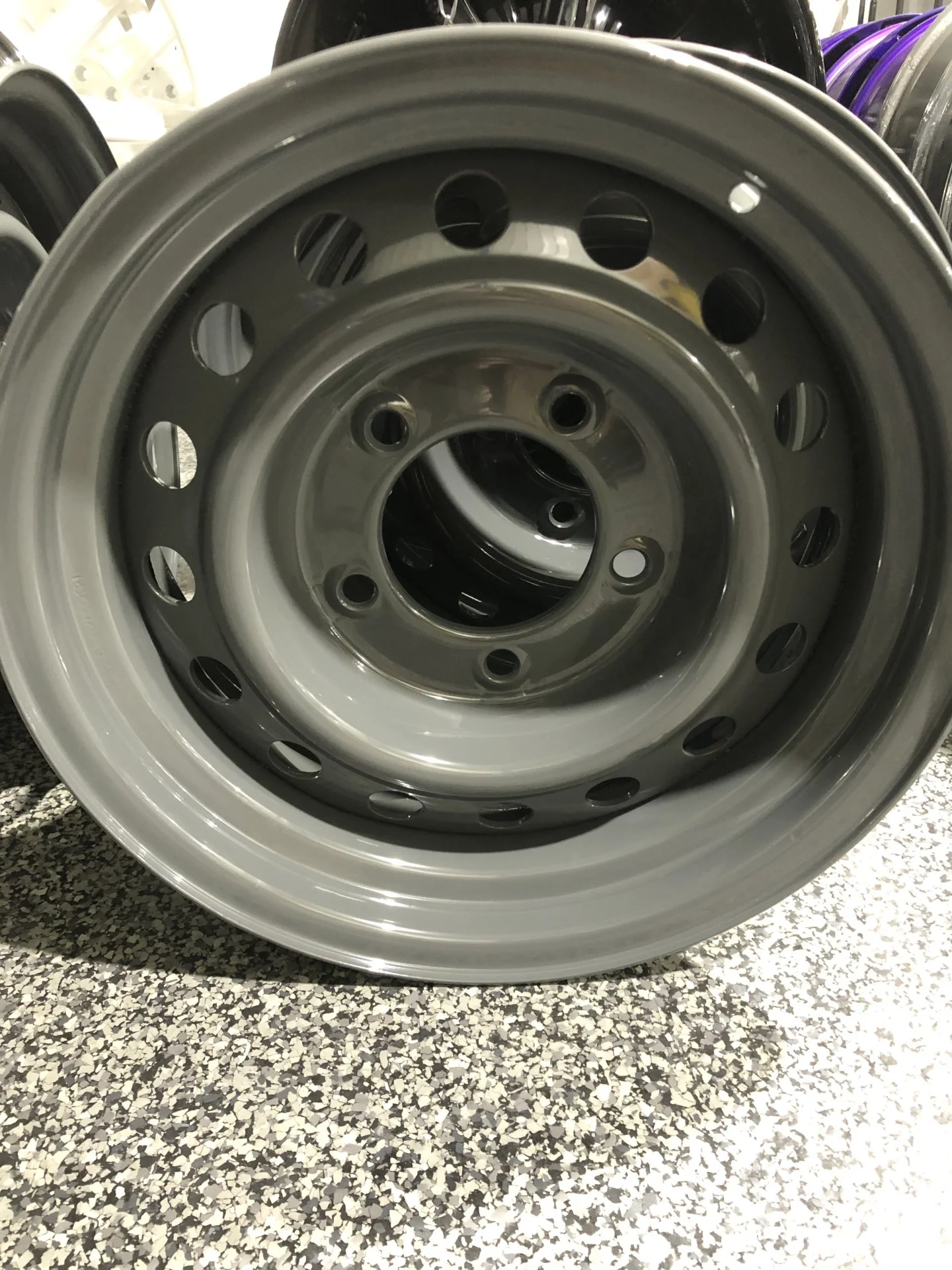

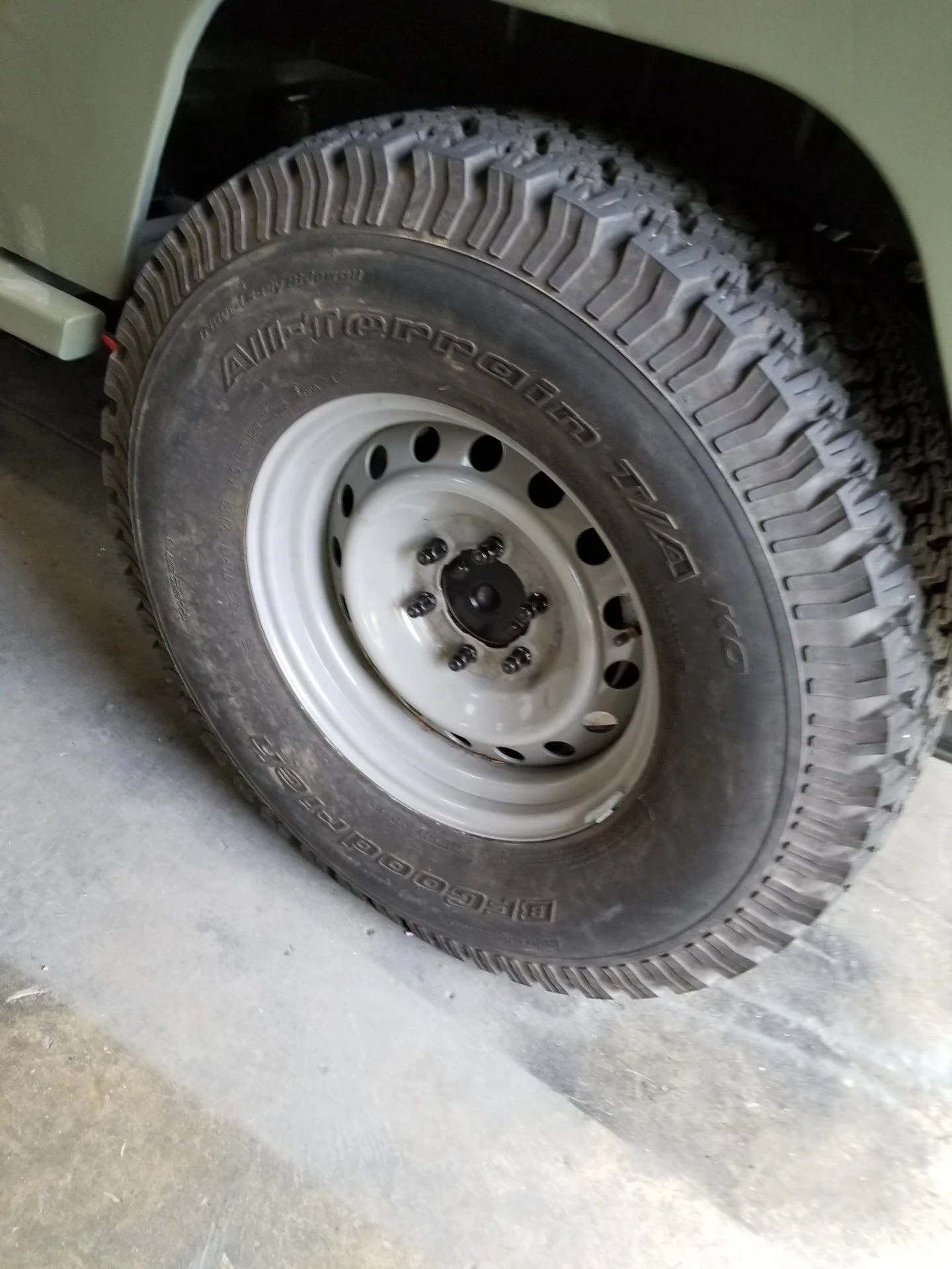

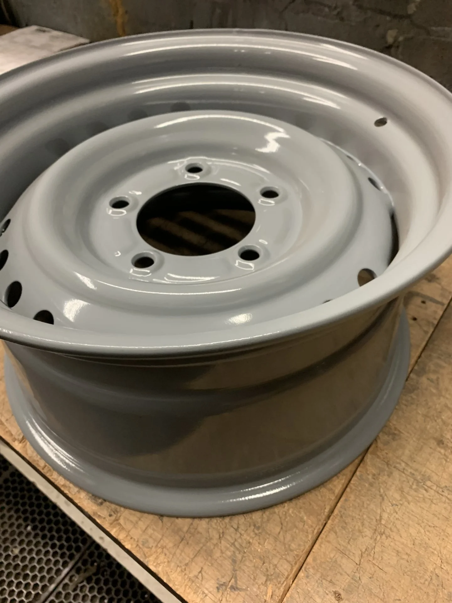

Stockton 79 series Frankenstein wheels RAL7043
-16x8 +12 offset and 5 inch backspacing
HZJ105 steel wheels 42601-60580 which is also RAL7043
-16x6.5 0 offset maybe that equates to 3.75 backspacing
80 Series steel wheels 42601-60361 16x8 0 offset painted with Rusto Charcoal grey

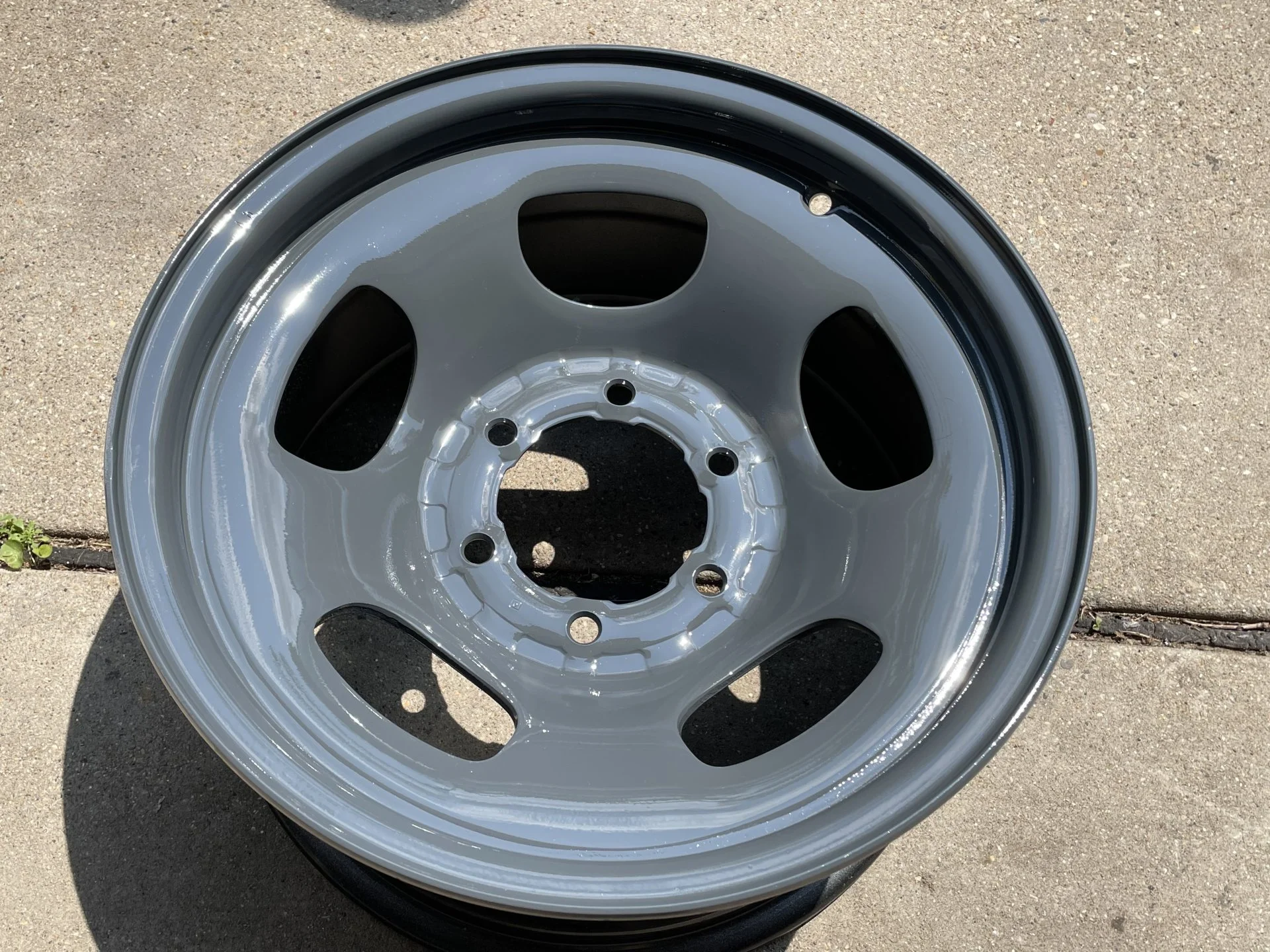

I had some various grays left over from painting my 40 wheels. I got a couple more names I recognized from reading here and held them against my sun baked 8b4. I used dark machine grey on my rustic green 40 and it looked good. I went with dark gray for this truck.
Scuffed the wheels with maroon scotchbrite and soapy water. Rinsed and hit them with compressed air and set aside to finish air drying.
Gave them a good spray with prep spray and more compressed air before primer and first coat of color.
