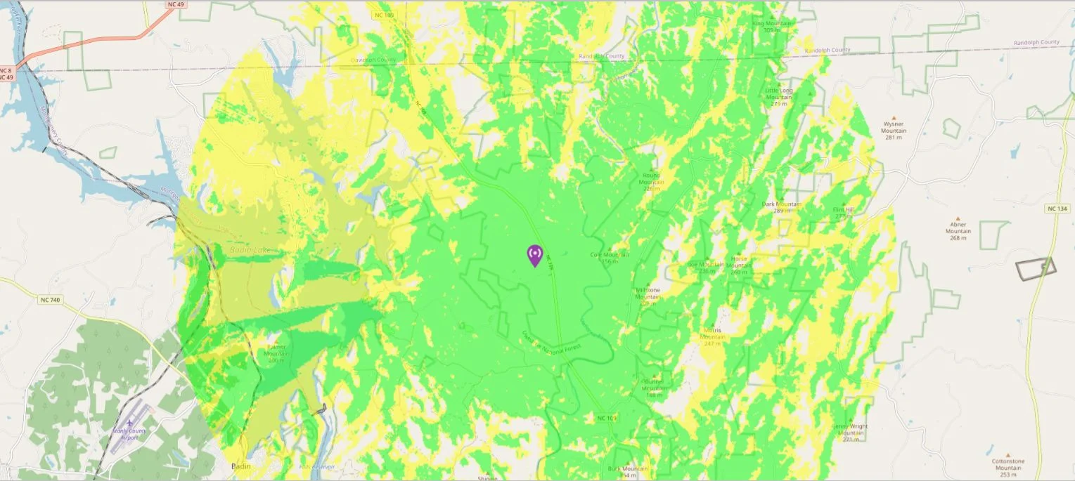

Here is a coverage map from the Shadowlands Campground. This is based on a GMRS freq with a 20 Watt transmitter and an antenna 10 feet in the air. Ideally, you want a base station radio at the operations center in the campground and a repeater on top of a mountain somewhere. If you send me the Lat/Long of a site or two on top of a mountain that is within range of the base station and at a place where you can hide the repeater in the woods, I will create coverage maps for the repeater.

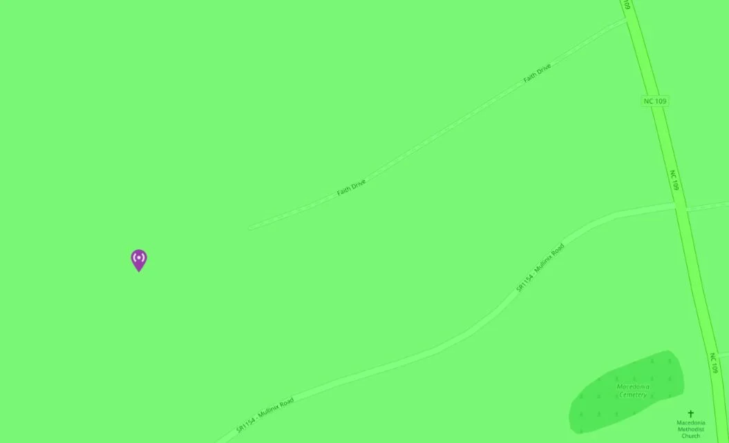

Just to make sure this is the right place, here is a close up of where the transmitter is in the camp site.
Here is the propagation/coverage area from the camp site.
That propogation map makes it seem like a single repeater at the campground is plenty!
