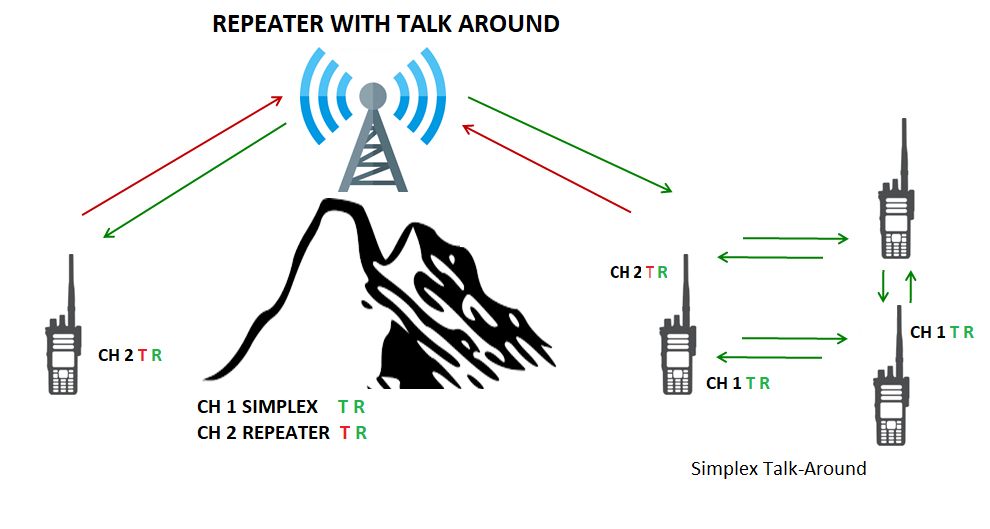

@GLTHFJ60 , it's part of the band plan for GMRS. 7 upper frequencies designated for repeater operation.
The talk-around part is what I'm still trying to get my head around. simplex and repeater at the same time I'd think would cause issues.

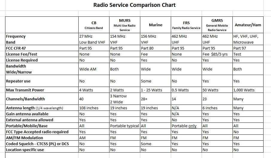

Yes, they are GMRS freqs. The 462 block is for simplex and repeater output/transmit, the 467 block is for repeater input/receive. The 5 MHz between the two blocks is because repeaters need to have some separation between transmit & receive.
The bandwidth of the duplexer is very narrow, that's why they are only good for the 3 adjacent transmit & receive freqs (50 Khz bandwidth for the transmit freqs and 50 Khz bandwidth for the feceive freqs). If you wanted a GMRS (462-467 MHz) repeater and a UHF Ham (420-450 MHz) repeater they would have to be seperate repeaters.
The FRS freqs are limited to 0.5 Watts, no repeaters and fixed antennas are not allowed.

Simplex on a repeater transmit freq, called "talk around" is useful because you can monitor local simplex traffic and the output of the repeater at the same time. If you want to talk simplex to the local guys you use the simplex channel (CLCC channel 1)and when you want to talk to the guys on the other side of the mountain you switch to the repeater channel (CLCC channel 2). If you are on channel 1 or 2 you will hear the local simplex and the repeater.
