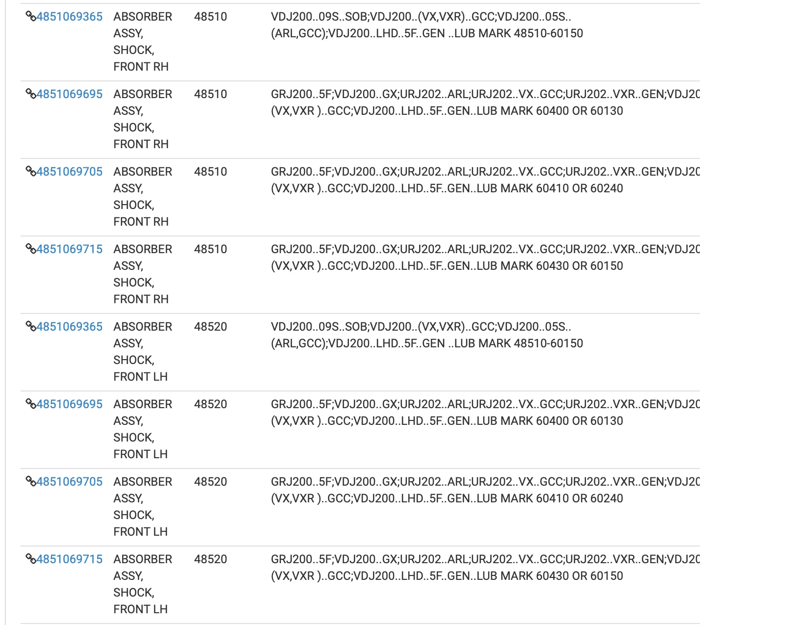

I've never noticed that in my adventures through the parts lookup system.
Seems quite common with the front struts, and it does not apparent to have anything to do with data labels. If you plug the "Mark number" back into the search engines, it comes up with nothing. Maybe @cruiserdan or @OGBeno can help us make heads or tails of it. Do the "mark numbers" reference a different grade/rating of shock?
”Mark Numbers” are engineering part numbers assigned by Toyota for suppliers whom provide OEM parts to the factory line when the vehicle is built— in most cases with Land Cruiser, Tokico (which is owned by Hitachi).
These are different than service parts replacement which is what Toyota dealers support. The shock is an individual part. Replacement part numbers are part “kits” that usually include shock, bushing and hardware.
They receive the -69Xxx suffix number. In Toyota part nomenclature, any xxxxx-x9xxx indicates a part kit assembly made up of many individual part numbers.
Replacement shocks are a good example of this.
