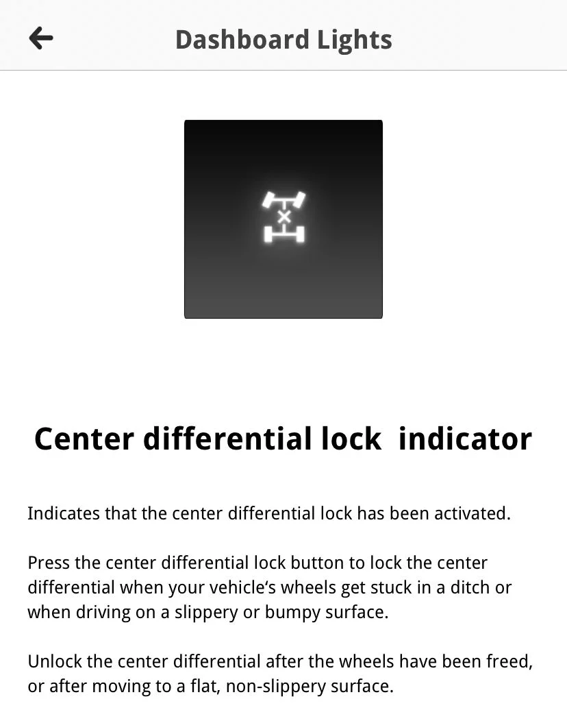

Recently I’ve noticed my Center Locking Differential Light comes on while driving without being activated.
After self diagnoses, I figured out that I must stop, turn off vehicle, then restart, light goes off.
anybody have this same issue?
Yep, happens every once in a while. I get it most often on initial startup when temperatures have changed overnight. It serves as a reminder to exercise that solenoid regularly. After a few cycles (usually in a local parking lot) it will not light up for months on its own. Seems like the CDL solenoid is somewhat sensitive to me. There's probably a better explanation out there but I figure if it works, it works. Good luck sir.
This is actually a pretty common anomaly. Consensus is that it primarily stems from lack of use or lack of using 4LO. I try to cycle/exercise both at least once a week to once a month to avoid the issue and that seems to work. Mine has probably come on three times in as many years and shut back off after cycling the ignition.
Sadly mine is also flashing on more than 50% startups. It never did it on startup until earlier this summer. I think it is because I’m driving only a couple miles most weeks, with maybe three starts. I do use 4lo and center diff quite a bit, so it isn’t from lack of pushing the button/switch.
