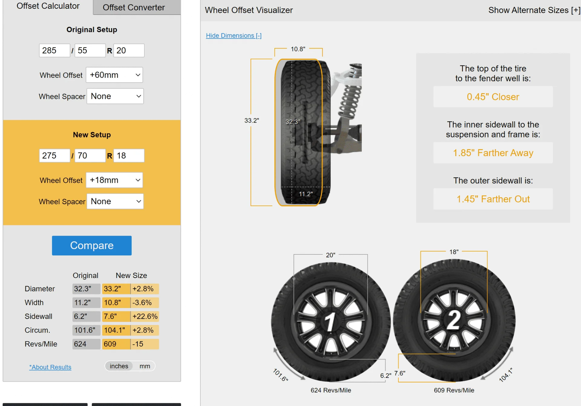

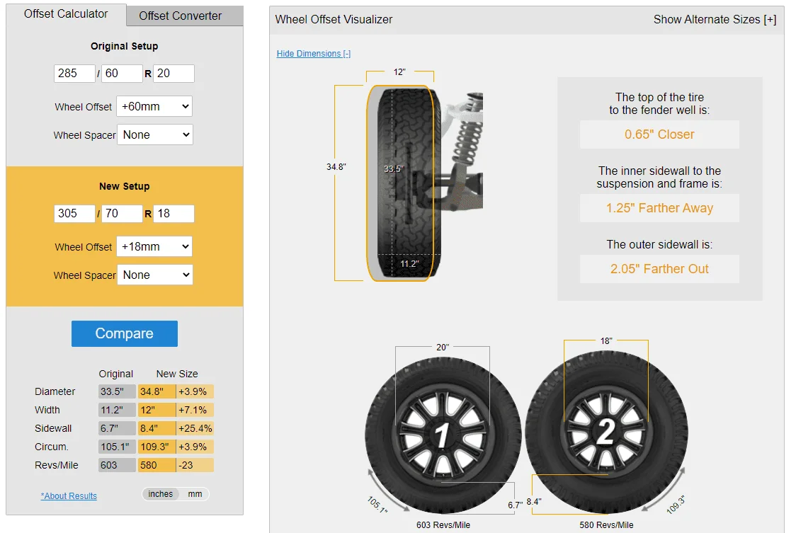

Looking at wheels for my rig and like the Method 310's
in 18" the only 5 luck option is the 150 PCD.. guessing that's the right 1 to suit the LX/LC200's? Will I need to run a spacer with them or are they the right offset that I can just put them on without any shenanigans?
5x150 is the correct bolt pattern.
110.5mm center bore is technically .5mm too big (stock is 110mm). You'll be lug-centric vs hub centric (this is how i run now).
the website says those methods are 18mm offset, but the stock offset is +60mm
get ready for this.....
You'll be able to run up to 305/70/18s on those wheels. The LX is amazing at eating up big tires.
Nice, I'll use that for my calcs..
That doesn't seem too unreasonable, but will need to get the tape measure out and see how much more that extra 2" will stick out.. if it's outside of the guards that's a no no here with the police
