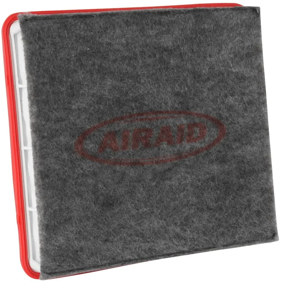

I'm a big fan of the Airaid disposable air filters: Airaid disposable on Amazon
It's a disposable synthetic blend main filter with a depth pre-filter that catches all the big stuff before it can clog the main filter. No oiling, no muss, no fuss. And the sealing gasket is thick and squishy to provide a good seal in the air box.
I run a Filterminder vacuum gauge on my air filter housing and these filters last at least the 24,000 miles they are rated for - especially good here in the high desert.

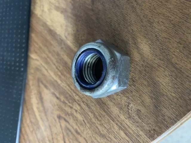

Stupid question related to ARB rear bumper hardware. Why are the wheel studs smaller than what's on the 200? Just realized this when I went to put splined lug nuts for my new RWs on the carrier and it was a no-go.
Also, does anyone know the size of the lock nut used to hold the spindle on? I cross threaded one of mine. ARB couldn't help, said to go to the hardware store!

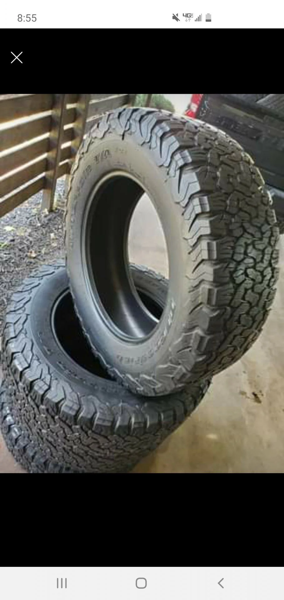

Would these be a good buy? Can we fit them without a lot of modification on a 2008 LX570. 285/65R20 $300 used for 4

check the DOT date and make sure they aren't dry rotting. are you currently running wheel spacers? If not, you might need them if they contact your UCA.

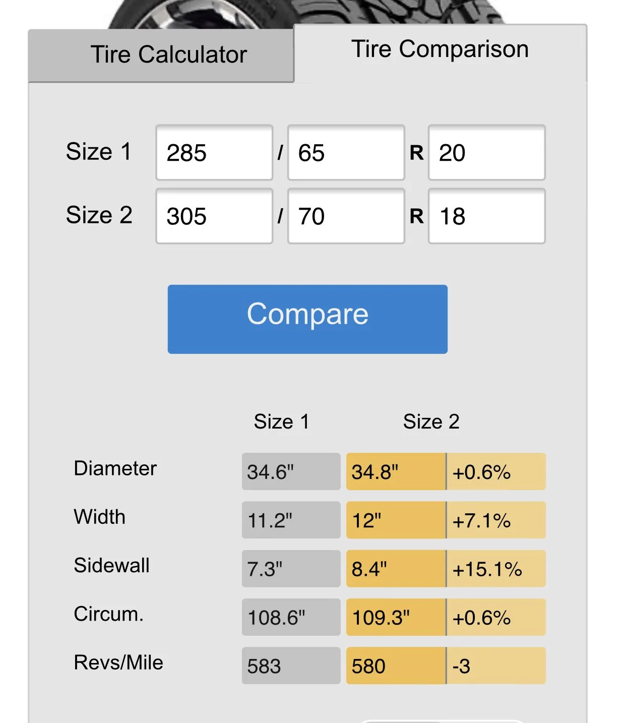

Other than spacers, you'll need to move your front liners forward and trim some plastic on the step side. Also, sensor lift, possible AHC offset, and alignment.
here's how they compare to my 305s:
