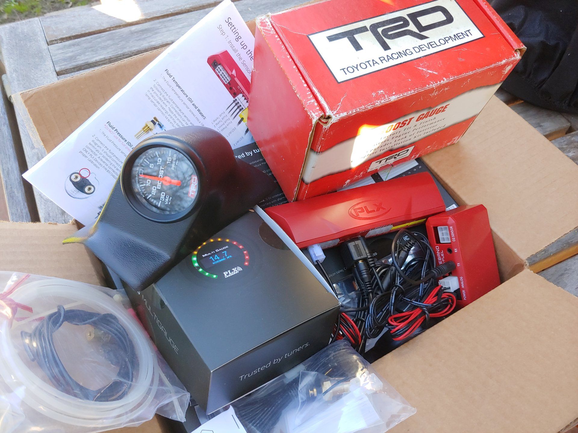

PLX and a brand new OEM TRD boost gauge. I like old school and I like new school but I don't really need 2 boost gauges. Thinking about selling the TRD boost gauge. What do you think?

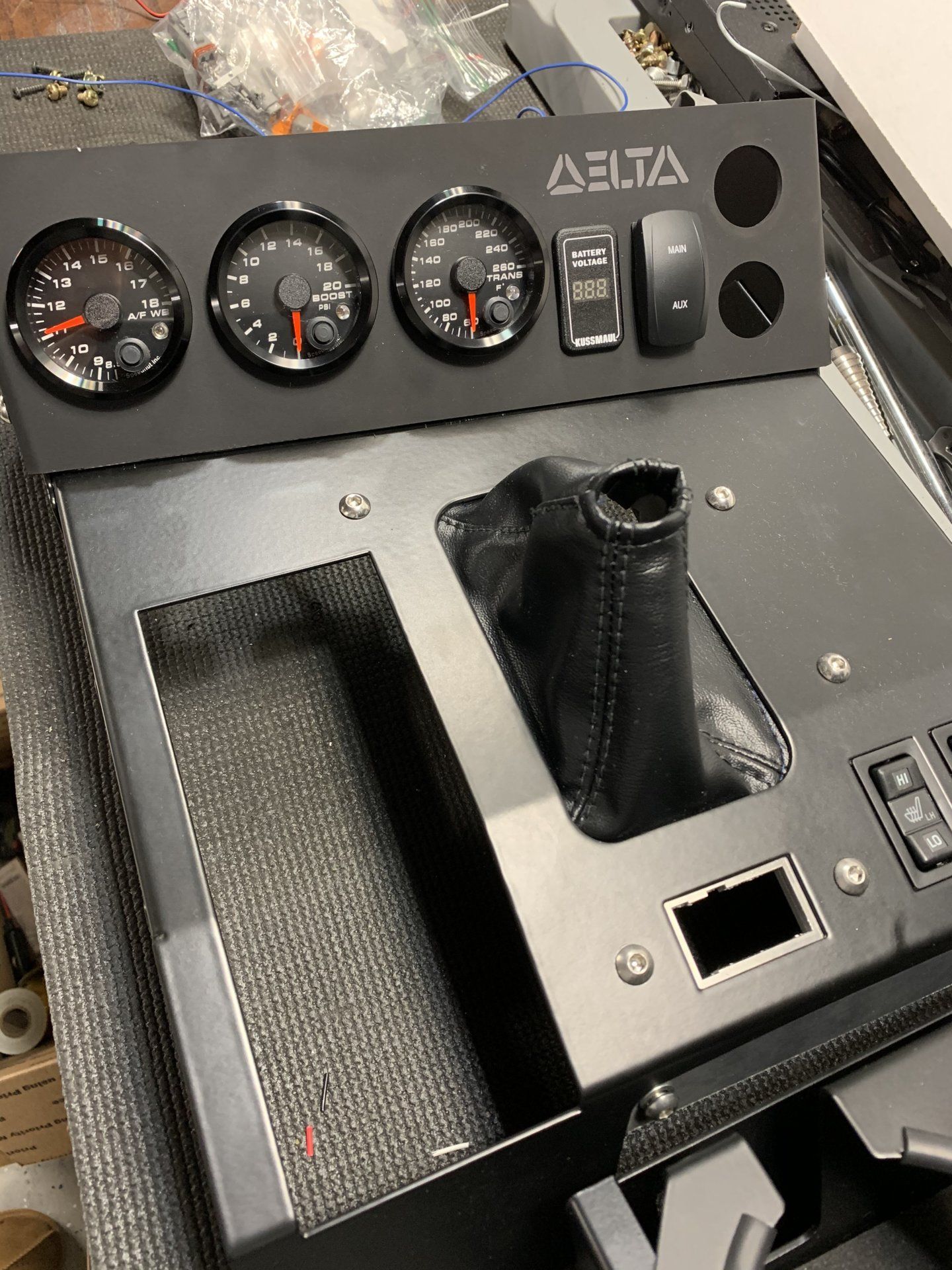

However if I don't install both gauges I'm going to have an empty hole in my Delta shifter console going to be naked I need something to go in there if I sell the TRD boost gauge
Hard not to love those TRD gauges, I opted to just go speedhut since I’m thinking of switching the 62’s cluster gauges over to them as well.
What else do you have in the Delta console?
