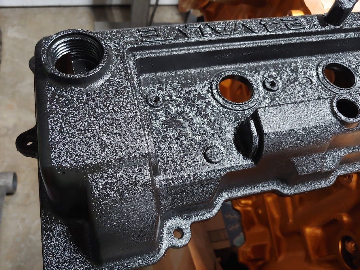

Here's a better shot of the wrinkling as it dried overnight. Instructions said to bake at 200 degrees to cure faster. My wife would kill me if I used the oven. Plus I think it wouldn't fit if I tried anyway since the cover is to damn long. I will be taking a sanding wheel to the lettering to leave them raw aluminum. If I'm adventurous enough, I might try to hand paint the lettering in the same burnt bronze coloring. Shooting some in a small cup and using one of the kids small paint brushes. :cool:
I'm going to hit the heat gun and keep it moving around for 10-15 mins later tonight. It should create tighter wrinkle pattern.

You should have taped off the oil fill cap hole , crankcase gasses and oil are going to cause that paint to dissolve into your engine oil. I would clean all that paint out of this area.
yup I am going too clean it out. I didn't mask it off cause i was going to clean it anyway since it has build up inside.

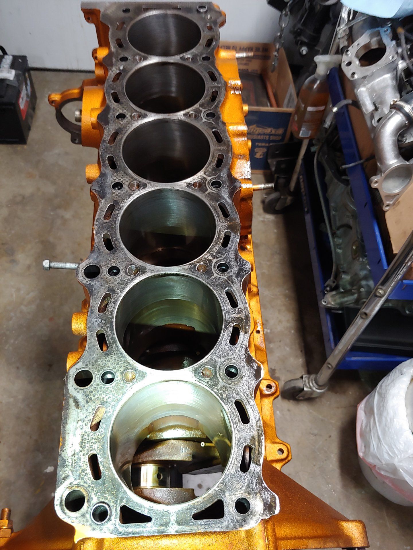

You didn’t mention anything done too the cylinder walls? Honing crosshatching? And pistons, did you just put new rings? Wow great that you can do 3 angle valve job.
I did the same wrinkle on my VC. Definitely hit it with heat when its still wet. Wait til it tacks up so you don't blow the paint around but then slowly and evenly heat the whole thing. Will tighten it up real nice.
The walls looks great and still has cross hatching on them. But since I'm already there, I am doing a very light hone on the cyl walls. using NPR standard size rings and OEM rod bearings.
My buddy has been a toyota mechanic 30+ years. He's the one that's helping me with the build. He demos everything to me twice and then just hands the tools over for me to complete the job. I'm not a mechanic by trade, just a hobbyist but can pick up things fairly quickly.
So you are honing then cross hatching? And reusing pistons and new rings? I am a newb 🤪

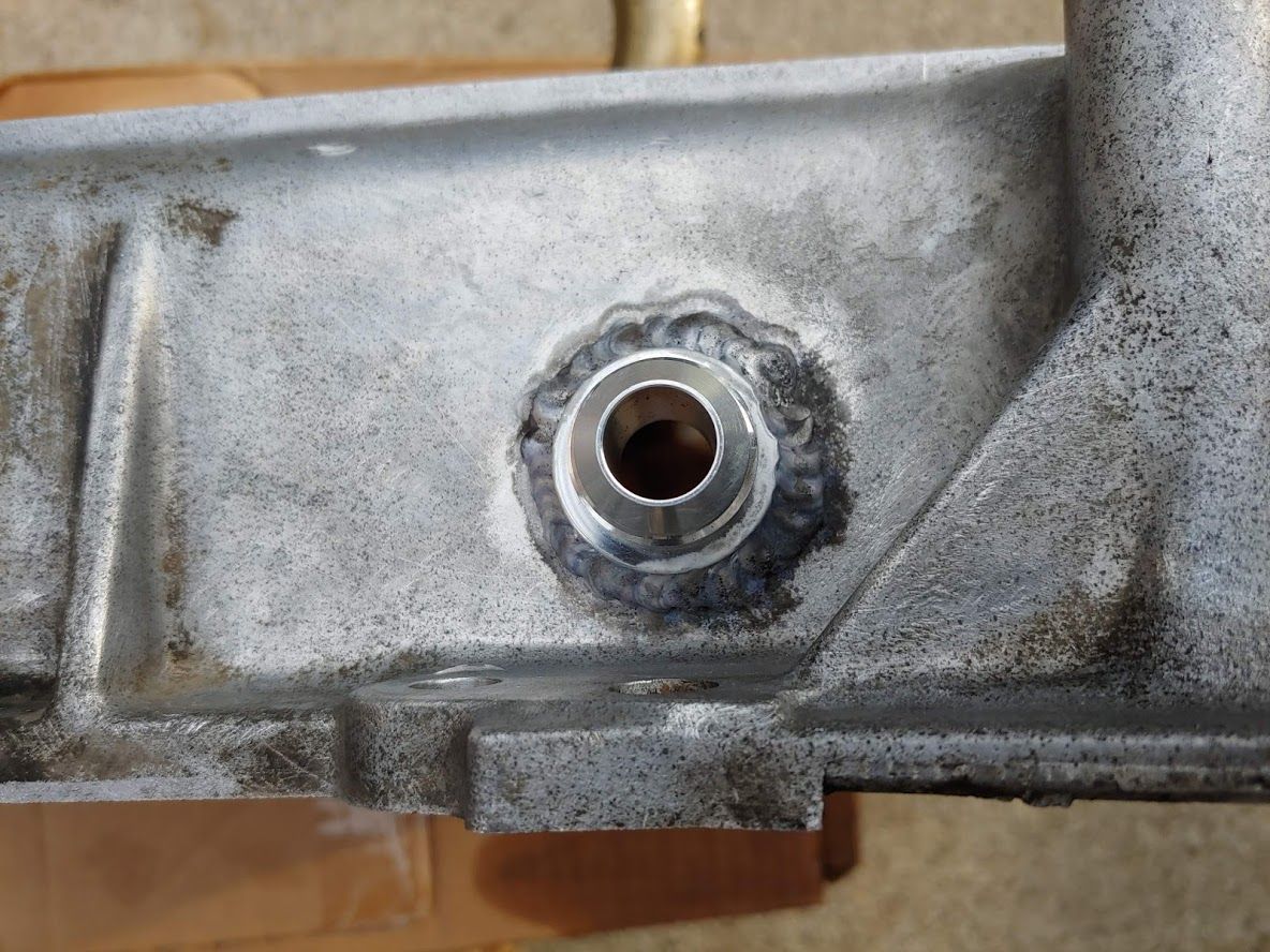

Got my weld on bung today from Joey. Those that are interested in a weld on bung. Here's some basic instructions.
I used the supplied step bit and drilled all the way through. Fit like a glove!
WARNING. GO SLOW when you get close. You do not want to screw this pan up. If you go to far you can't replace it with a new pan (12101-66051) as they are discontinued. Technically amayaya still has the upper pan, but they are $800 shipped. o_O I'm sure your local welder can repair it and fill weld if you screw up.
I mig weld really good and did not want to take a chance on this because of the cost implications if I screwed up. I have a spool gun and failed miserably welding aluminum in the past. I took it to my local welder and he spent 15 mins tig welding both outside and inside to make it leak free. Shop price was $150/hr and it cost me $40. YMMV

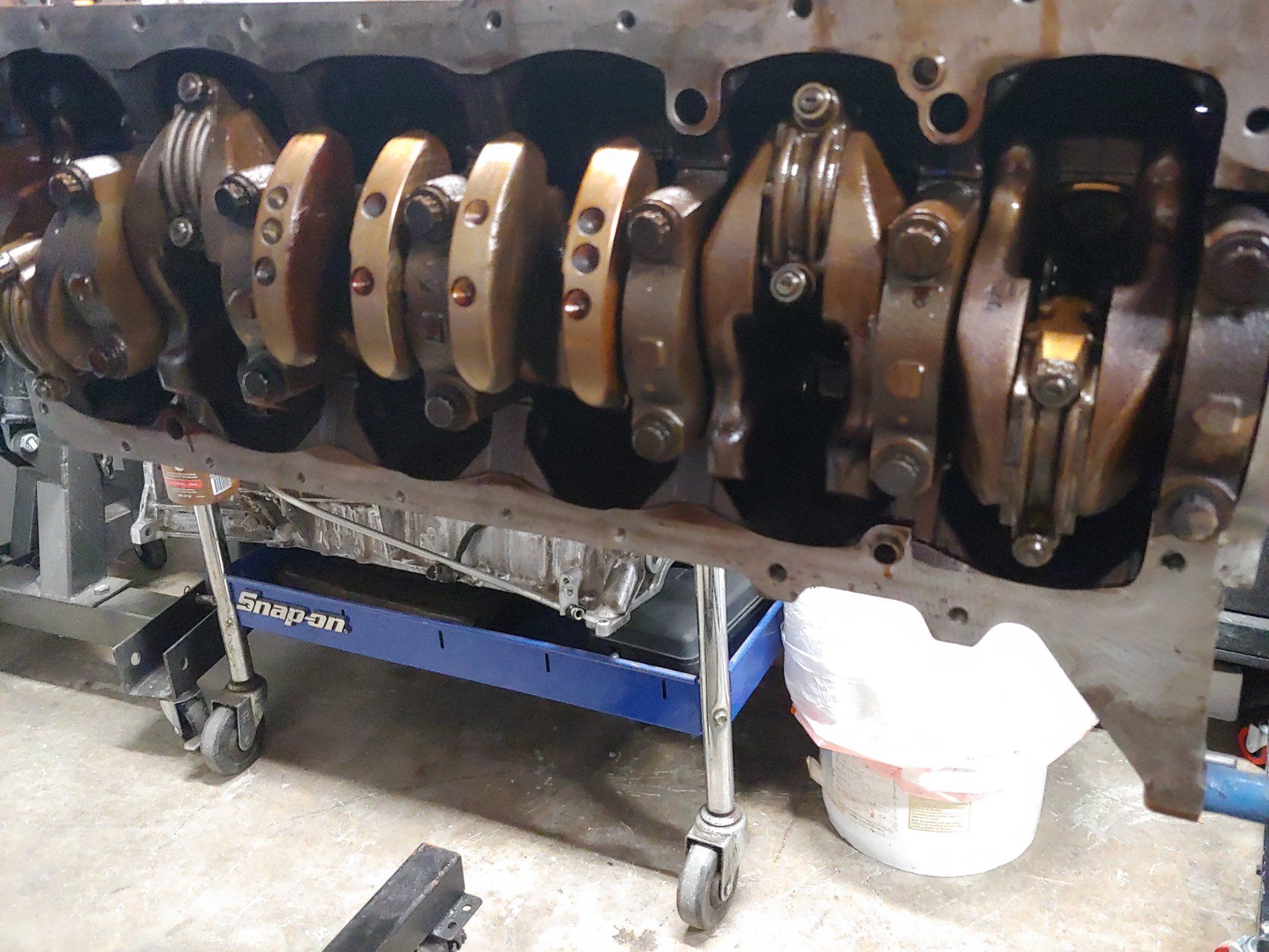

Only took me about a week before I got my lazy ass back to work on my block. Pistons out now and I changed the brushes on my upgraded 150amp Sequoia alternator. That's enough wrenching for tonight. Back to drinking.
Pic of the crank with no rods. Crank and rod bearings looks beautiful. Not taking off the crank and leaving it alone. Trying to not get further in the rabbit hole this time.
I know i had to do rings because of my high oil consumption so I'm putting in NPR rings and OME Rod bearings. I could have probably got away with leaving the original rod bearings but I'm already in there.
