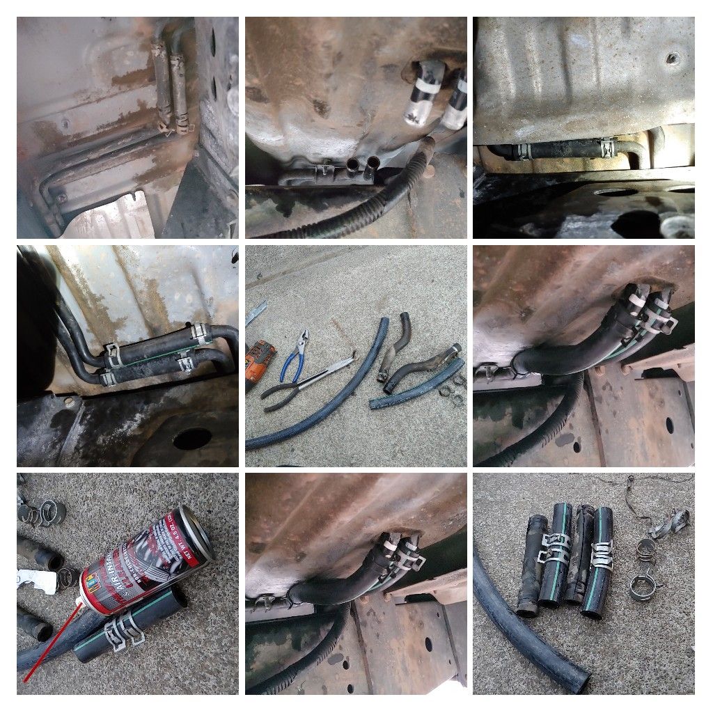

Changed my rear heater hoses. Bought the 1/2 Gates Green Stripe from @NLXTACY. Its easier to reach the hoses when theres no trans, tcase or exhaust and cat in the way 😁
One trick my mechanic buddy taught me is when you change any hoses. You use carb clean and spray the inside of the hose. Why?
1. It acts as lube so it slides in really easy.
2. It actually sort of melts and softens the rubber so when it dries it seals it to the tube almost like glue.

Good tip on the hose install. I also have one of using hair spray. Very temporary lube then sticks in place. Helpful for installing motorcycle and bicycle grips too.
