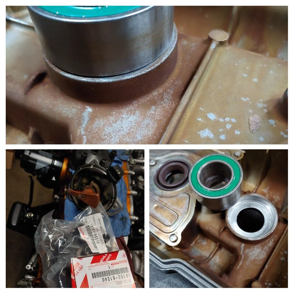

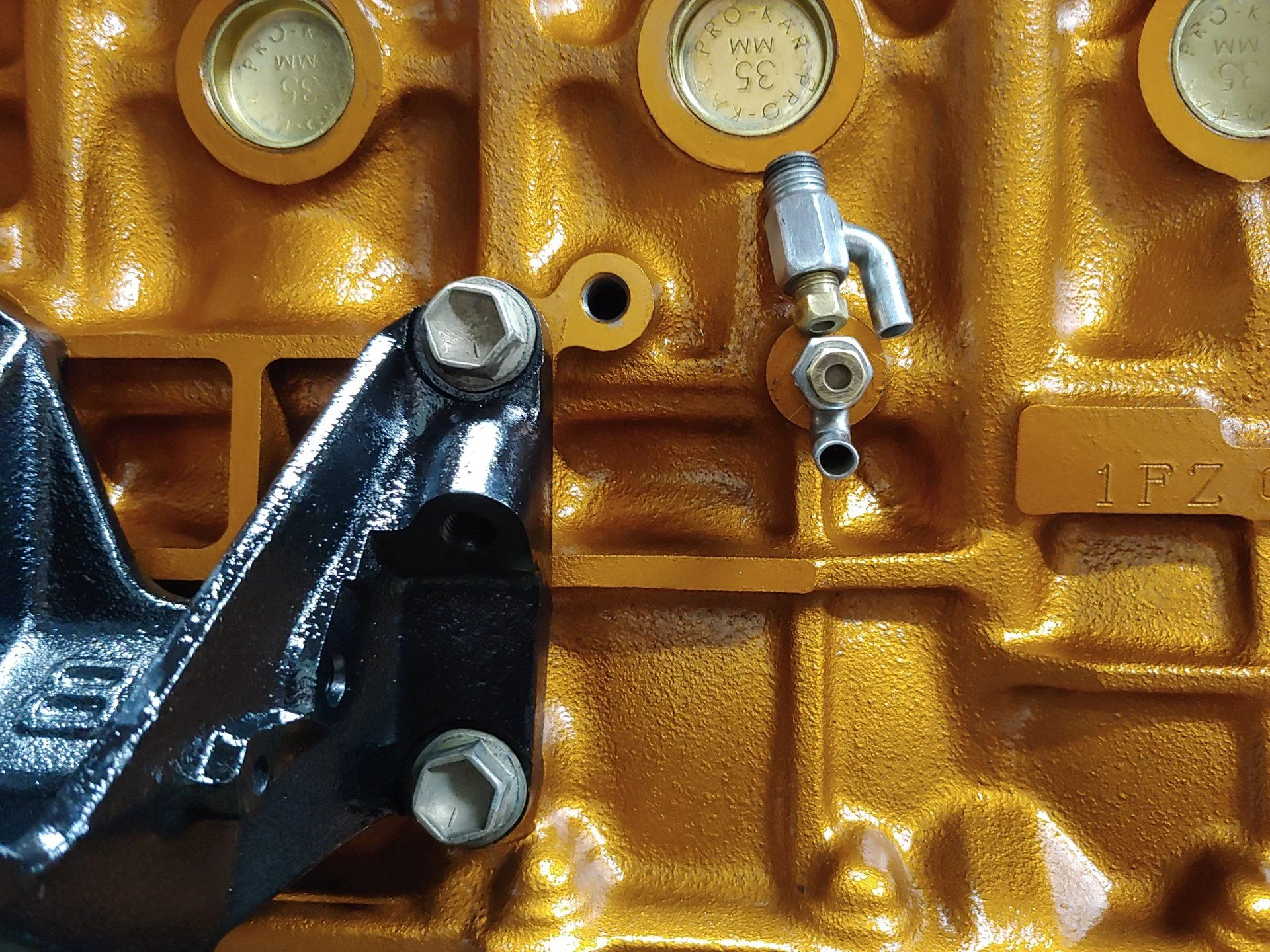

More pics of complete short block and a close up shot of the Wits End Weld-on Turbo BUNG HOOooooooole

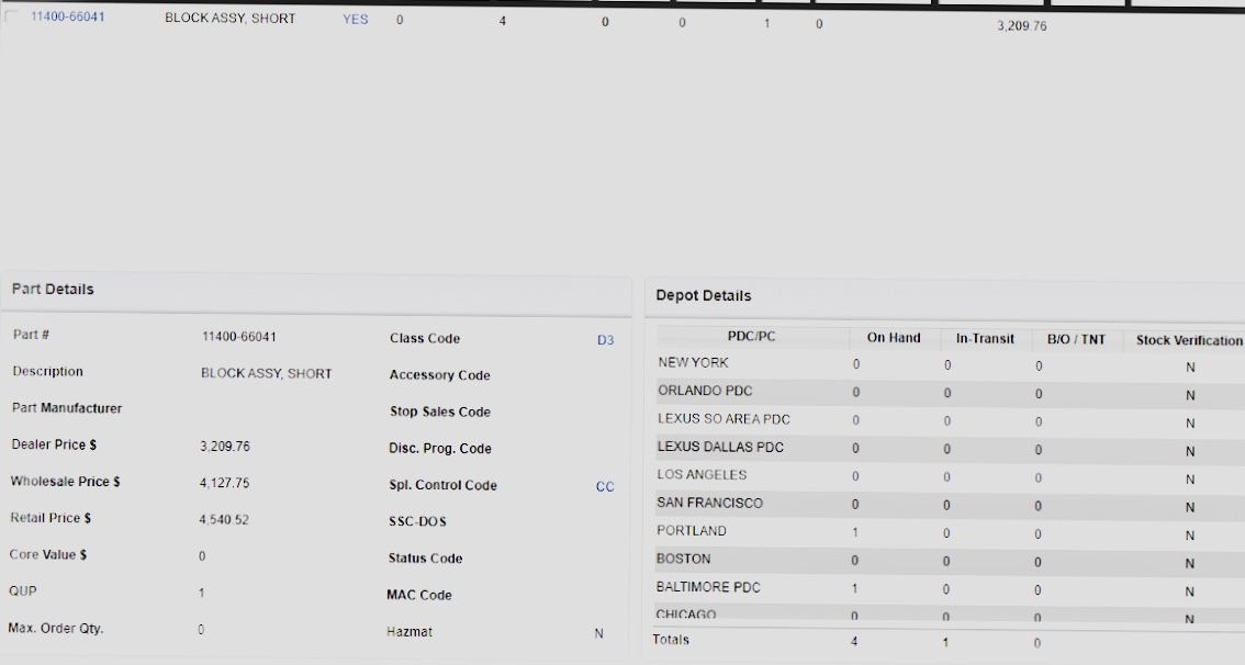

Having just bought a new 1FZ Toyota short block at the dealer this past Saturday, I can confirm there are now only FOUR left.
Dang... Not to many left in the states. Once its gone its either rebuild or you can still buy a new short overseas. I don't want to even guess shipping for something that heavy.

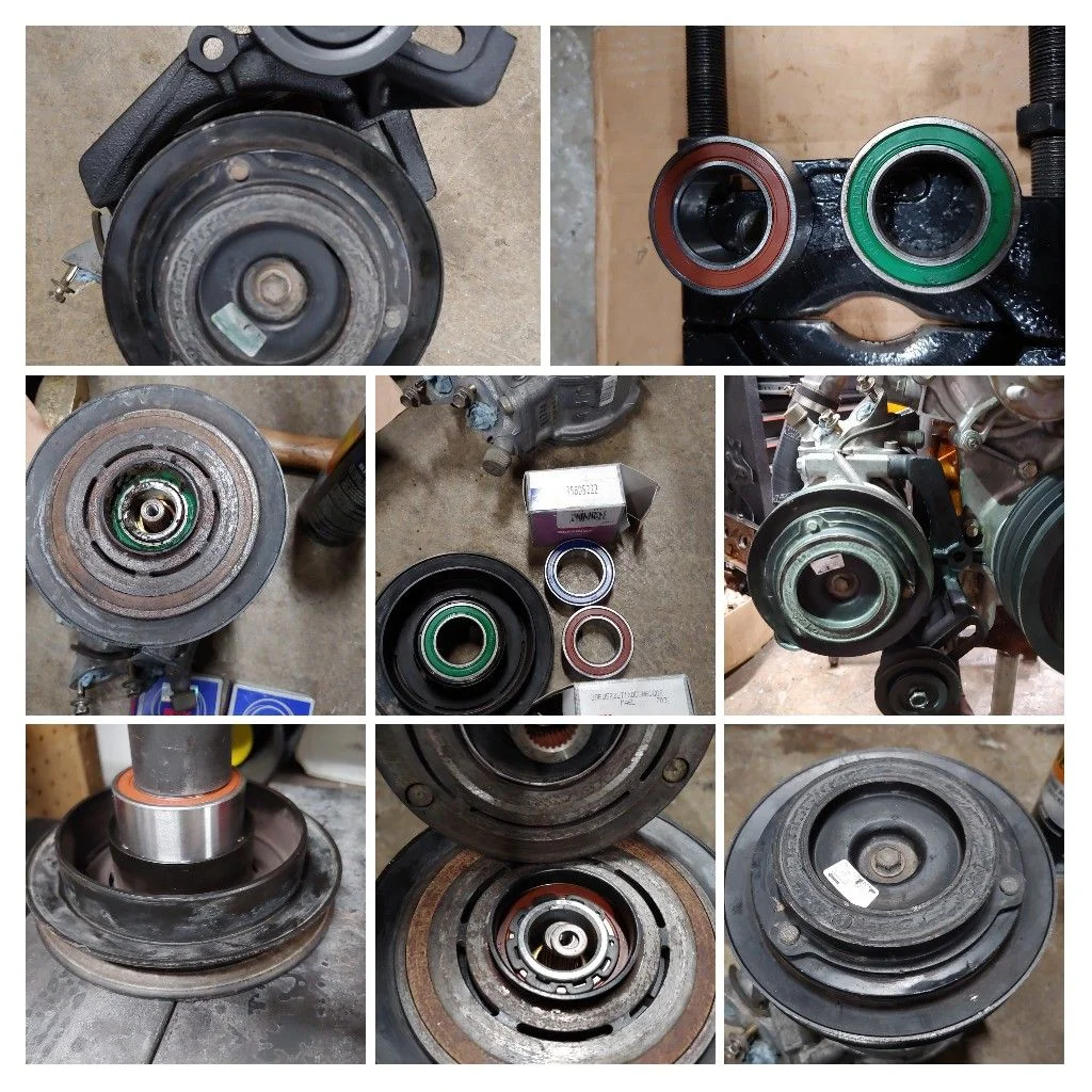

Replaced the AC bearing with NSK 30BD5222.
30 X 52 X 22MM.

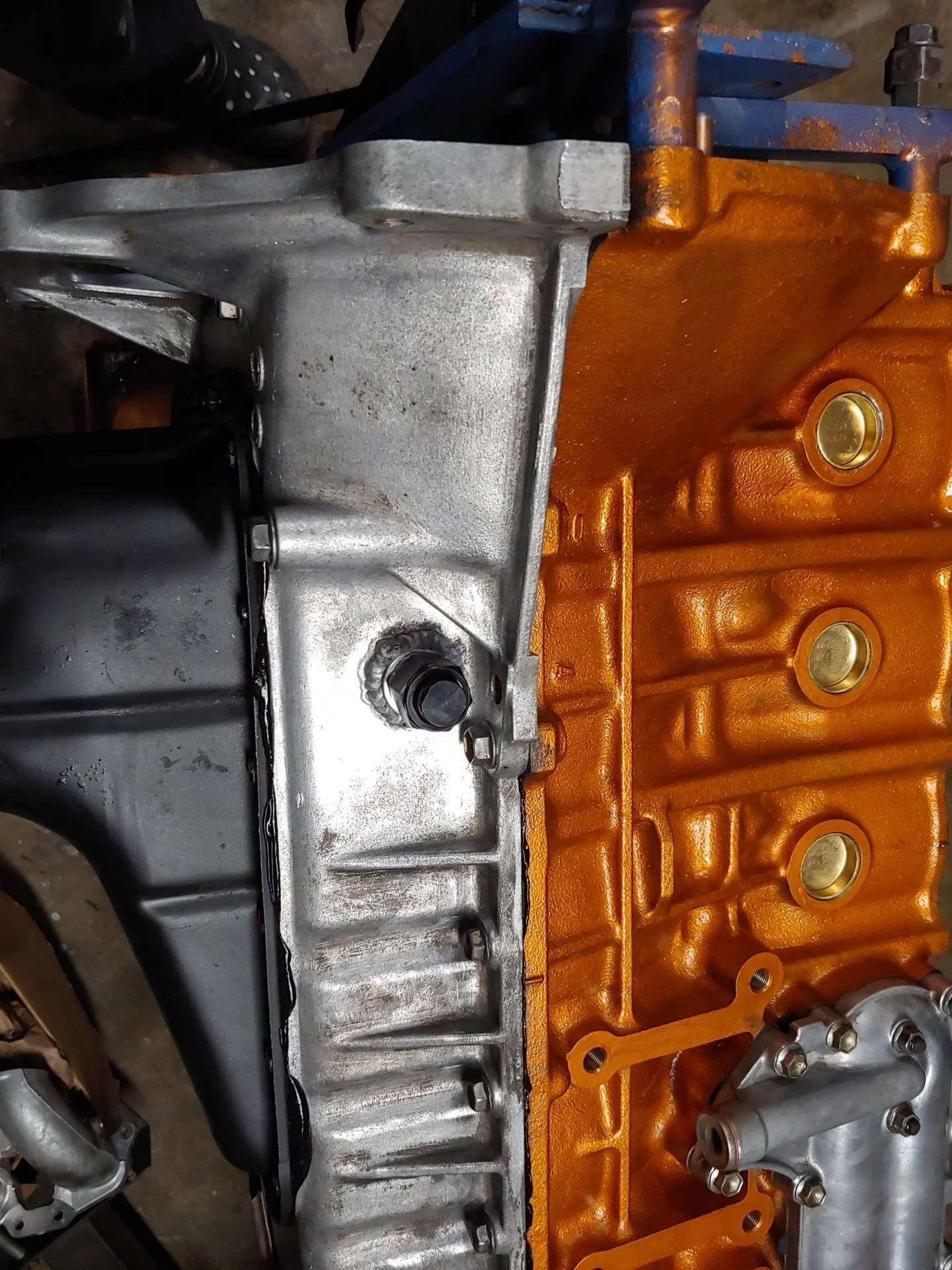

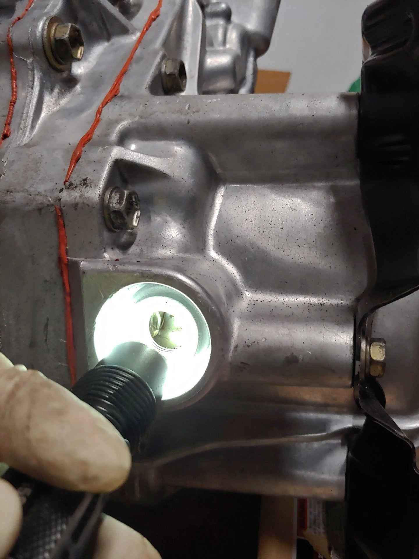

Upgrade with the newer toyota block drain fitting

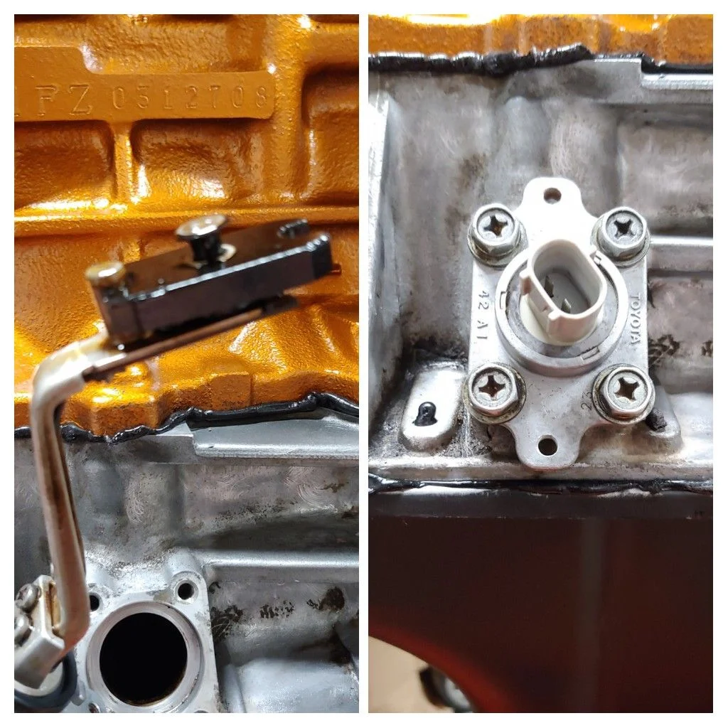

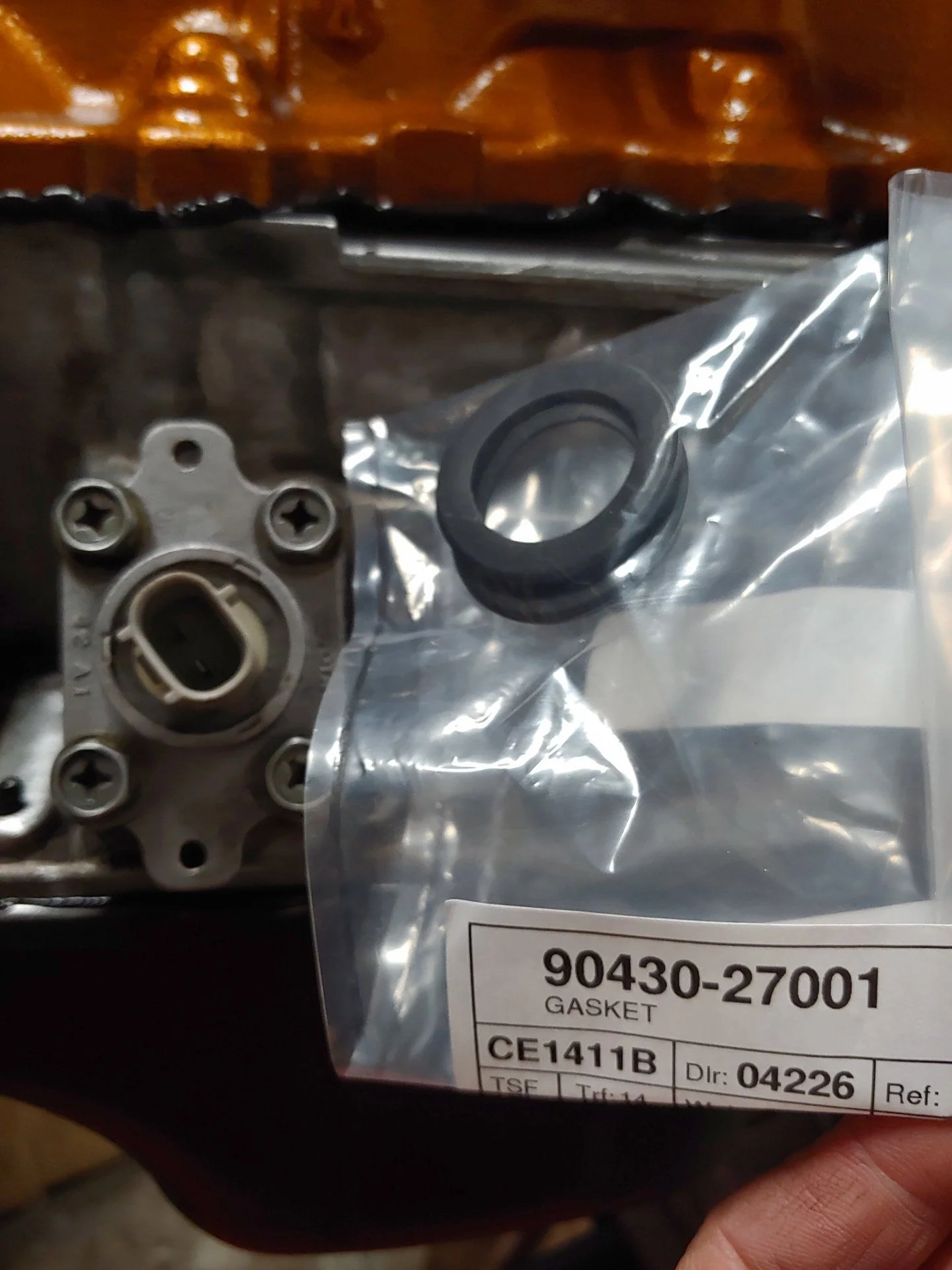

Replace the oil level sensor gasket. If you have oil leaks. This is one place that it'll also leak from.
Part number 90430-27001.
When you take it out, handle it and put it back in, be !!!! extremely gentle !!!!. That bakelite (float) is stupid brittle. Don't ask me how I know. 😭 you don't want to know how expensive that part is.
That gasket is supposed to be soft rubbery. Mine broke in 7 pieces when i tried to use the pick to get it off!

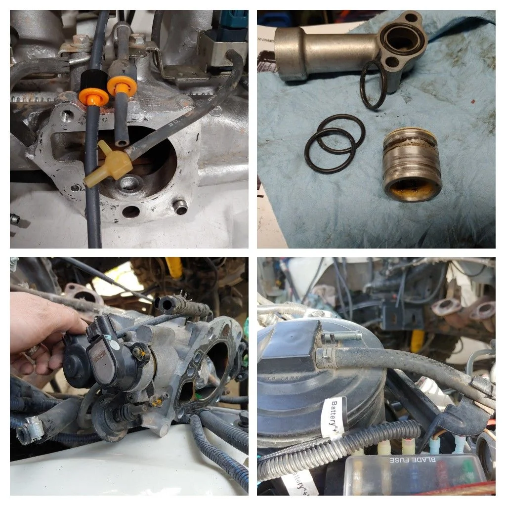

New dissy cap, rotor and oring.

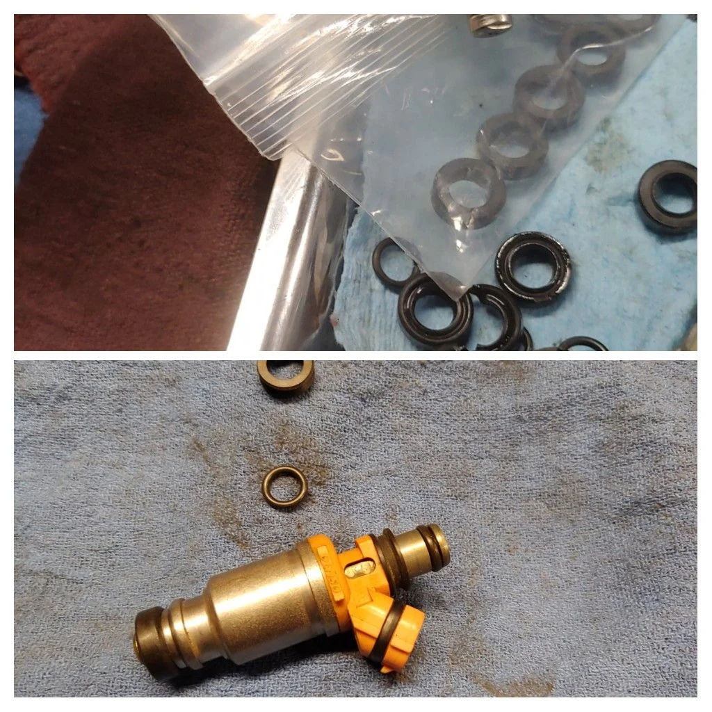

New seals for injectors. They wete all crispy and brittle.
New valve cover tube seals.

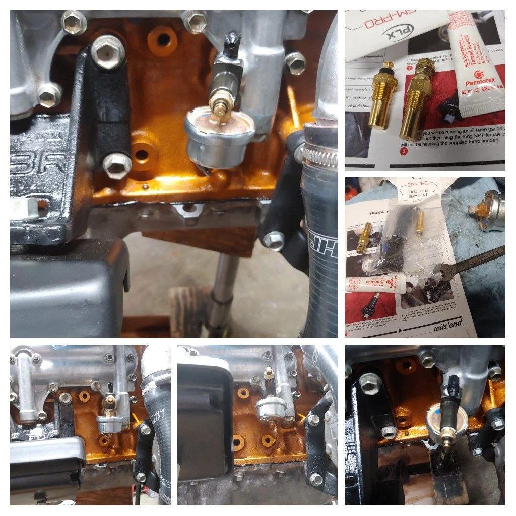

Installed Wits End Peace pipe. Im using a VDO sensor instead of @NLXTACY supplied sensor. Sensor came with my PLX module.
No. That’s incorrect. Just because there are four left in the US does not mean supply will be gone, or the part discontinued after the remaining four have been purchased.
After the four are sold (or getting down to 1-2 blocks), they will be reordered from TMC and they will restock initially at the Japan warehouse first (NAPCC), then to other depots as requested based on min/max stocking levels.
No. That’s incorrect. Just because there are four left in the US does not mean supply will be gone after the remaining four have been purchased.

OEM short block is currently a D3 class code which means that it’s getting very long in the tooth.
But, as stated above, 4 still available in the US with another one inbound from Japan to NAPCC. So, plenty still available.
But, as stated above, 4 still available in the US with another one in kind from Japan to NAPCC. So, plenty still available.

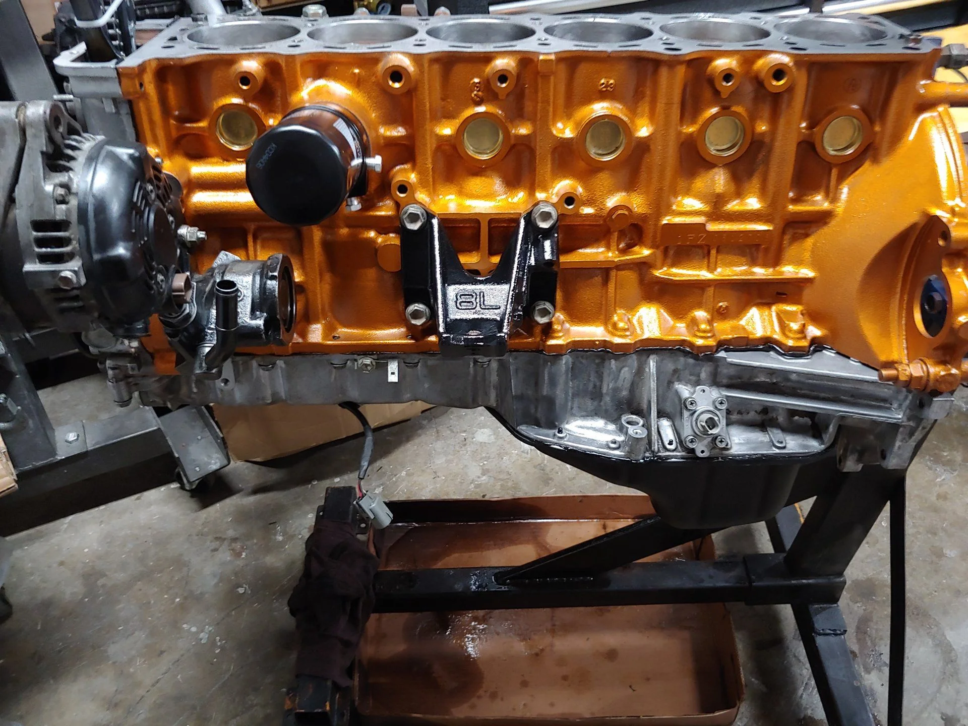

I haven't added my time to the total parts list that keeps growing. But if I had to guess i spent 4 or 5 nights on just the block which includes painting.
Clean, paint, disassemble, deck, hone, clean, rings and and rod bearings, clean again and assemble.
The time consuming part is all the small stuff that I'm doing by rebuilding everything so its like new when it goes back in and cleaning all the oily mud off. Oil and grease soaked dirt sucks bad.
Still cheaper than buying a short. I enjoy wrenching just as much as I do wheeling. Just takes forever for me to finish projects

New OEM and Gates hoses for Plenum, TB and Charcoal can.
My head gasket kit had a coolant oring I couldn't figure out where it went. I remembered once I looked at the parts diagram..

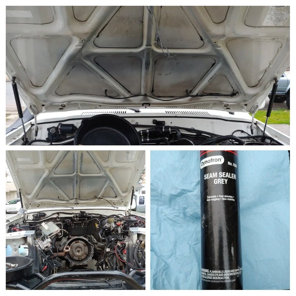

Pulled the hood insulation. I've had hood vibrations on the freeway for some time now. The factory seam sealed gave out. Im going to try and repair the hood insulation and glue the fiber back together with 3M spray adhesive and maybe use foil tape too. If I can't repair it then I'll most likely buy a brand new OEM one. While i was in there I washed ans cleaned and degreased the under hood. I'll run seam sealer in the hood ribs tomorrow then reattach the insulation with my 12 brand new clips. Partsouq .69 each!

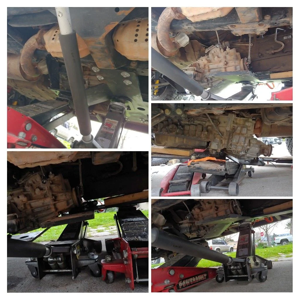

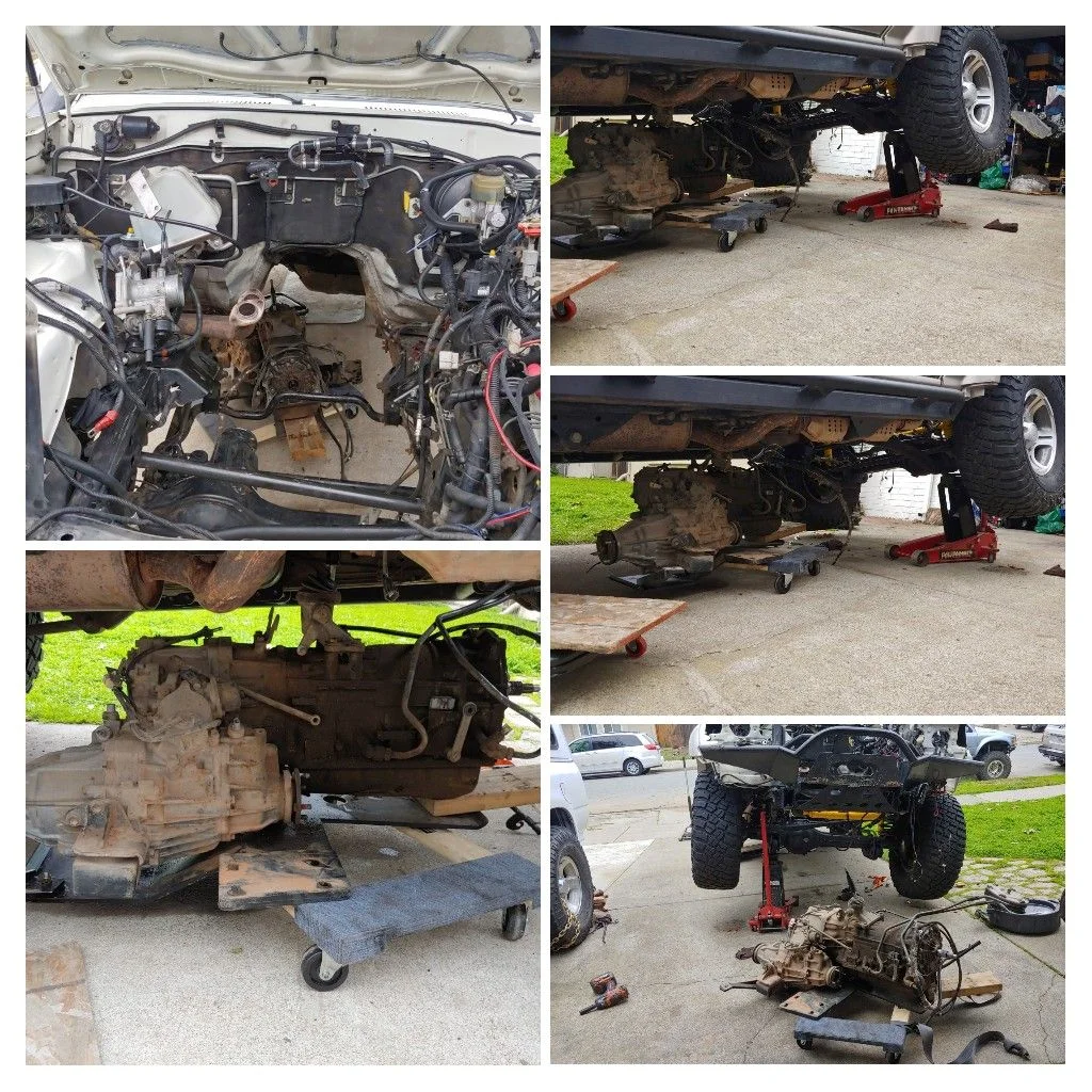

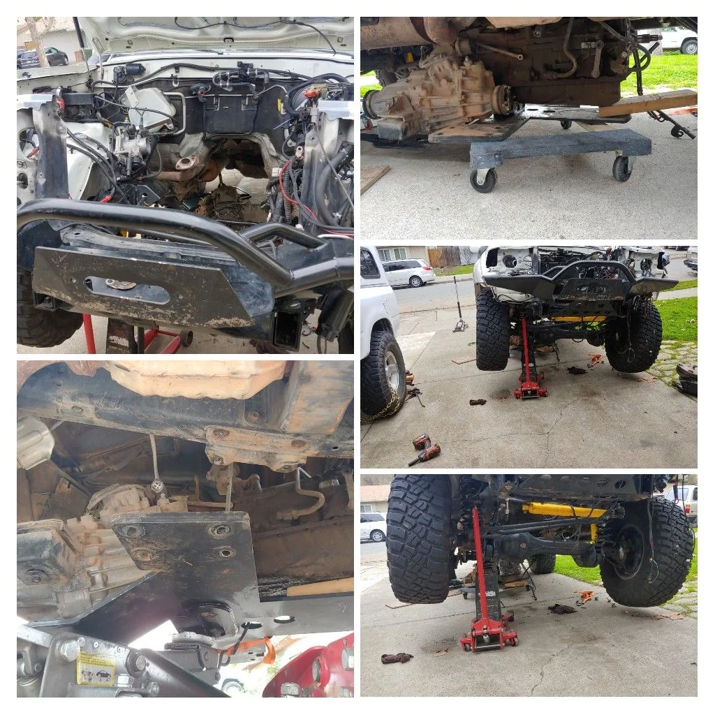

Partsouq finally shipped my much needed parts today. Mostly important thing that is preventing me from bolting the head on is the missing valve springs. Really close to having the engine back in. I'm taking out tcase and trans tomorrow for Transgo Shift kit and low range tcase gear install.

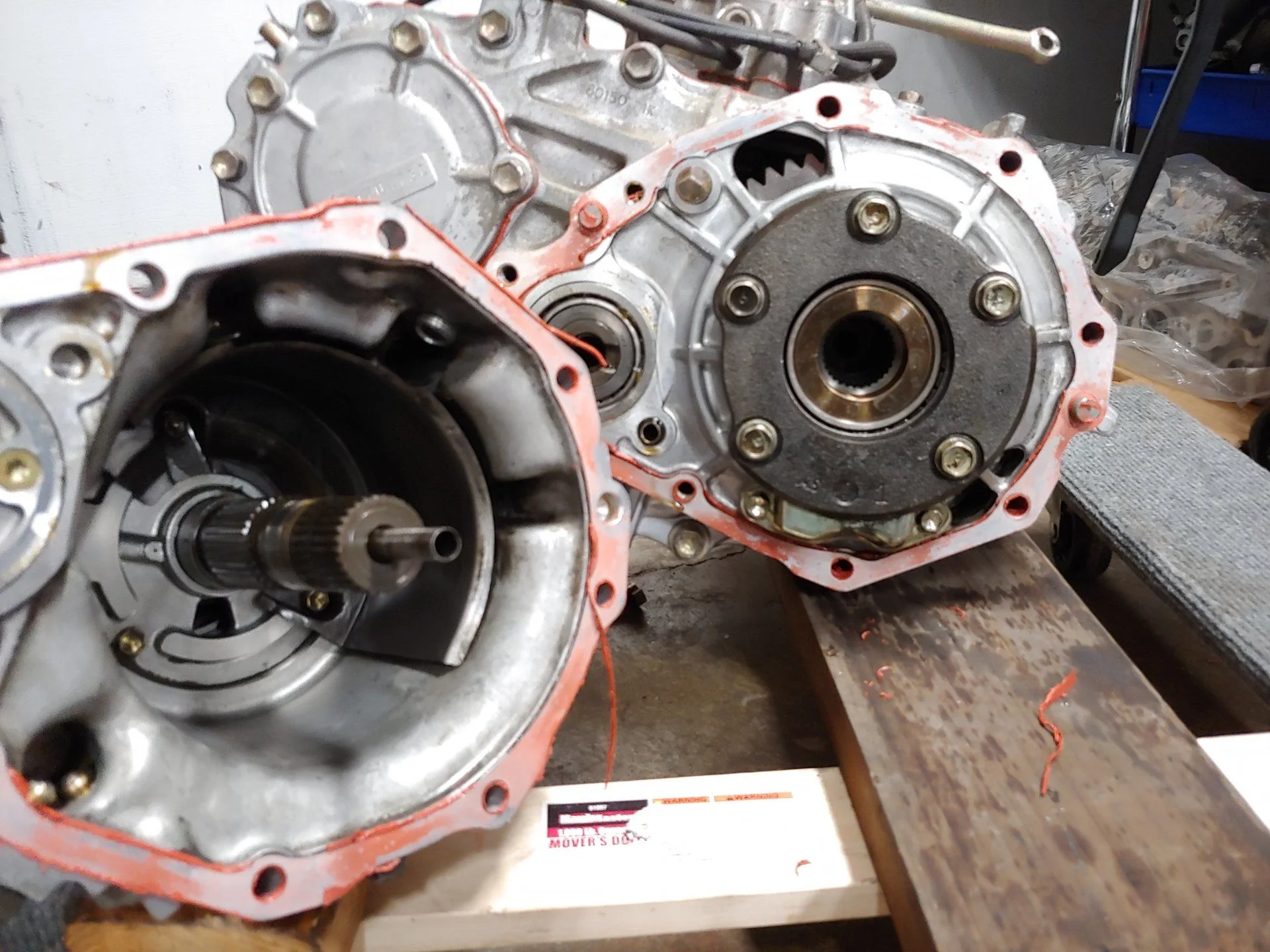

I'm probably the only idiot that would pull apart a perfectly rebuilt T case with low range gears and part-time. I bought a fresh rebuilt tcase and didnt know if it had PT spool. It was rebuilt by a friends friend and never installed. He ultimately sold the truck before the project was finished and became parted out. I happened to buy this tcase. I verified it had low range by counting the number of rotations. High 1-1 and Low counted about 3.1-1.
The only reason why I took it apart was I wanted to make sure it actually had part-time spool in it. I tried using the power probe to lock and unlock the center diff multiple times and whatever I did both flanges still spun indicating that it was FT. It bothered me for a week. I finally gave in and decided to crack it open to verify. Yup it has PT spool. I'm pulling out a perfectly brand new Marlin PT spool to replace with a used OEM VC now. Why? Because I want Full Time. Everything I read is keeping me away from PT because of how it handles in the snow. I snow wheel and cant loose the ability to safely and predictably turn in the snow.
