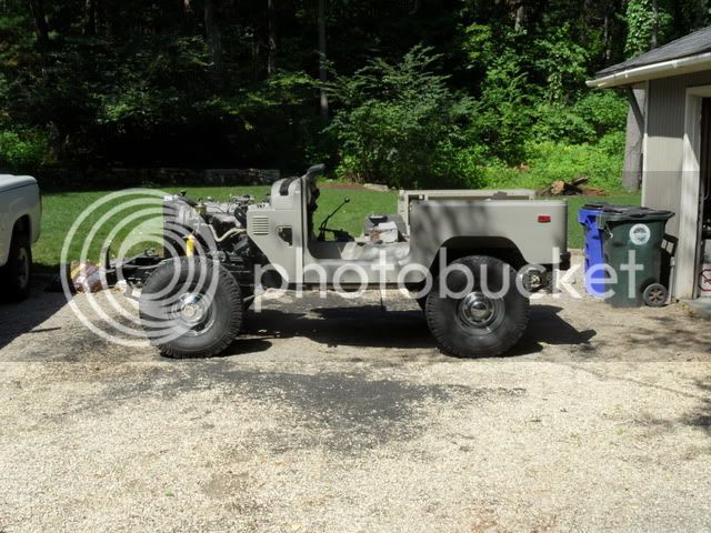

Splangy's 1981 FJ40 Restoration Thread
Have it done for the Fall Gathering?
Hard top is looking good, were you able
to salvage much from the one you got from
me?
I'm hoping to have it done by the fall. I'll definitely be using the driver's side panel from that hard top.

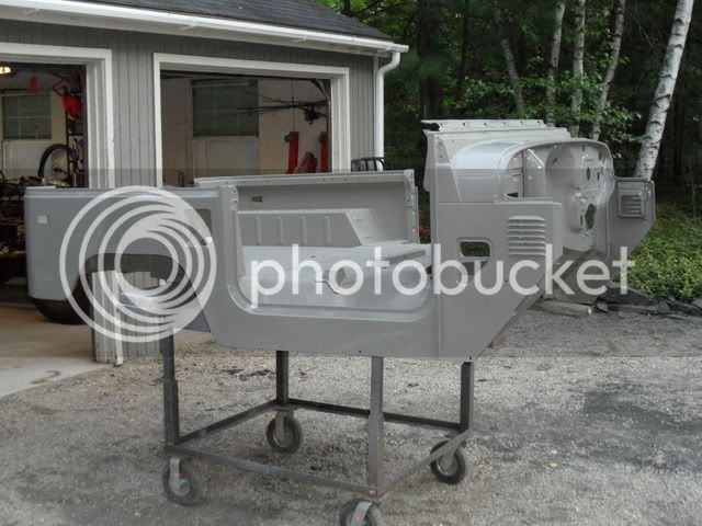

Sandblasted and epoxy primed the inside of the tub:
Looks like it's going to be awesome when you get done.
I lived in VT for a number of years...i'm surprised that thing is in that good of condition!
I was there for 5 years and the 62 that i had at the time basically vanished before my eyes :eek: from all the rust!
Keep up the good work!
It was originally a west coast cruiser and didn't see the Northeast until around '99. 10 years around here was enough to do some rust damage, but not as bad as most around here!

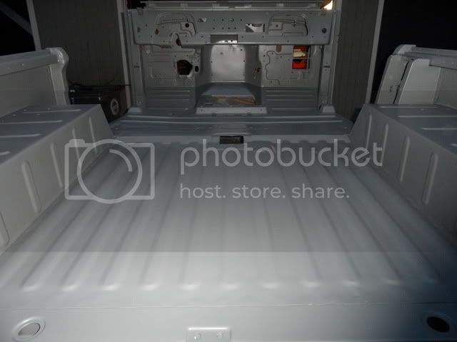

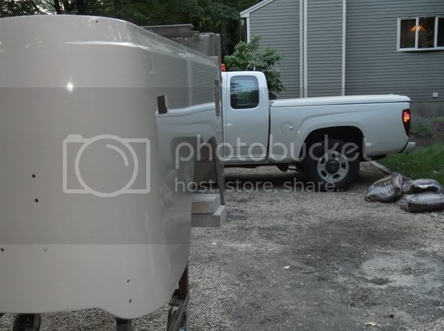

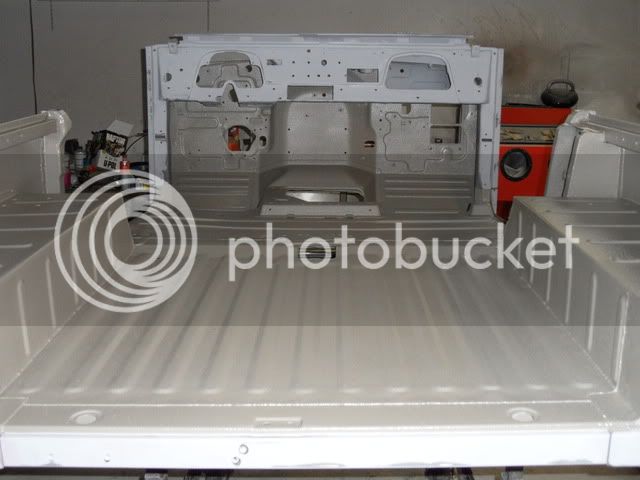

Busy day today. I'm exhausted. Block sanded the outside of the tub, seam sealed everything with SEM 2K seam sealer, and Raptor Lined the interior. Raptor liner came out great but it looks quite a bit lighter than the paint I picked up. I sparayed a test shot of the paint and will recheck in the morning. I hope it matches OK. I should be painting tomorrow.
