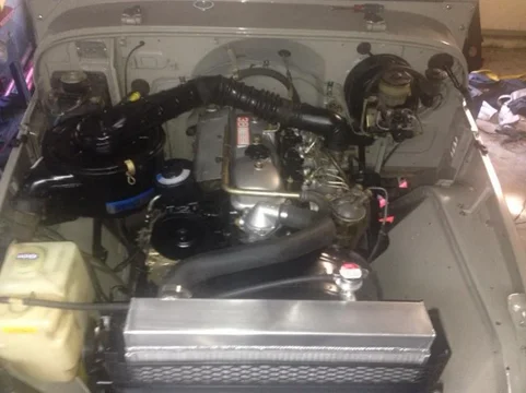

I picked up one of those cheap aluminum radiators and used a Dayco hose that another mud member discovered. I'm impressed with the radiator for the price. All the welds look fantastic and the fit was pretty good. The hose looks a little odd with all those bends, but fits well and will do the trick with the power steering.
Which reminds me; with the PS pump on the right side now, I'm going to have to get a friggin 9' hose made to reach the box. Anybody have a company they recommend? I'm not sure if the local hose place is still in business.

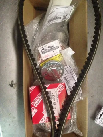

As a matter of fact, I was at the local dealership picking up a few parts as you were writing that:
Some parts are for the 1962 resto.
