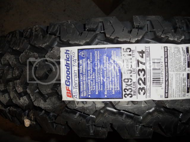

-33x9.5's (picking up a brand new set tomorrow morning from fellow mud member)

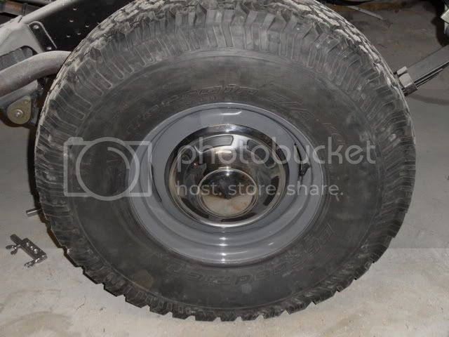

-I hate wagon wheels. Yes, even the "D" window Toyota wheels that came stock on these, so I'm going with the earlier grey hub cap style wheels. The wheels in the photos are just rollers for the resto.

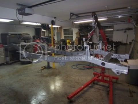

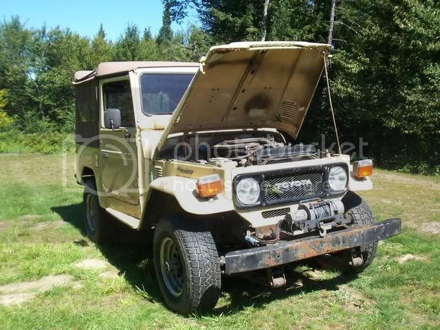

Here's what it looked like when I picked it up in VT:

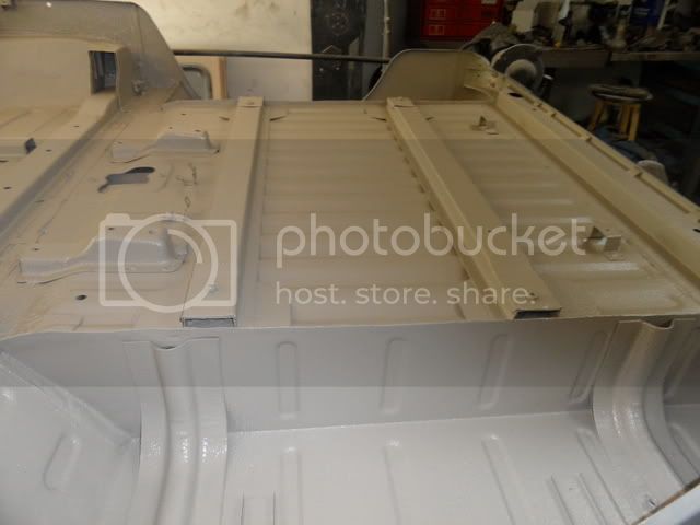

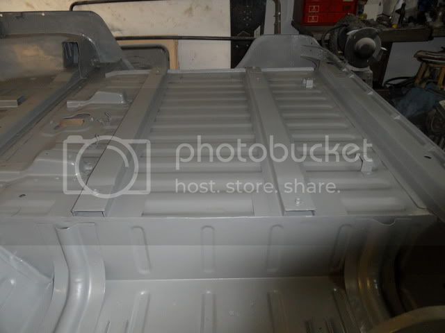

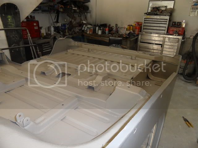

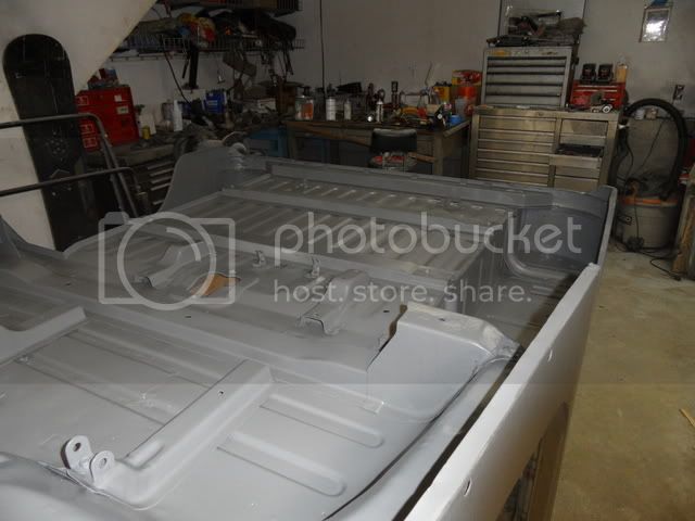

Welded in new rear quarters and rear floor.
PPG Epoxy primer and UPOL Raptor lined (tinted to Dune Beige)the bottom of the tub this past weekend. Should get the top of the floor done this weekend. Planning on painting it next weekend. That's it for now.
At this pace it will never get finished.Could you speed it up a little.Very nice work!:)

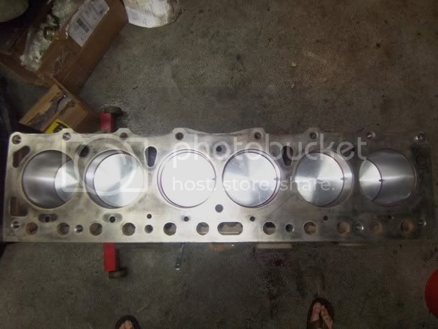

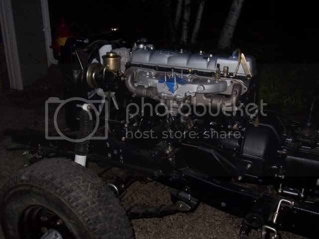

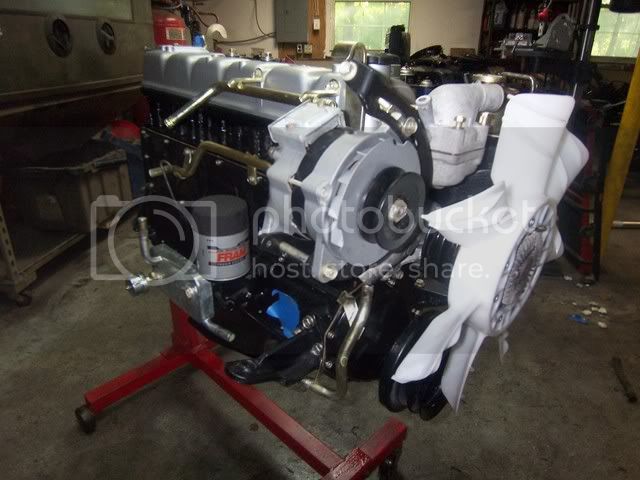

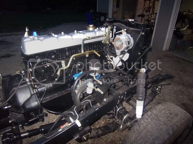

Nice looking work space! That engine looks beautiful man! Keep up the good work...
Well done, looks good.

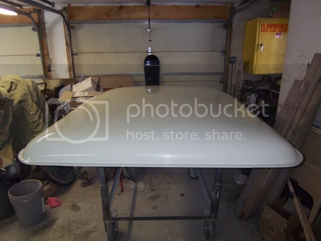

Hard top is looking good, were you able
to salvage much from the one you got from
me?
