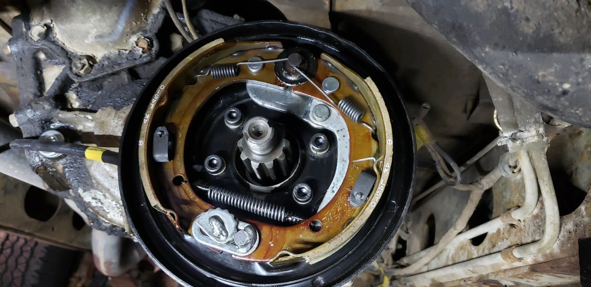

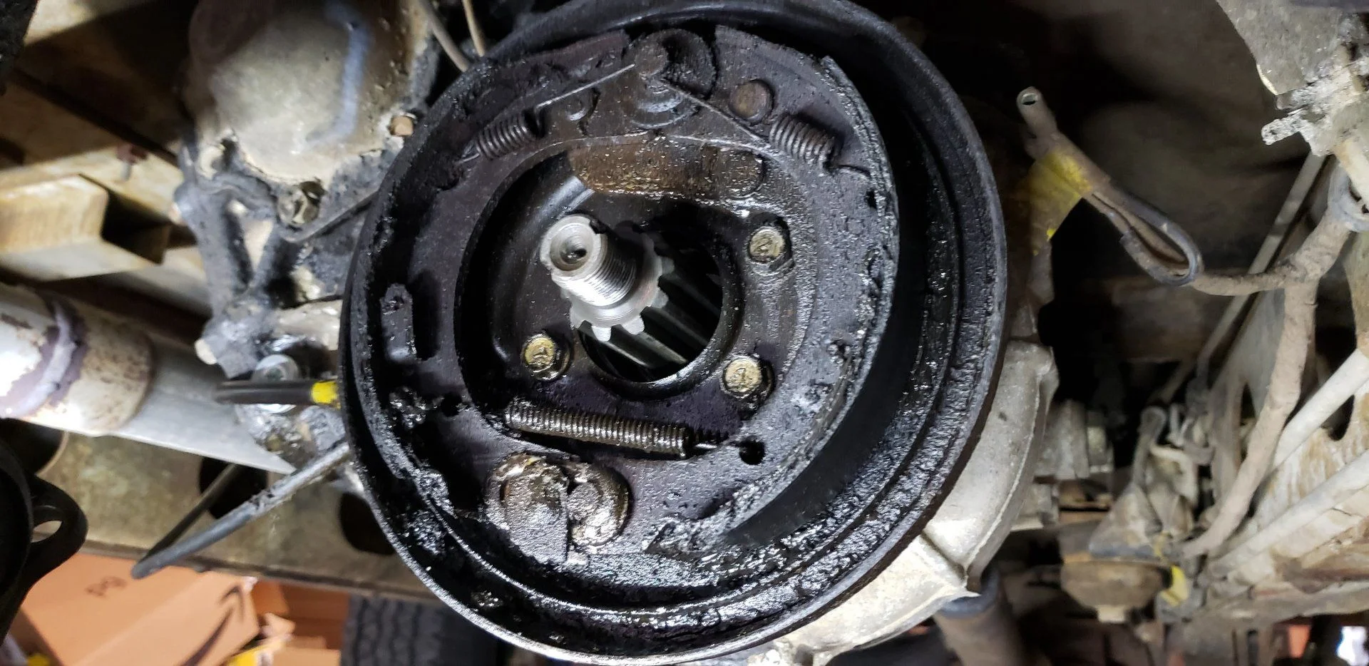

1) Drain T-case. Remove e-brake drum, backing plate, speedo cable, speedo bullet and rear extension housing along with shim(s).
2) Clean gasket surface on t-case. re-install shim and new dual-seal housing. We like to use Loctite "formula 518" gasket sealer on both sides of any transmission or t-case gaskets ( red sealer shown in pics ).
3) Install both new o-rings supplied in the kit. One on the outside of the speedo bullet, the other on the inside. Then slide the speedo bullet back into the rear extension housing. We like to add a small amount of automotive silicone on the outer o-ring to help the speedo bullet slide in place.
4) Our kit also contains 4 allen bolts; one being shorter than the others. These are used to re-attach the e-brake backing plate ( since the factors 12mm hex-bolts are a royal PITA! The shorter allen bolt needs to be installed on the top left or it'll bottom out in the housing. A small drop of loctite on these bolts is a good idea.
5) Replace the ebrake shoes and any hardware if necessary. Clean the e-brake drum really well, then add a small amount of automotive silicone in the splines in the drum before installation. This will seal the splines and keep oil from leaking out of the rear of the drum. Torque the stake nut to 60-65 foot pounds.
6) It's a good idea to wait at least 12 hours before filling the t-case with 80/90WT gear oil to give the silicone a chance to cure. The kit includes 2 new crush washers for the drain and fill plugs.
Some pics below.
