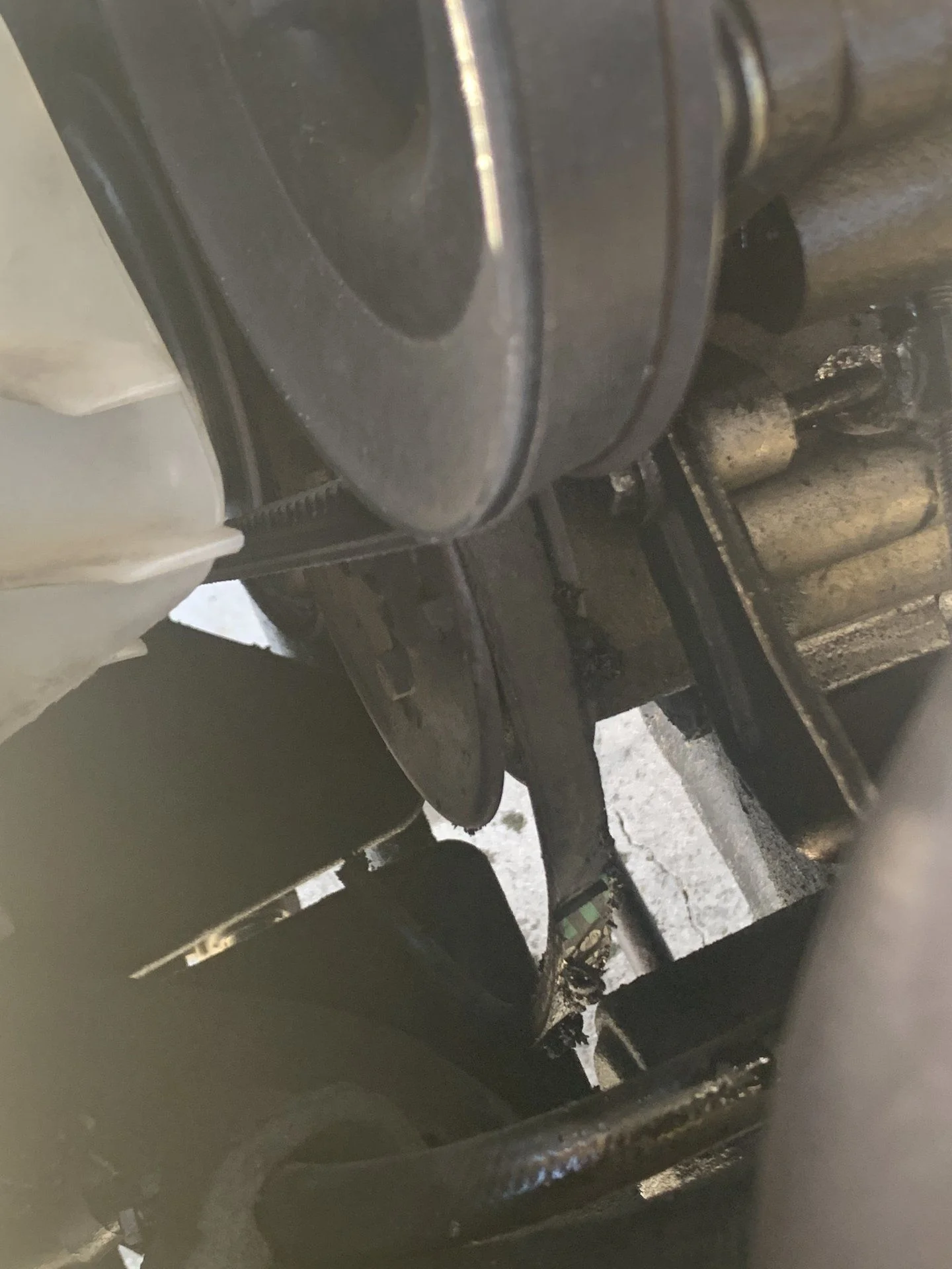

took my 60 for drive to get cake for moms bday
suddenly temp spike
Pull over
All coolant fluid out
Let it cool
See torn belt on bottom
waiting for land cruiser friend to come @RodrigzCrzr
He sent me this thread
Said my air pump seized
@RodrigzCrzr is coming to rescue me now
what a way to start the new year

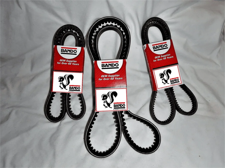

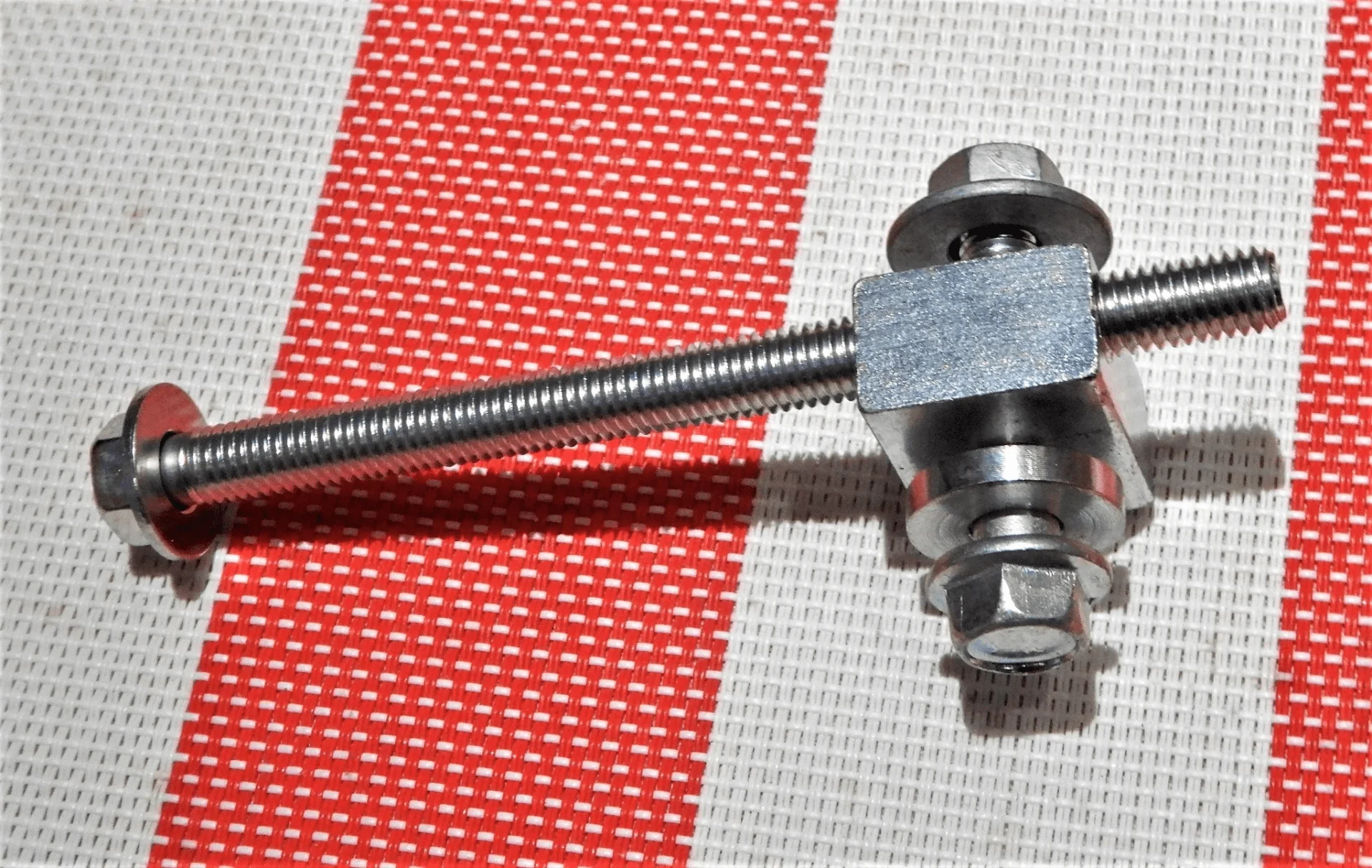

I Can and am willing to OVERNIGHT USPS Priority Mail EXPRESS 24 Hour Shipping ANYTHING that can fit in a Bubble wrap type Envelope
in a Emergency Event Break Down on New Years Day , i WILL Pick UP the Shipping TAB as a MUD-SHIP Team Effort here , Please let @@RodrigzCrzr
Know as well , we know each other well for the MUD-SHIP related to @kevos37 a few years back

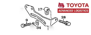

- I can ship OEM Drive Belts
- Belt Tension Hardware Kits
- Smog Pump OEM Mounting Hardware to pivot Bracket to suggest a few
hit me up i will do what i can to assist

So you didn’t hear the squeaking or smell the melting rubber?
@fjc-man i accelerated on onramp - heard a click - friend says that’s when belt tore - didn’t hear the squeak- as temp heated up got off highway
was no melting rubber smell
everything happened it seemed in matter of minute

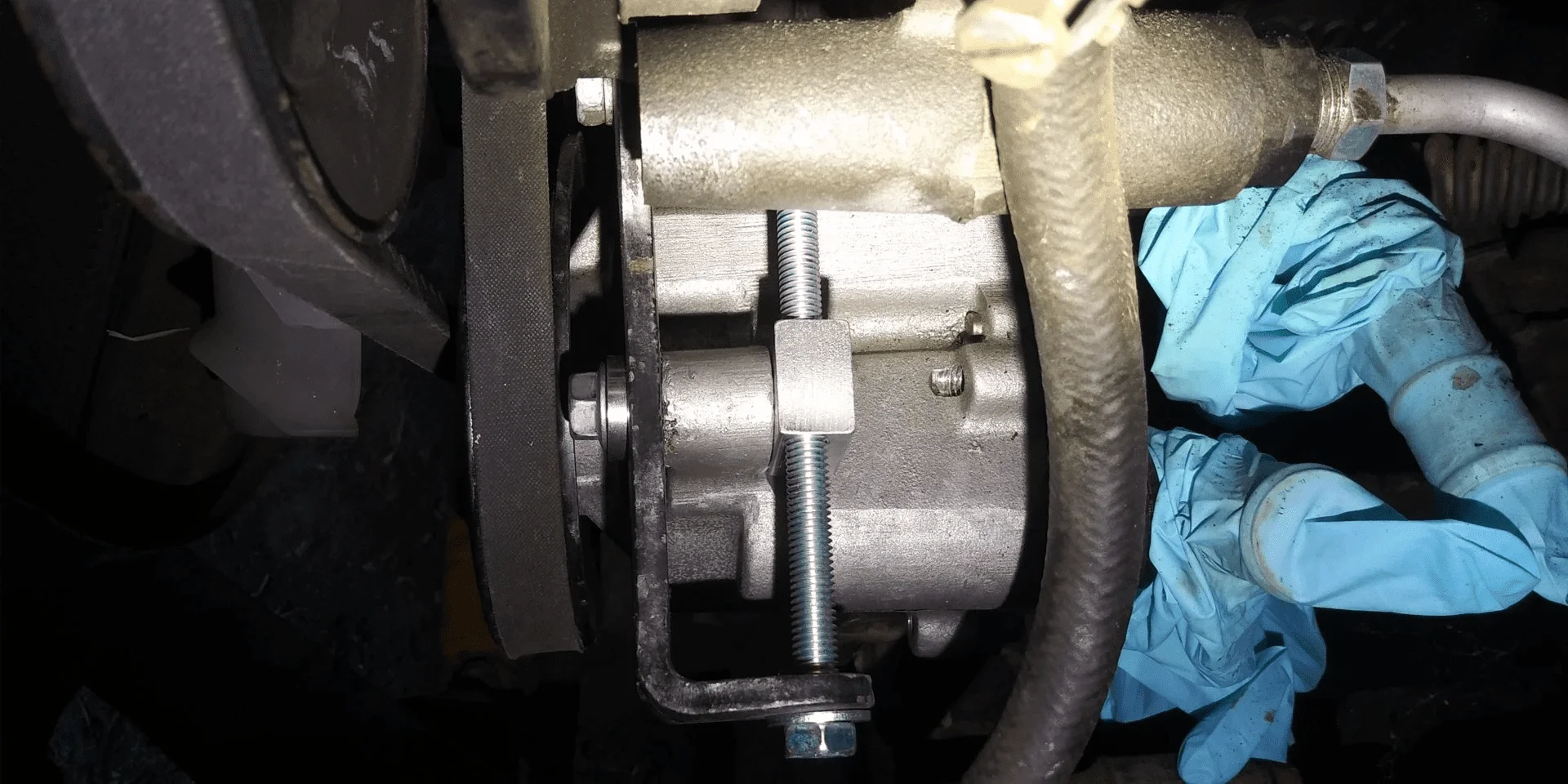

i have a FJ62 Smog pump Spike
will this help in any way ?
