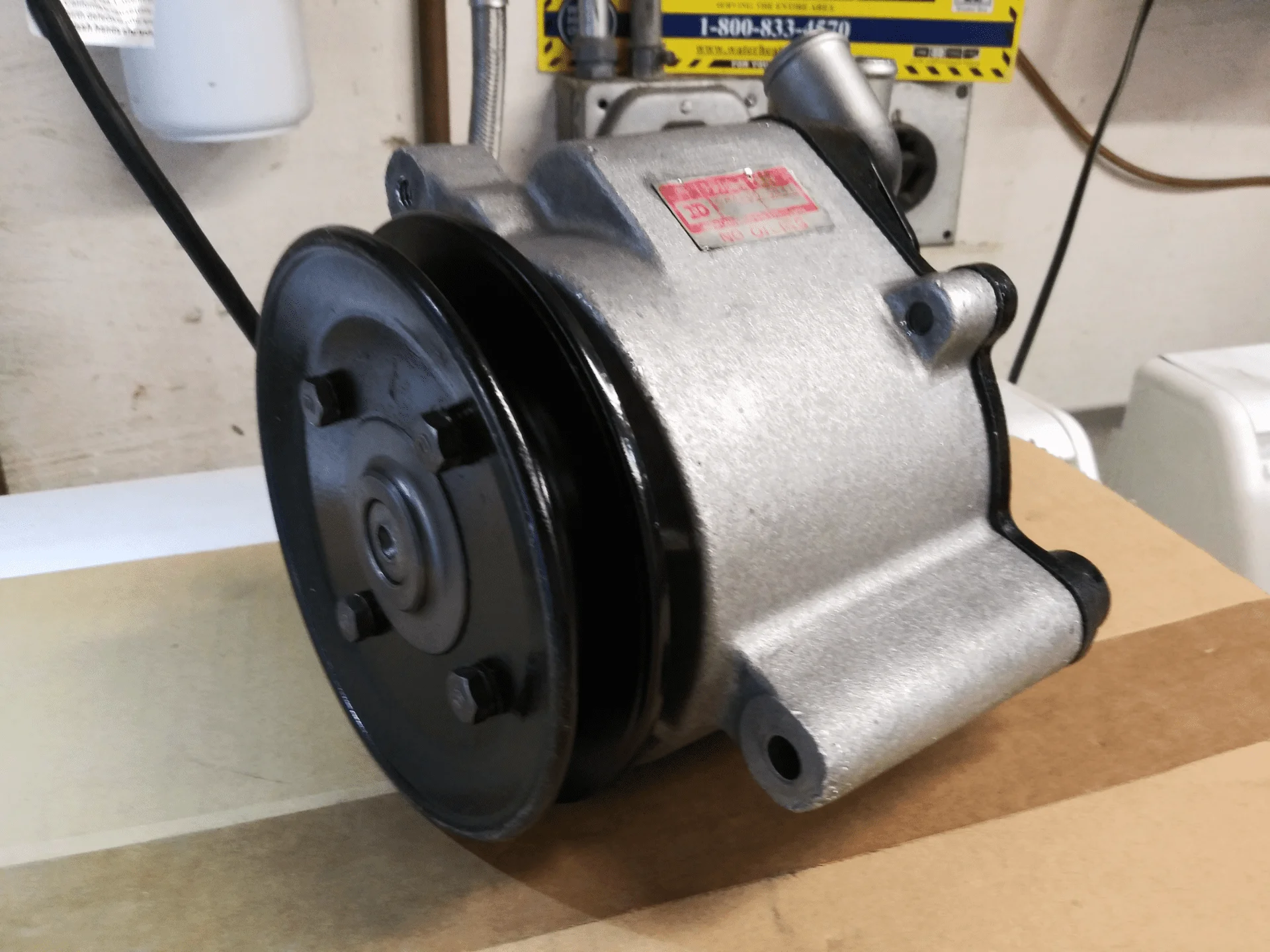

Just for Cruiser Peeps info, this Alternator, Starter, Smog Pump rebuilder in Canoga Park does the rebuilds for SOR. They accept mailed in units.
B-Z Rebuilders | Auto Parts Rebuilt
I've got a smog pump there now, being rebuilt, and will post some pix of the business and finished product when I get it back. Owner says new vanes and Japanese or America bearings.
Will post pix and more info when I get mine back.

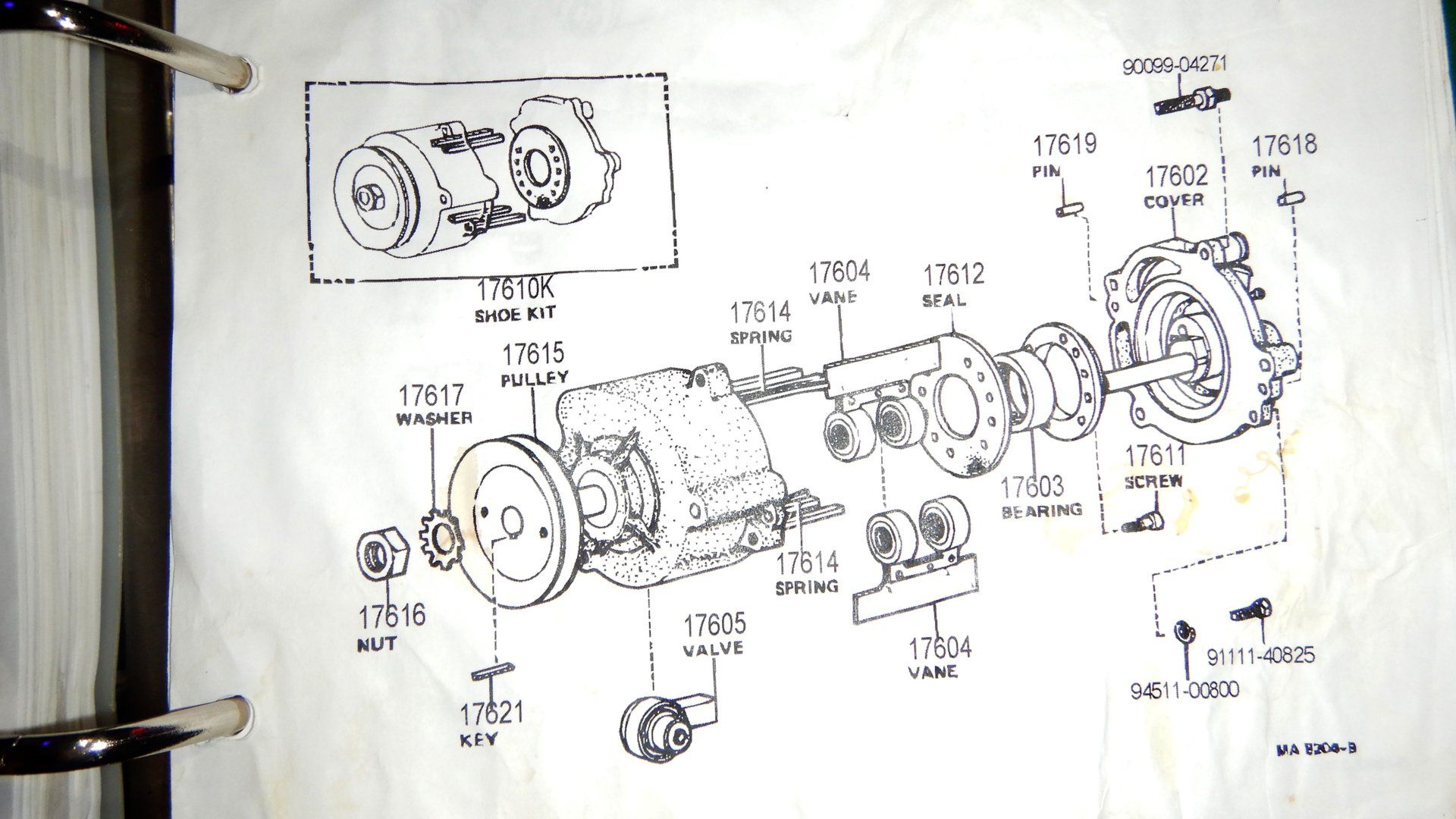

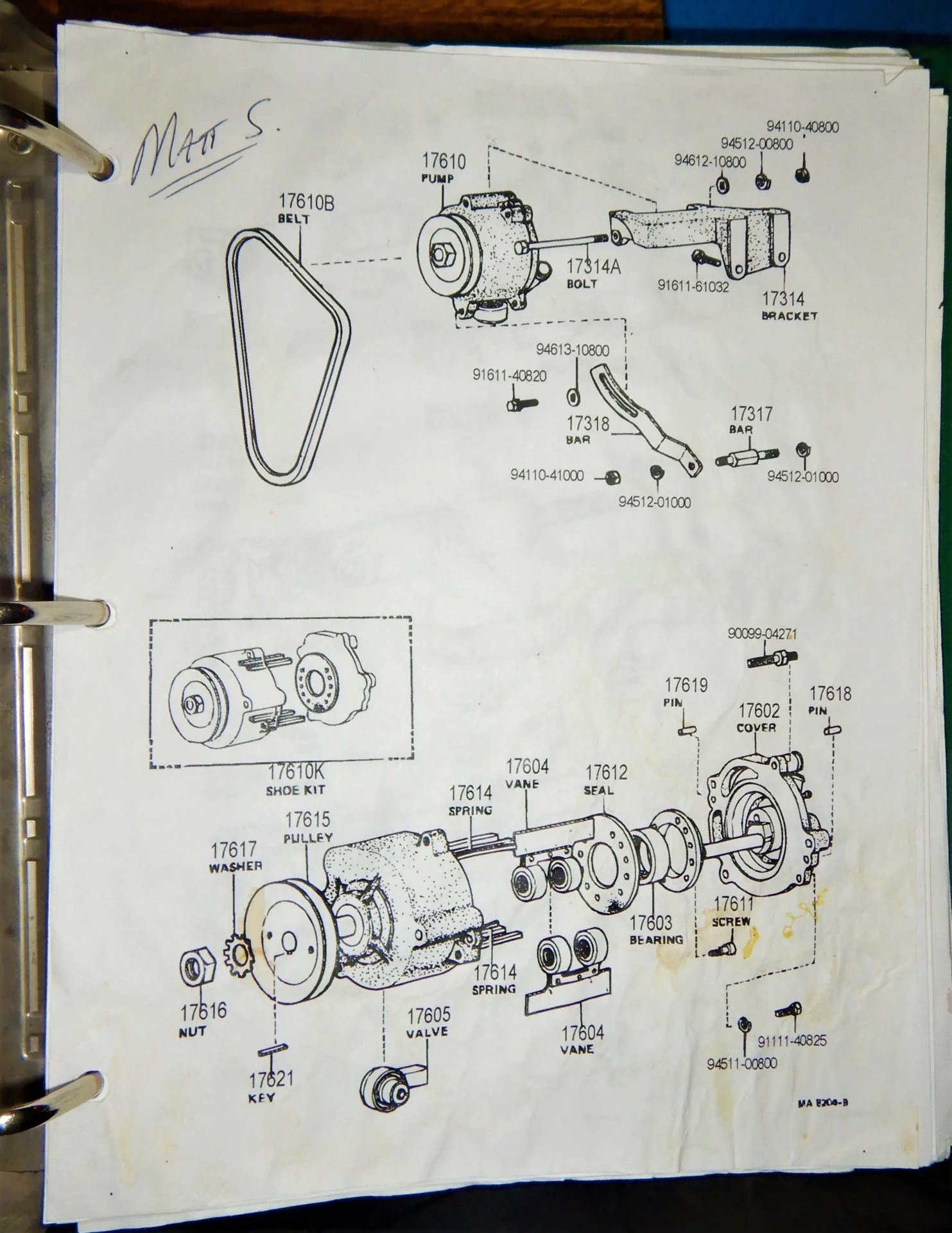

Wow - Matt, thank you! I've never seen an exploded schematic of the Air Pump! Wonder if the parts are same for early vs late 2F (FJ60s) pumps...
that " should " be a diagram for a 1980 FJ40 2F , maybe the same diagram for a leter 2F not sure
i am almost Certain , many parts are shared in some way , especially internals

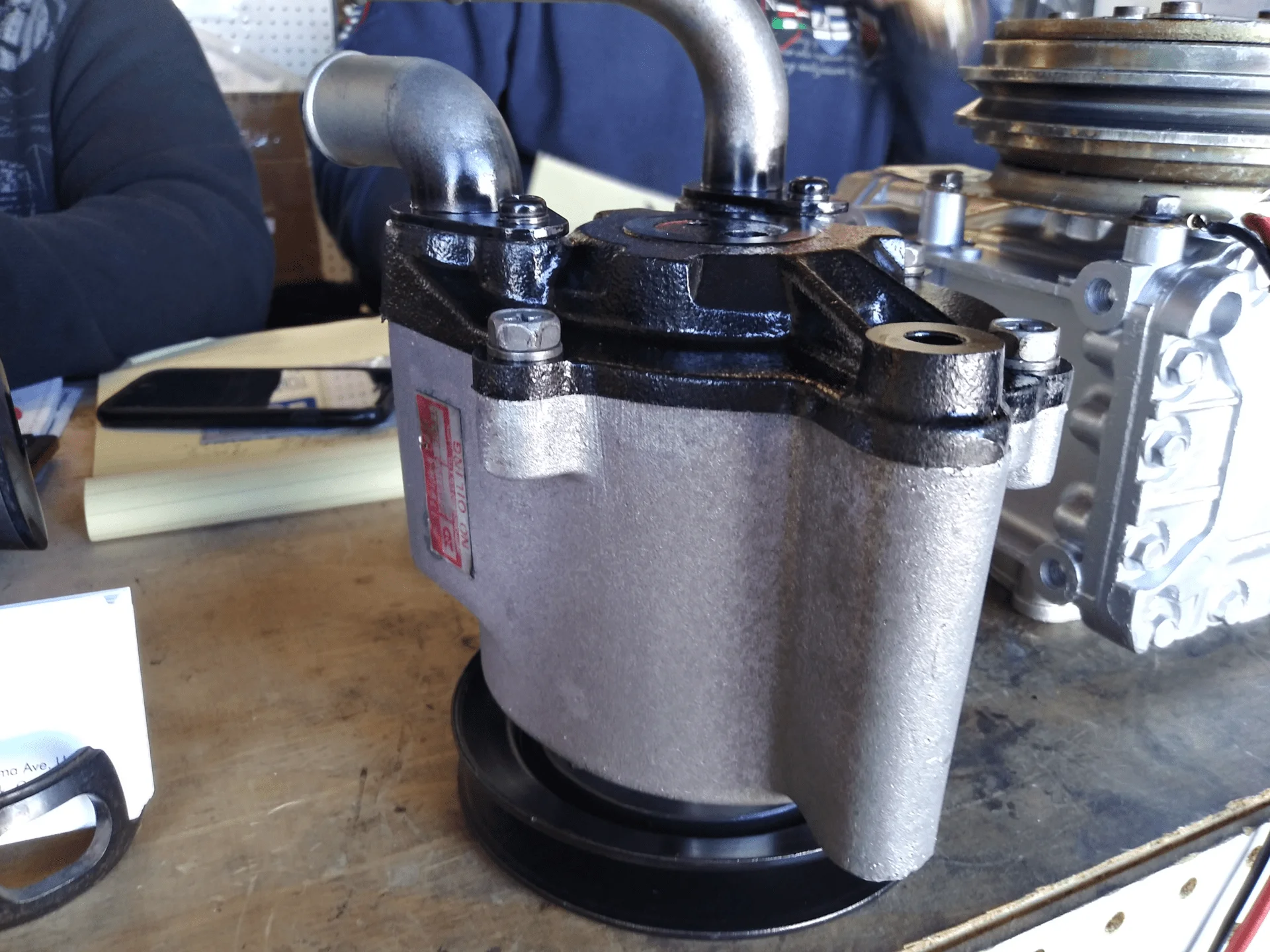

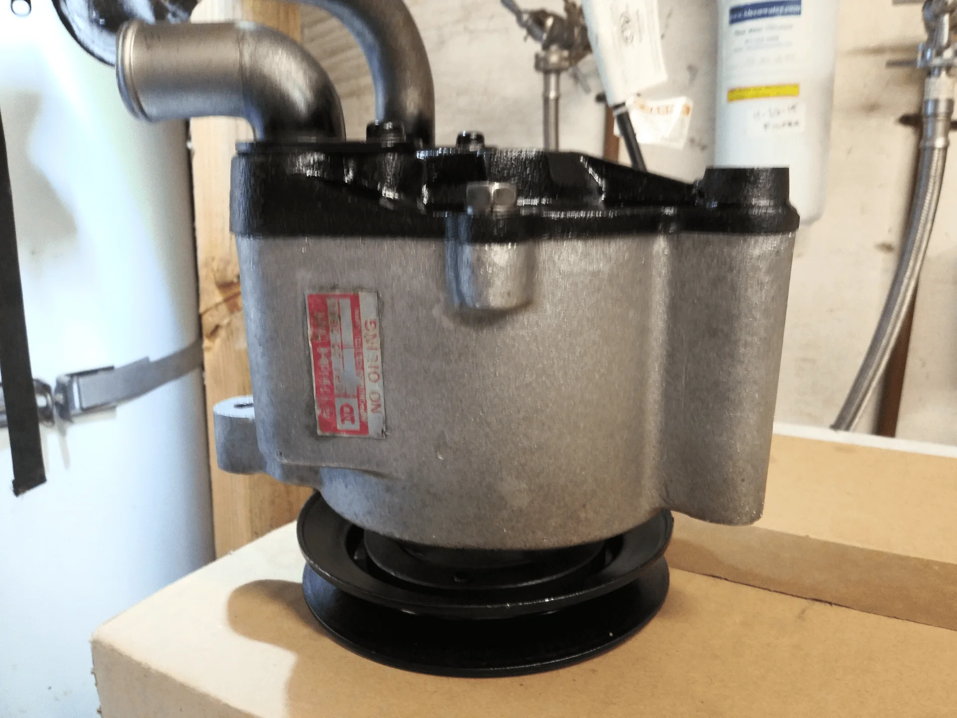

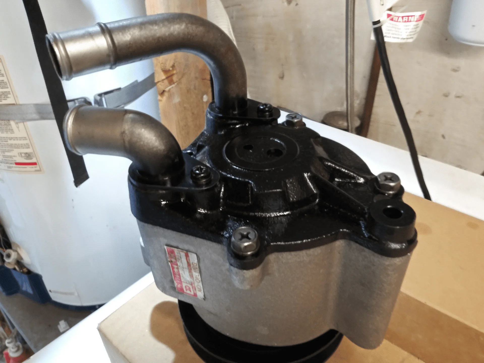

Ok - This place is the REAL DEAL!
I asked them to do exactly what they do for SOR - The body of the SOR pumps are not repainted as they want to keep the OE stickers. They will paint that usual industrial reman gray if you ask.
I have not taken it apart, but it definitely feels like new vanes - Many years ago, I got my hands on a NOS unit at SOR and I was surprised at how stiff if turned- I was told when the vanes are new, it's a tight fit so the air output is high. This unit feels JUST LIKE THAT.
Even better, $195 - Same as they charge SOR. About $50 cheaper than Rebuilding Factory.
This place also does Steering Gear Boxes and of course Alts, and Starters.

I like that fact they Leave the OEM Foil Decals , that's a attn. to Period correct Factory Focus Point detail unheard
of on the east coast
if i were to say : they first covered the original Foil Decal up with Delicate release Body shop tape , then
Media Blasted or SODA blasted the main body , then removed the delicate release tape , then proceeded with the
rebuild would i be right or wrong ?
How long did it take? Tempted to send my currently functioning unit (just jinxed it) in to be rebuilt for my sanity.
Literally overnight. I dropped it off yesterday afternoon, and picked it up today around 1pm and even had time to stop on the way home and pick up empinadas!
