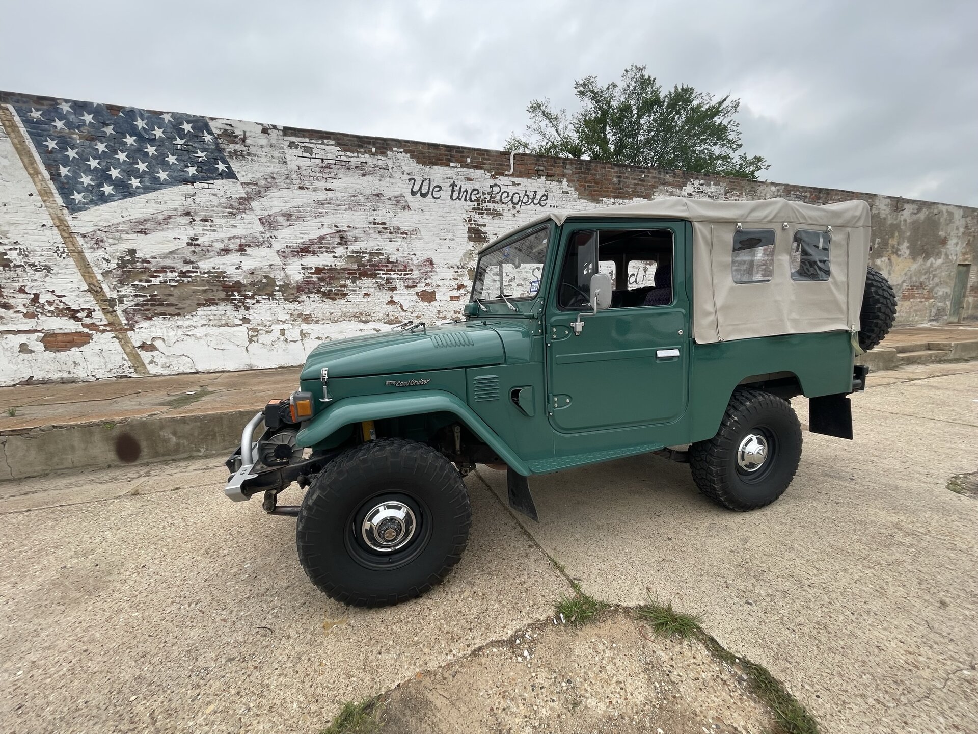

I got lucky and found a top of unknown make on FB marketplace and got bows from Real Steel. Be forewarned that if you have "regular" hard top doors you will have to modify the Real Steel B-pillars to work.

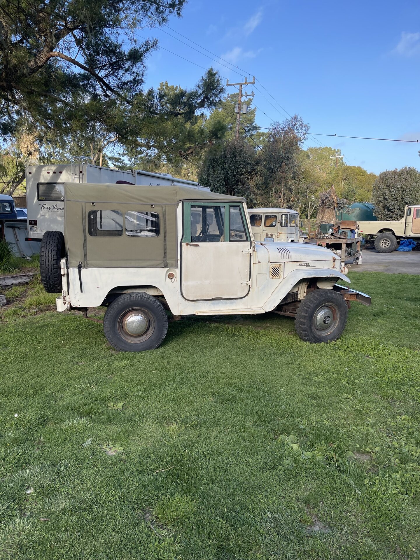

I have read this about the hardtop doors. I am a little worried as I do have early style doors that are different than most on the window frame part. (earlier bug catcher style uppers) Ill post a picture of the doors later. However the soft top door pillars look similar to the part on the hard top I have.

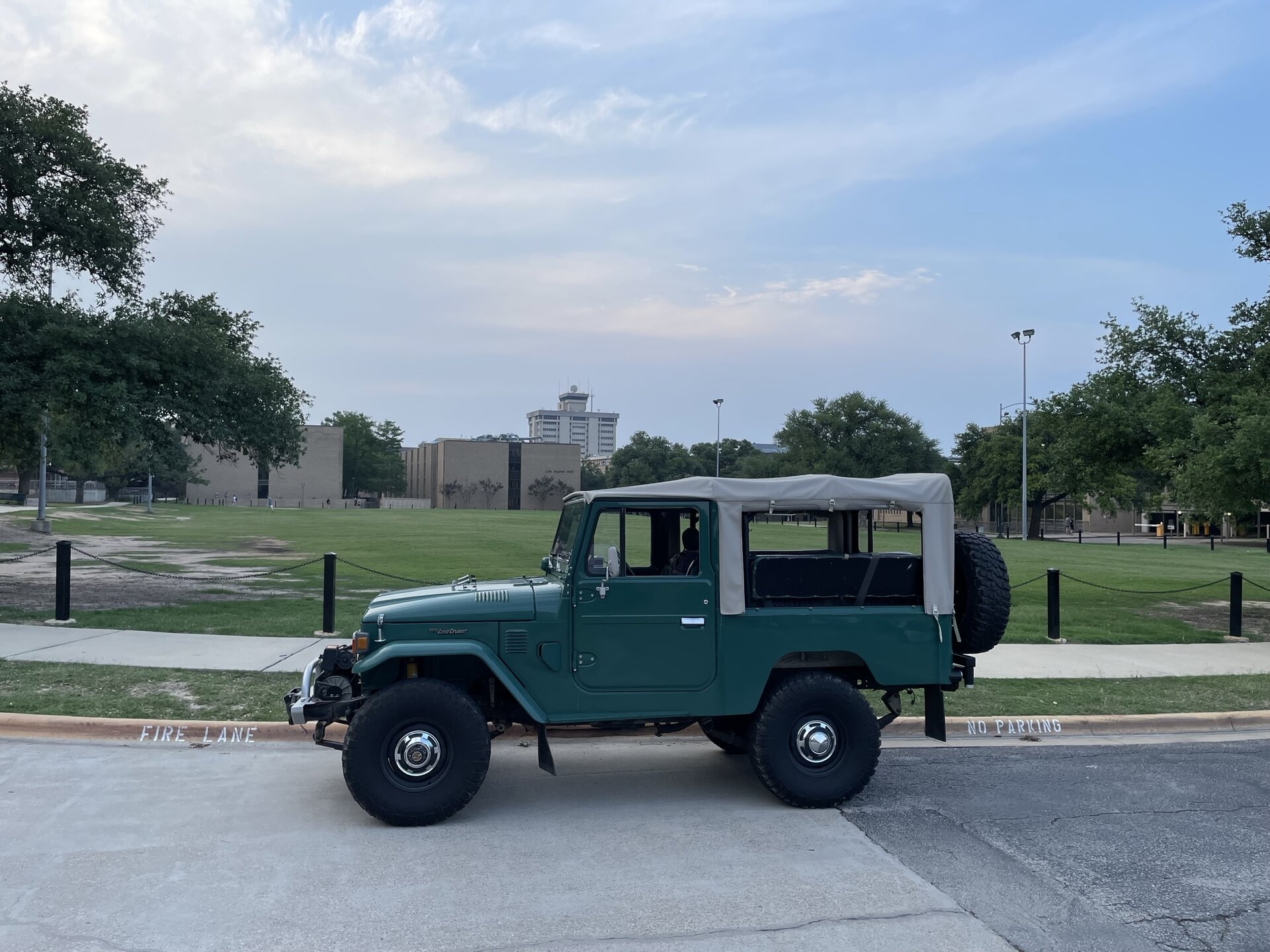

The doors fit fine to the b-pillar. I don't get a good seal on the door bows because it's not built quite the same as an OEM bow would've been. My other observation is that the 1" straps and d-rings are not great on the TROA top. The straps are not very rigid and the shorter lenght allows them to back off as you're driving leaving a window to flap in the wind. The top did arrive quickly and it's pretty good. There aren't many options for a 43 anyway.
