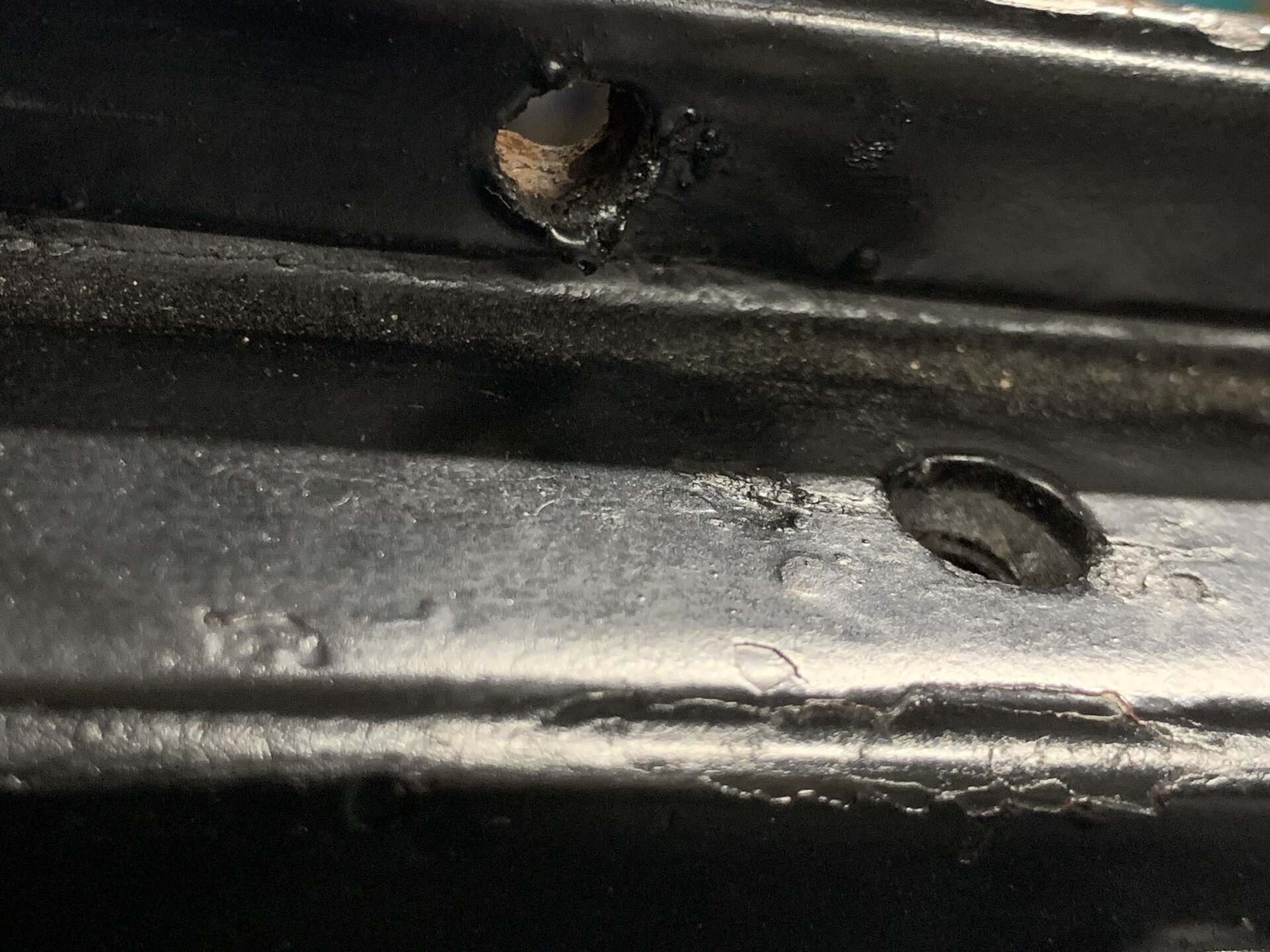

good to know! I have always wondered if mine had a soft top on it at some point or if Mr toyota drilled the holes for a soft top for all of the 40s already weather it got a hard top or soft. I have noticed holes on the windshield frame for the the channel and holes in the tub for them. The tub ones look threaded.
Mind posting photos of the threaded holes in your tub?
I will after work I am planning on working on my rear jump seat upholstery so I will be right there. they look factory for sure.

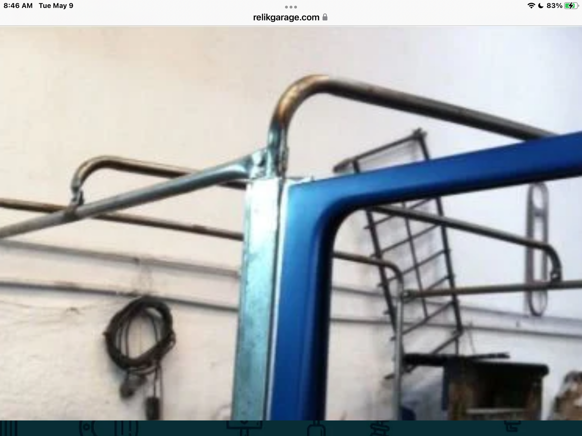

Rather than welding into place I think I will use a couple of these to allow for adjustability.
Thats a better Idea!

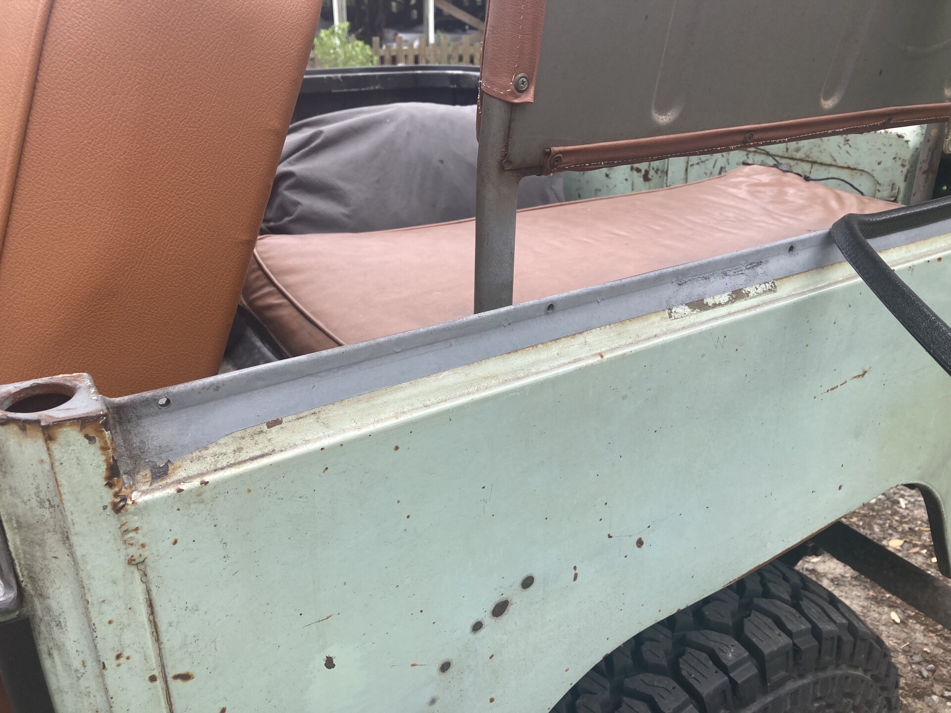

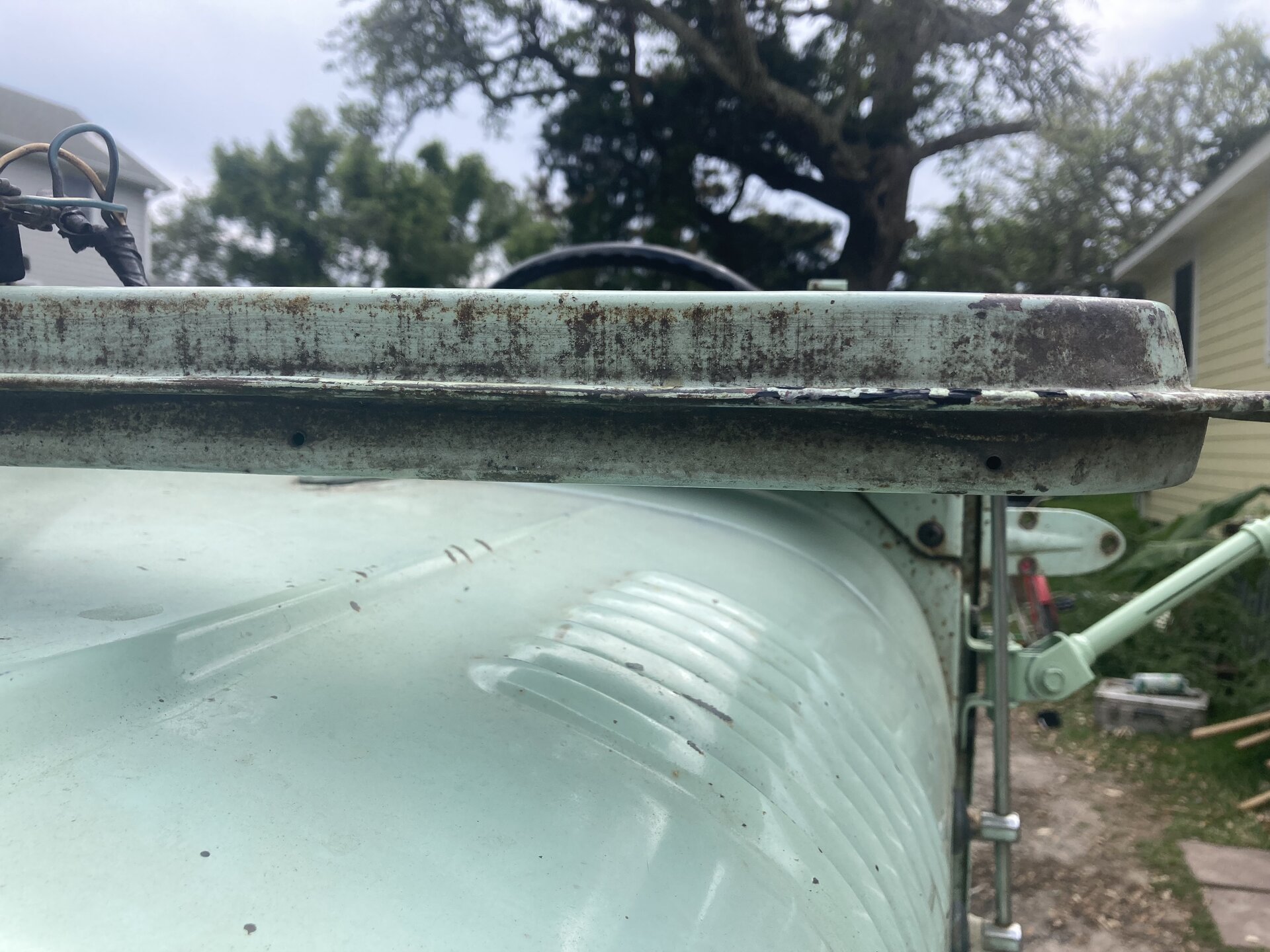

here are the photos. Pardon the zinc spray I did to keep it rusting while I have the top off. You can see in the second photo little holes drilled on top of the windshield for I think the little channel for a soft top. I could be completely wrong but I assume its for a soft top.

Mine (Jan 73) has the same holes on the tub’s rail, but the locations are a little different. IE: the first hole is 3” from the B-pillar
I also have assumed mine were drilled by a PO because some look like this on the backside:
While others could pass for factory:
No, the holes stop where the footman loops begin
