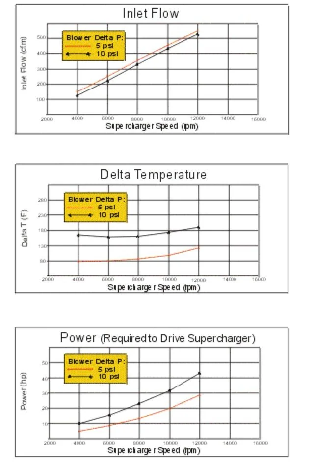

Well the TRD system is really maxing once you start spinning it faster. The M90 was somewhat designed to go on the 3.8L Pontiac, Buicks and Olds with their L67 engine.
The third gen M90 at maximum rotor speed is rated to about 500cfm. You convert that to lbs/min and it is only ~34-35lbs/min, then subtract the 42hp to spin the SC at 12,000 rpms to make that volume and you will see less than 310 crank hp. or roughly 205hp at the wheels.
