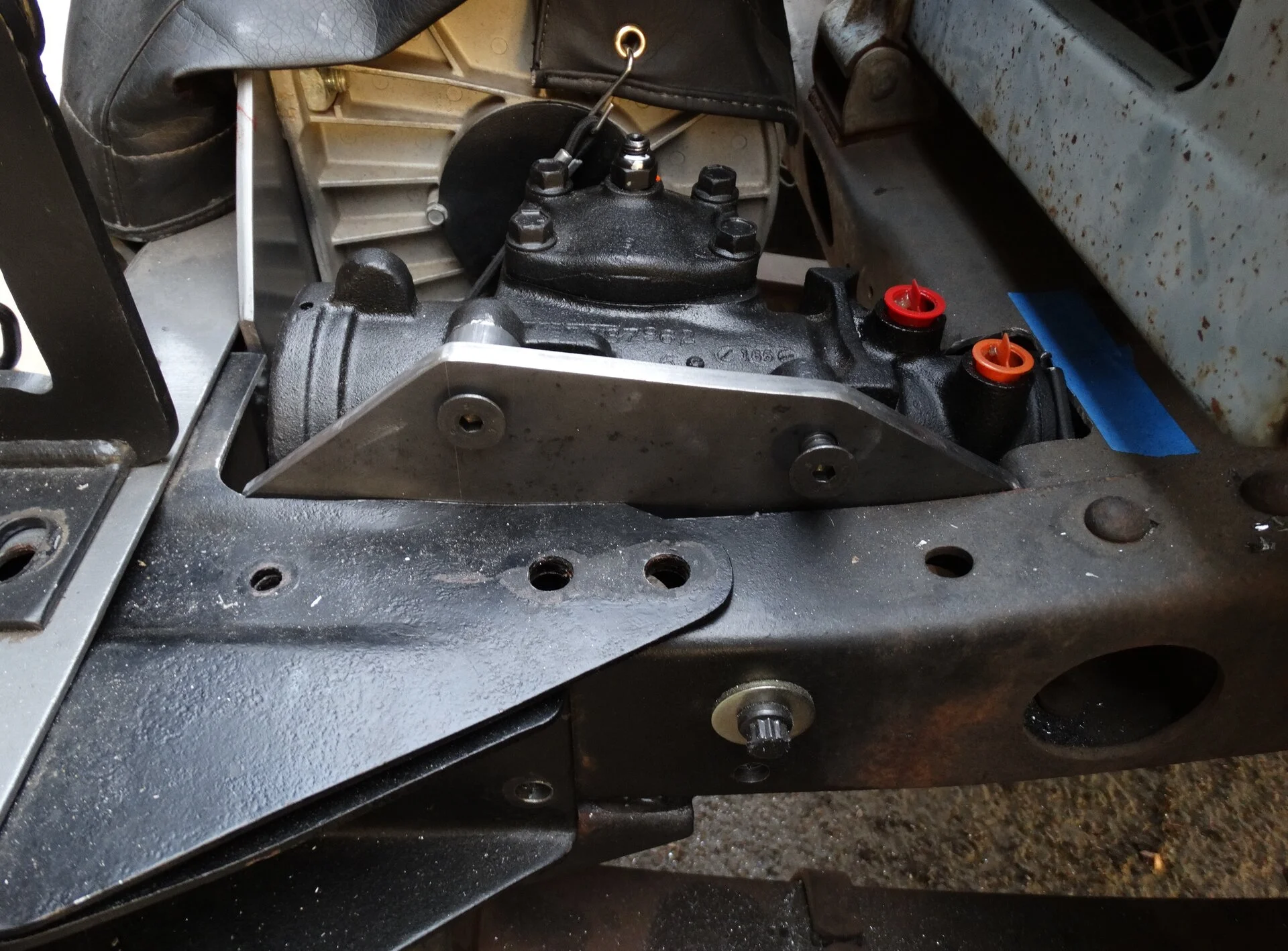

Don't remove the braces, trim them instead.
Drill a hole at the corner and then trim/cut up to it. You want a rounded corner to prevent stress cracks from forming. Don't cut the frame or bumper.
Here is how I trimmed mine for my power steering.
I like this solution. I have a cutting wheel but doubt I can get it to look like yours. What did you cut it with?
When I do my winch mount, I going to use a receiver hitch so I can move it to the rear. Yes I'll run heavy duty wire back there too. I think there are good quick connectors that will work as jumper cable connections too.
You can use a hole saw to radius the corner and whatever on the straight cuts, death wheel, Sawzall, etc.
